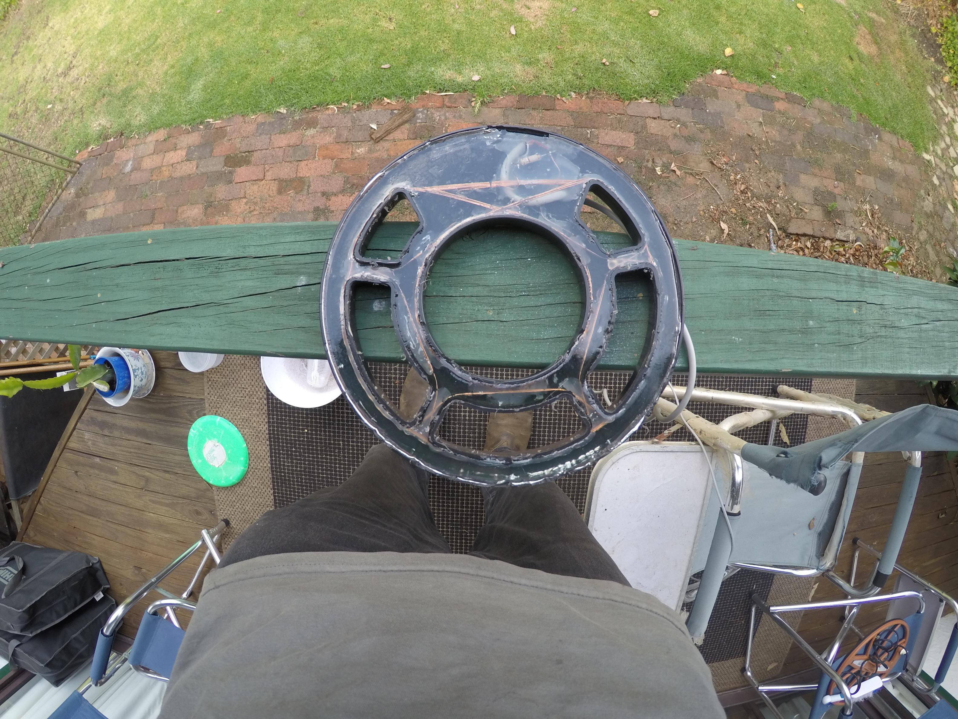

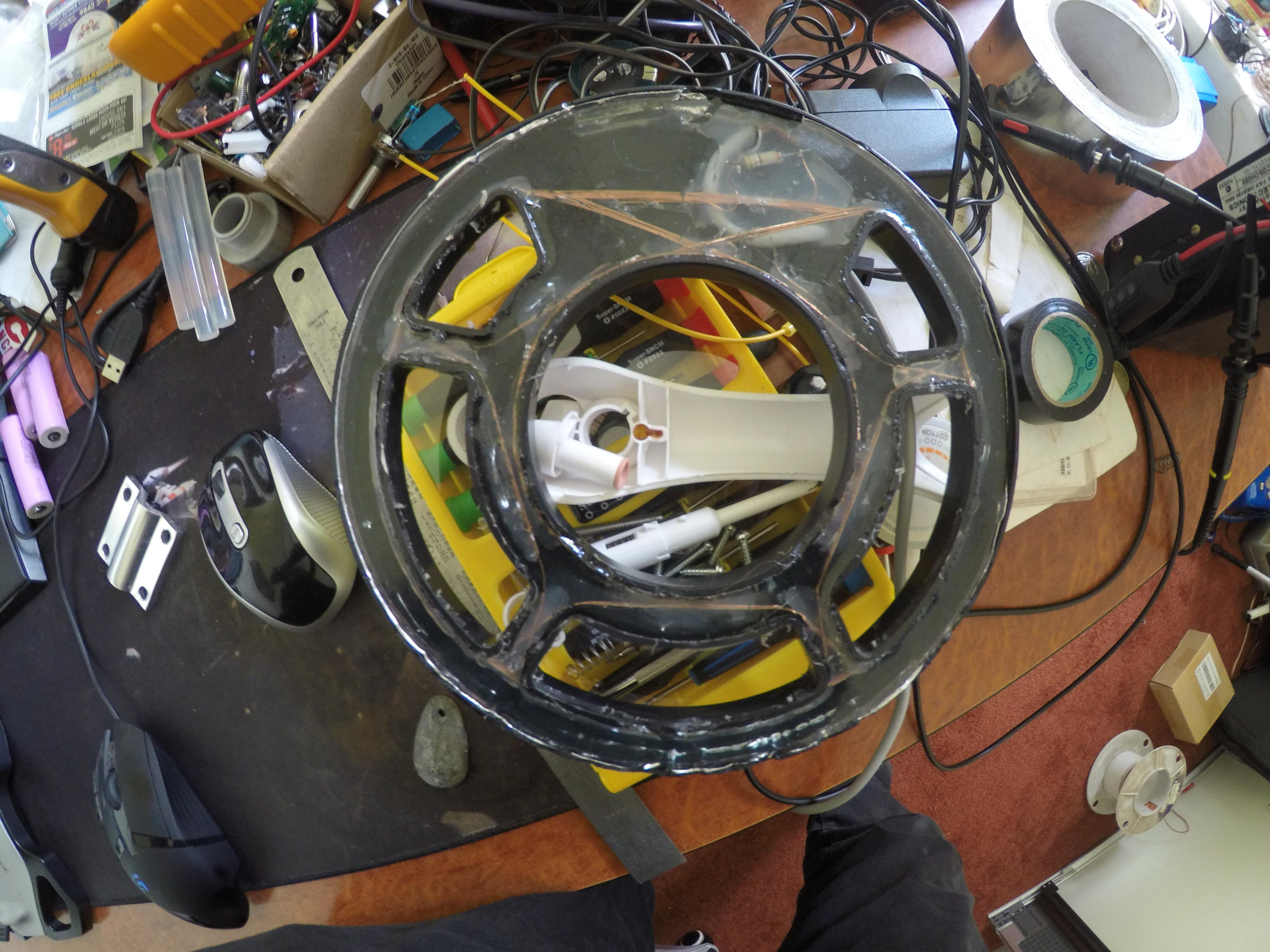

        It started out with two strands of .236mm enamelled wire 19meters in length and after wind is come out at 356uh, then added cable witch brought it up to 540uh 2 ohms, for shielding I use some type of sticky ally foil that found at local tip shop only on the edge of coil housing, some quick scope work and fitted a 550ohm resister in for damping and tested it on led sinkers, getting a good hit @12inches with bean sinker which for some reason is the hardest shape sinker to get a nice clean sig, and the spoon sinker best I can get is 17inches as in air test, and 9crt mens ring @ 9 inches good sig after that sig gets iffy.
        So I filled it with model resin and to my surprise that inductance had risen a fair bit to 651uh and 825.1pf and still 2ohms and resonance frequency @541991hz if I got that measurement right.
        with reasoned filled coil now hard as I have basically lost 2inches of depth on all my test targets and still no EMF effect with the swing of the coil, so on with next project and that's to make my own litz wire and build another coil with only edge shielding.
        This barra is getting a good work out on different coils and has not let me down
          Sounds like the resin changed the dielectric considerably which increase the inter-winding capacitance thus slowing the coil's decay.
