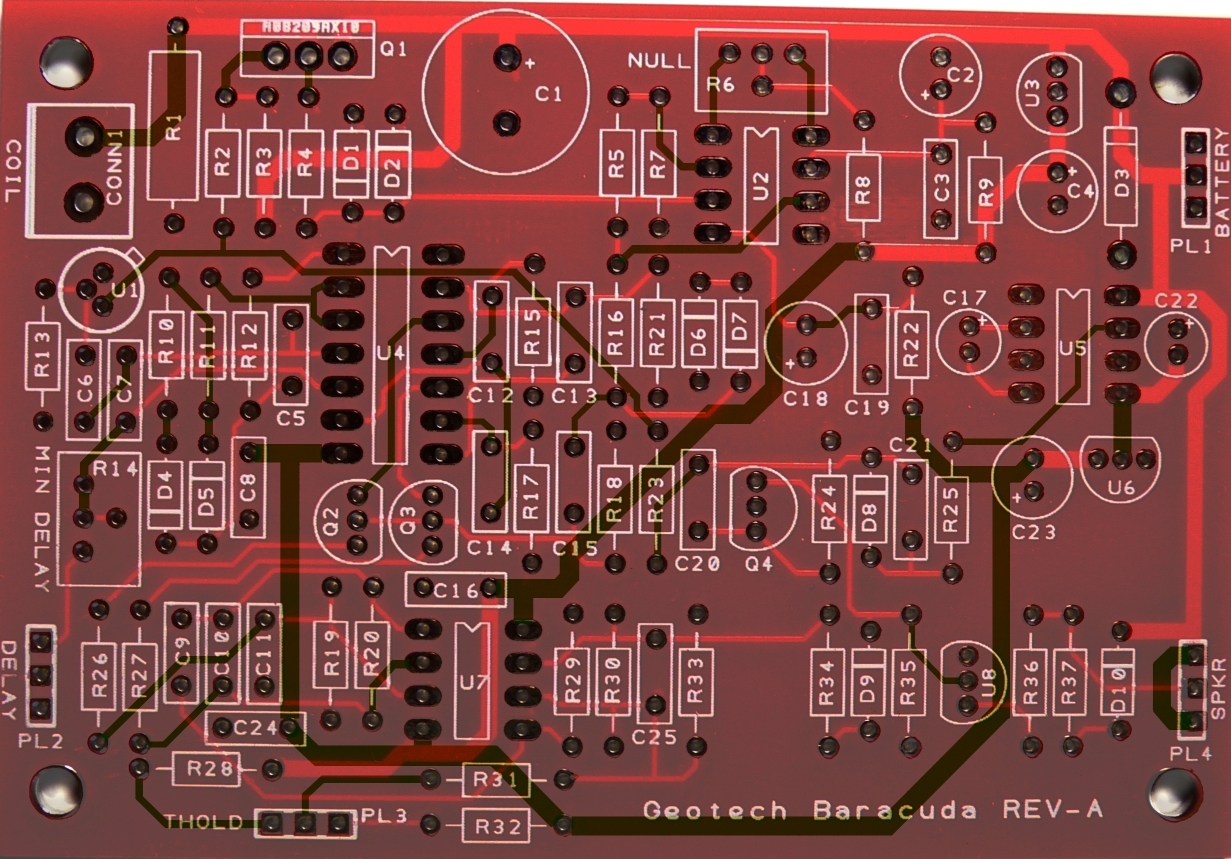

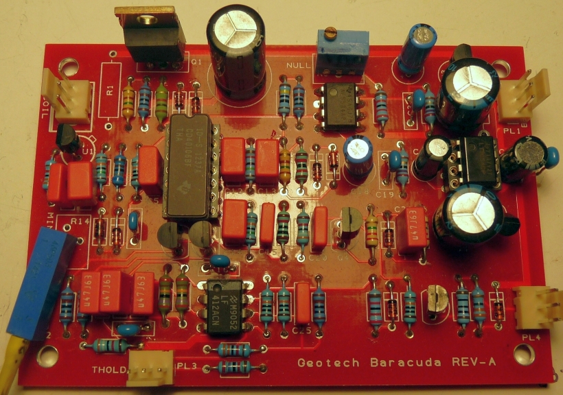

    Put together my first Geotec Baracuda after having built
    two of the old ones. I especially like that the resistors are
    are all horizontal and the holes are big enough for leads
    to go in easily. Thanks George!
    This one worked straight off the bat!
    I tested it from 6v (56mA) to 15v (107mA) and it works just fine.
    So now I can play around with coils and figure 8's.

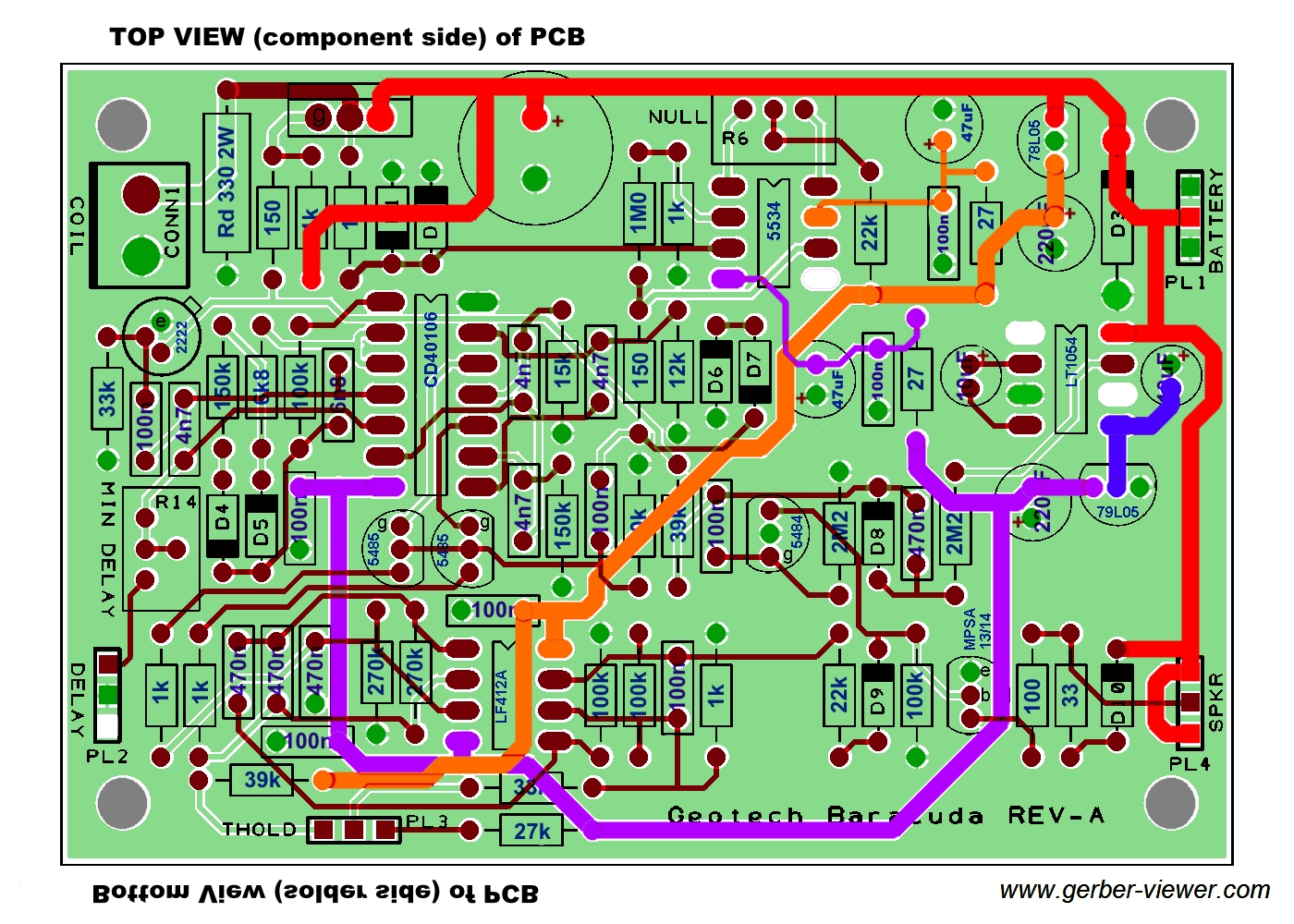

    For what its worth here my xray and power trace version of the PCB
    which helps me put stuff together and makes measuring things easier.
