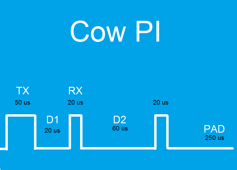

        I think to start we'll use a fixed screen and just update the changing value;
        The cursor will move between the various numbers and allow changing them. The rest of the screen will remain fixed. Later we can get more creative.

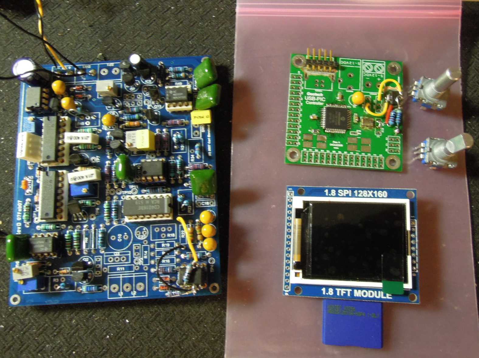

                            Well after a brief sojourn I'm back on this project. I got my Hammer Head mostly built up and tested the power supply and clocks.
                            The plan is to make it work as a Hammer Head then modify it to use the 18F4550 board for control. I'm forming an idea to use the
                            4550 as the interface chip and add some DSP's to get some fast samples. I also got the rotary encoders and the display and SD card.
                            I still need to mod the 4550 board to add the in circuit programming connections. The pins are tiny so I need a new tip for my iron
                            to do that. I do a lot of soldering at my new job so maybe I can bring it to work and pop those 5 wires on...
                            I also picked up a Chance PI board and I'm trying to disassemble the code for that project to do a little tweaking. That's going to
                            take some time though so don't hold your breath.

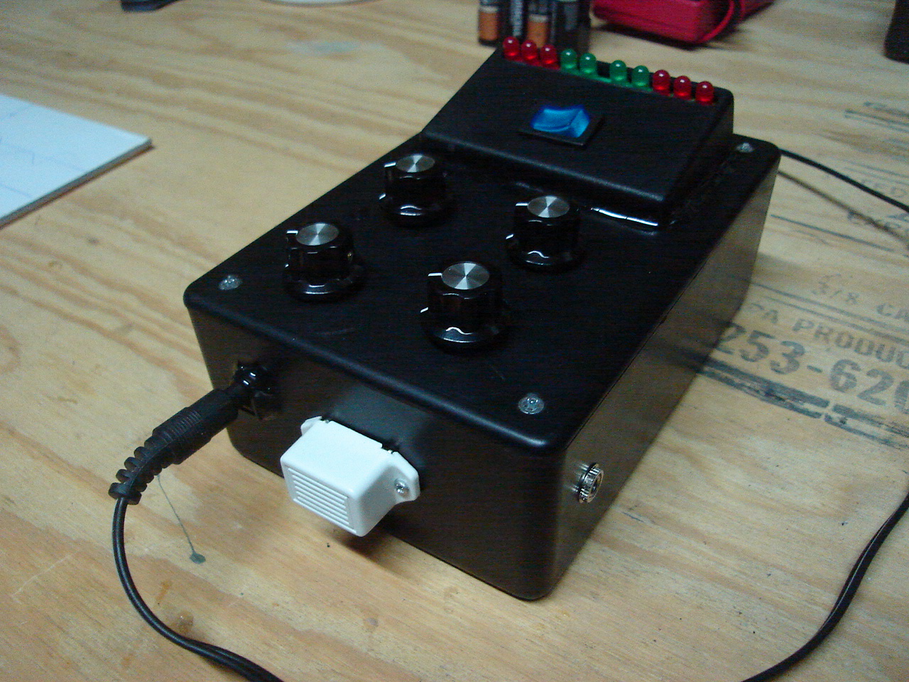

                            The attached picture is the project so far. I hope to get it all soldered together and start programming some code into it soon!

                              have a Low Range/ High Range switch. That would leave Threshold and Main Delay.
                              We could have auto adjusting RX widths too.
                              Threshold would be like sensitivity and main delay would be for adjusting what size
                              target you are looking for. I wonder how we could add more info to the audio output?
                              I was reading a patent last night and they used a 60 us TX width and 600 hz rate.
                              And 30 us wide RX's 150 us apart and the main delay started at the flyback decay
                              and could be adjusted 100 us out.
                              So we could use these numbers to start with. Maybe 50 / 100 us ranges for TX width
                              and 10 / 30 us for RX widths (depending on range).
                              So our front panel controls will be a High/Low Range switch and a Threshold pot connected
                              to R31 on the Hammerhead board, and a rotary encoder to adjust main delay and a power
                              switch. Even simpler would be to use the push switch on the encoder to change ranges with
                              a LED to indicate current range.
