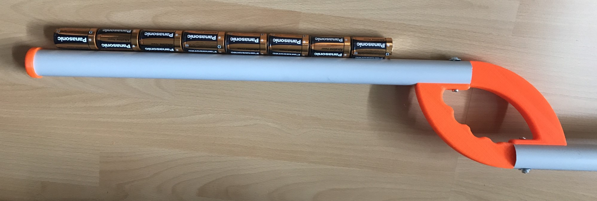

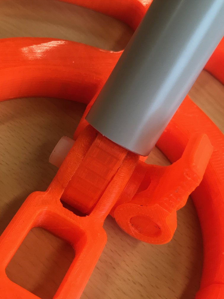

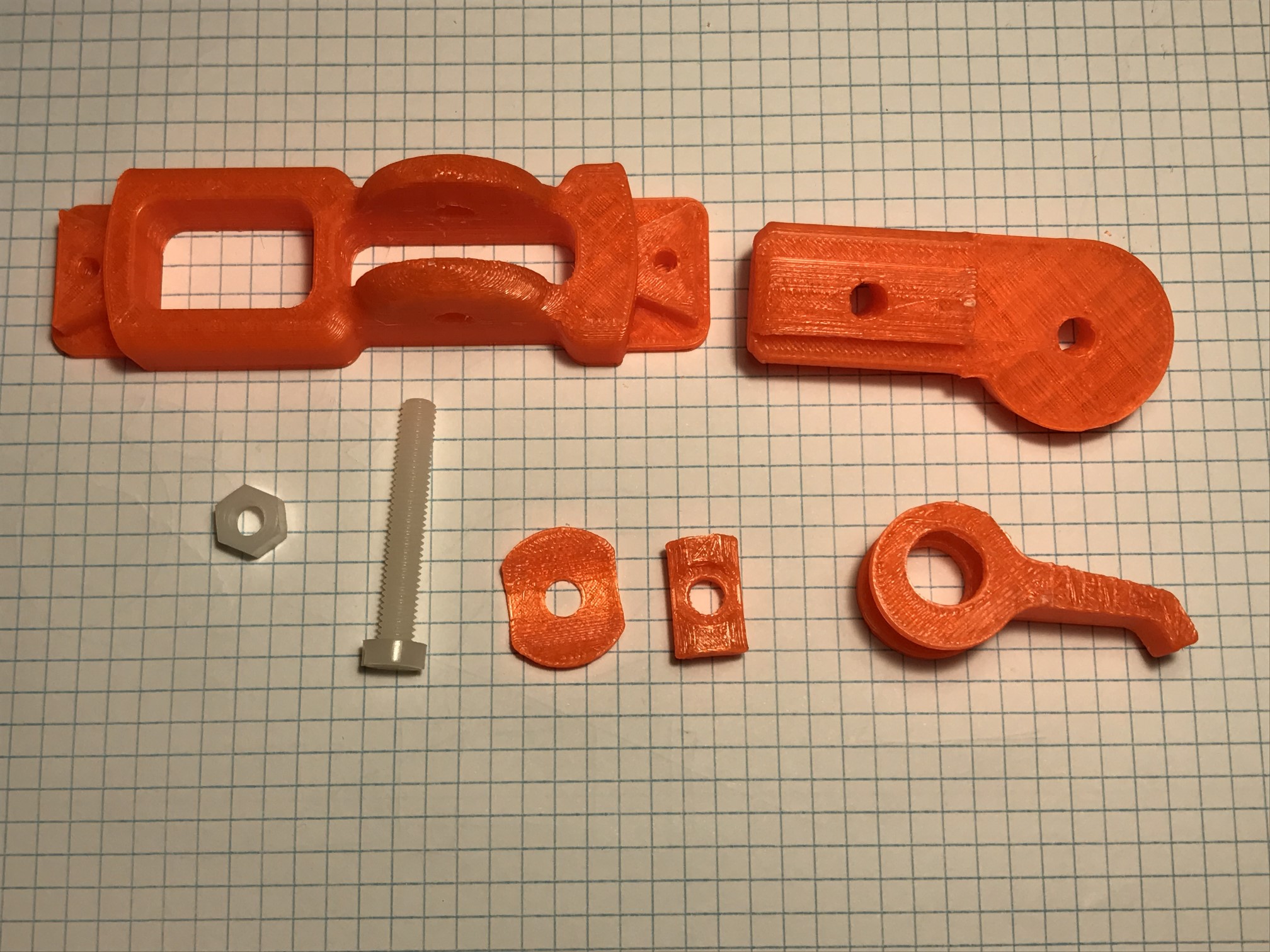

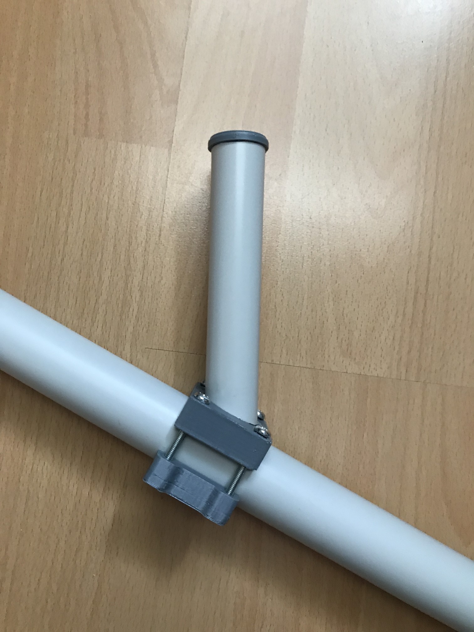

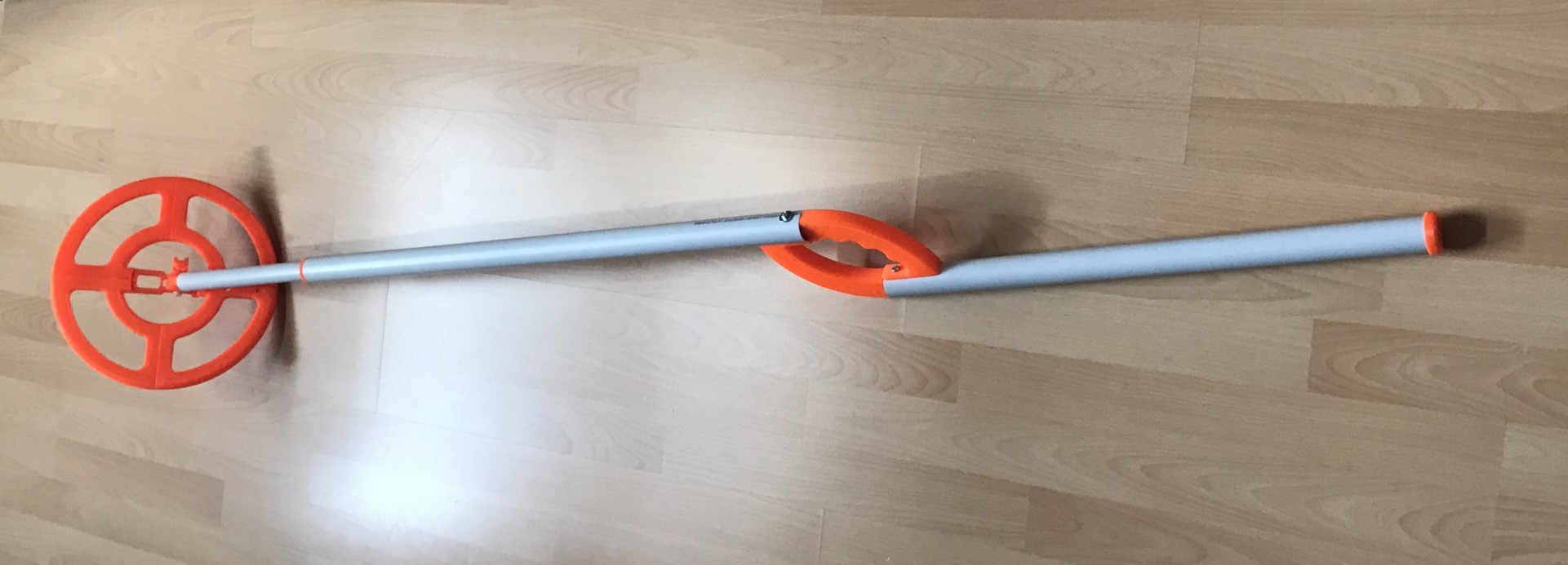

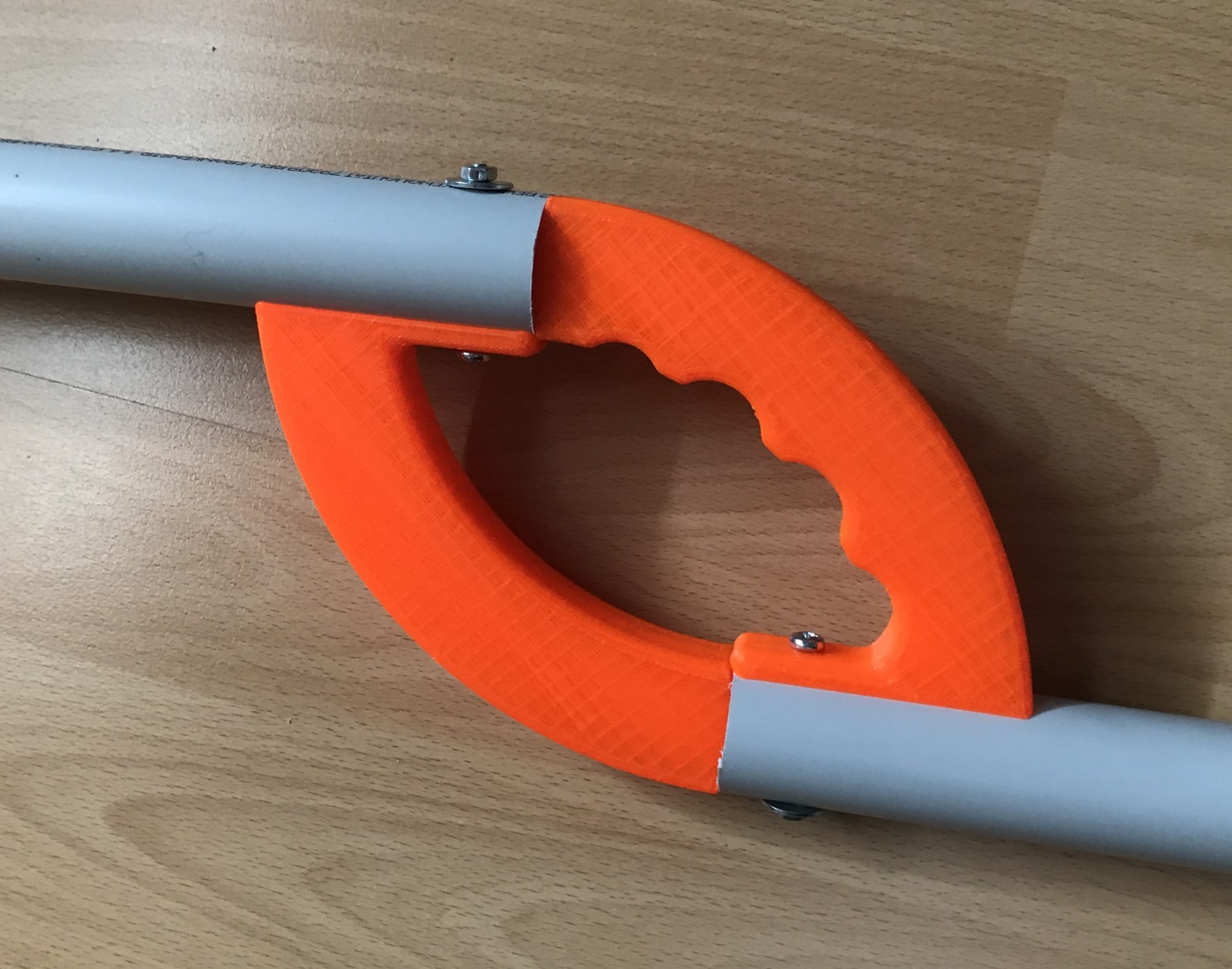

              We decided to design two different types: one with a single tube using a simple handle, another version with a two-tube design and optimized handle.
              The rear end of the tube gives space for the batteries (8x C-Cell) for long power-on time and which also work as counter balance. The basic idea of this design is to give everybody the chance to change or add other (improved) parts which fit the personal needs.

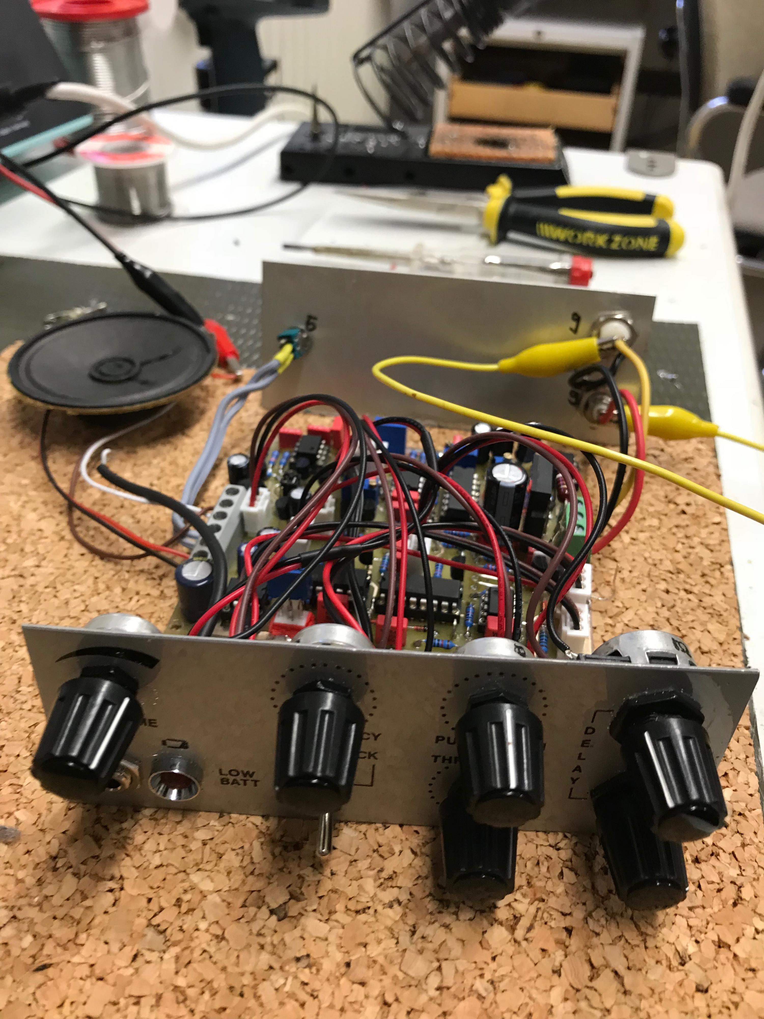

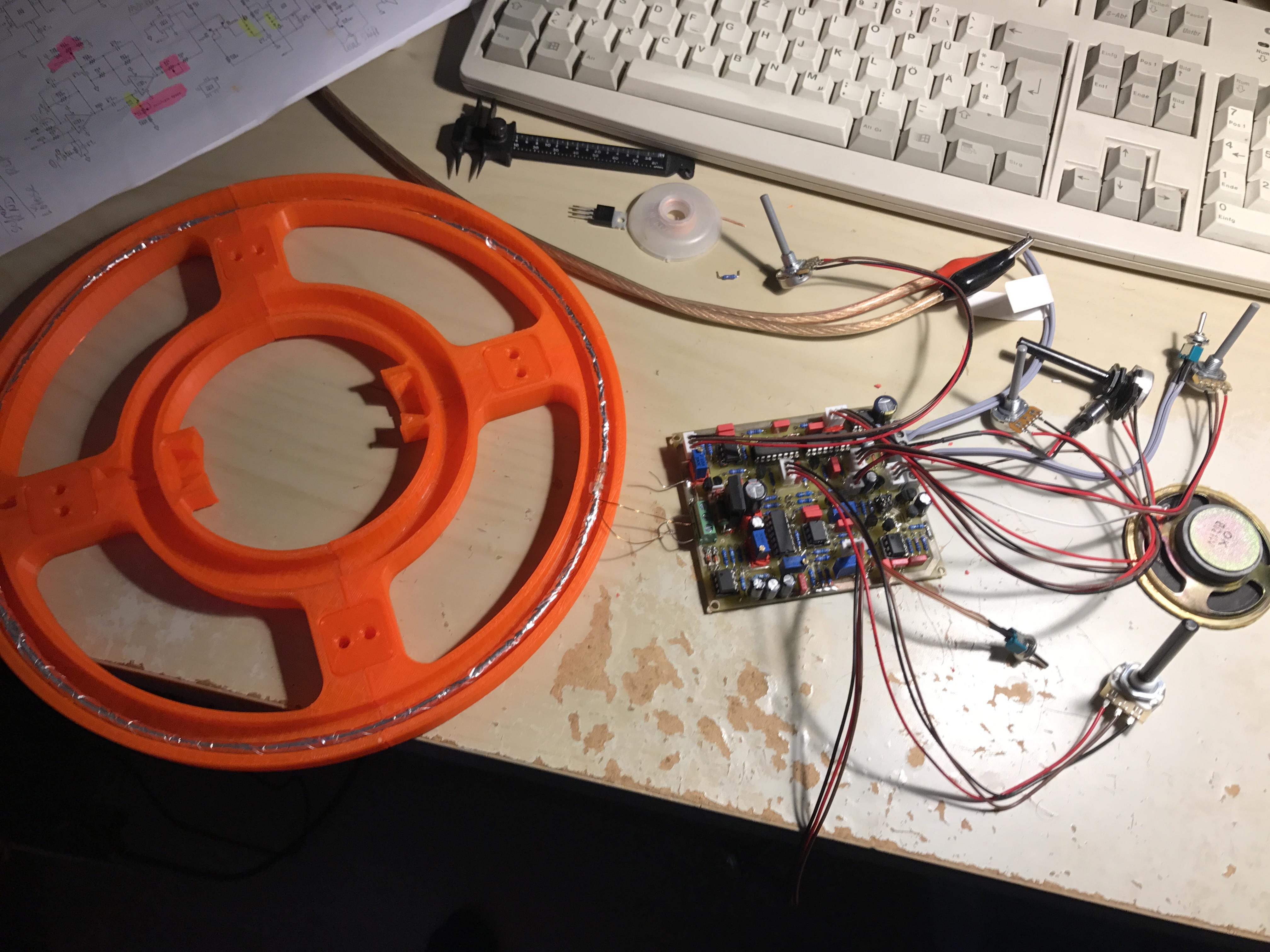

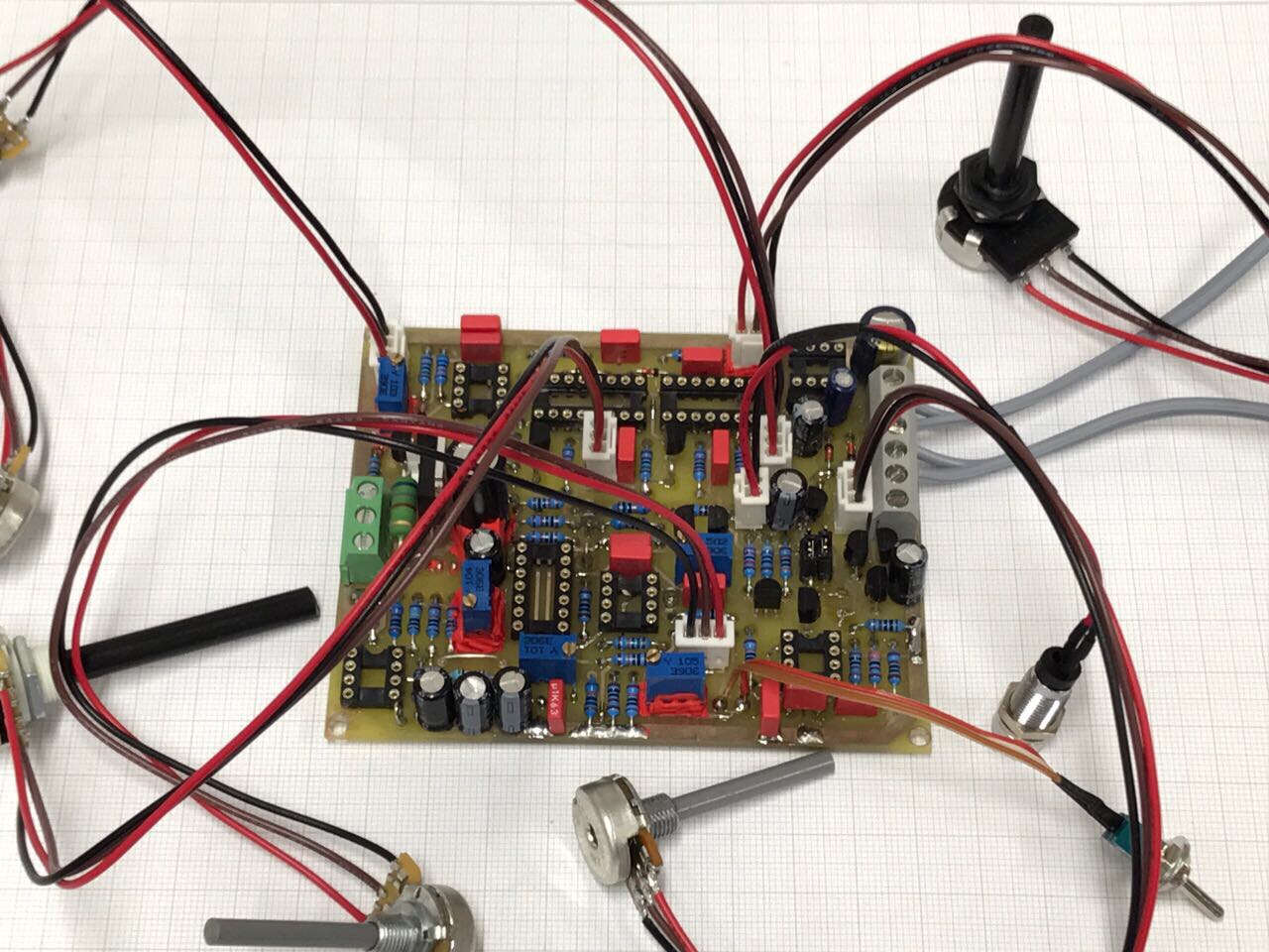

                  PCBs have been delivered and the first one is ready for power-up and calibration !Click image for larger version

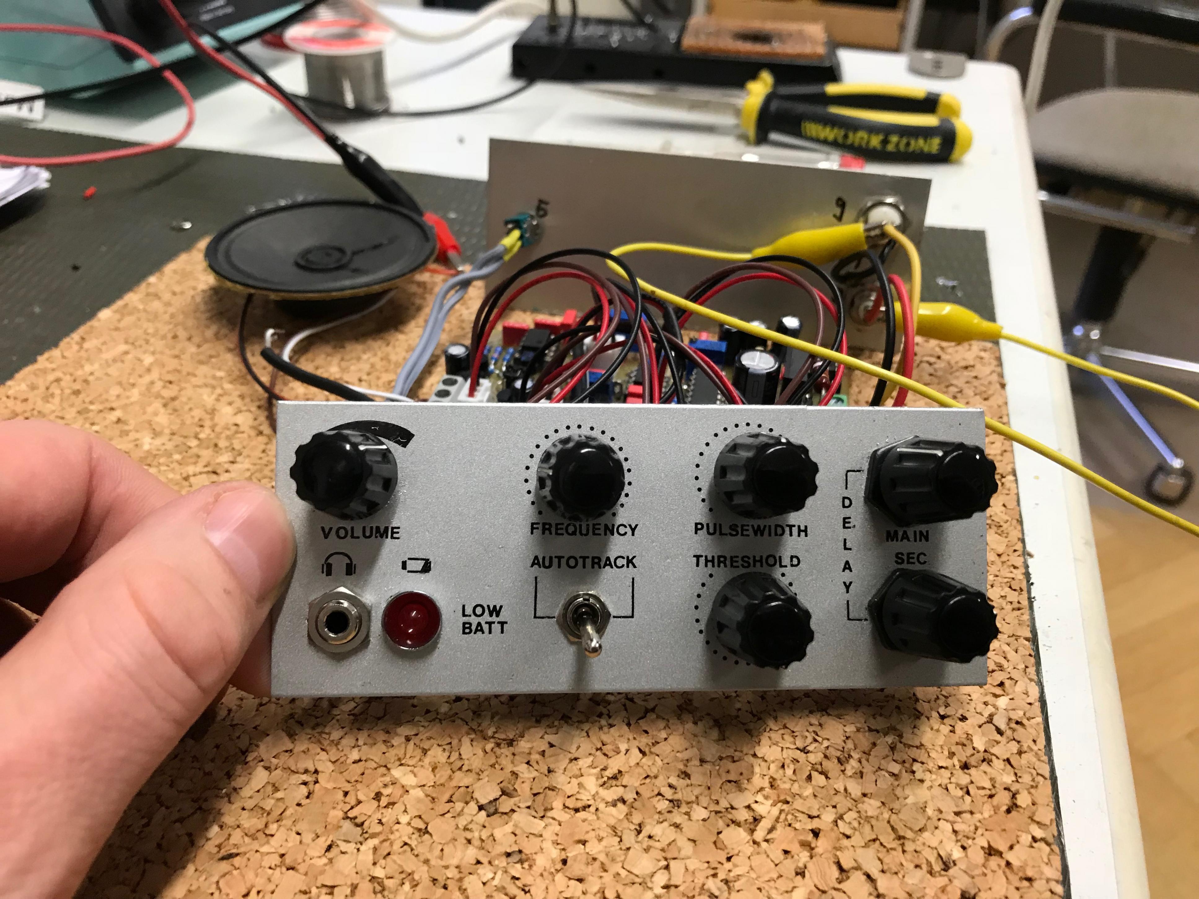

                    Power up was successful, we had to replace R53 with 22kOhms because we use -6Volt / +6Volt regulators instead of the -5 / +5 Volt regulators. We decided to do that for some more stability - the SA555 runs almost at minimum voltage with 5V. For diodes D1 and D2 we use BAT 42 (with low 0,33V forward voltage) instead of 1N4148.
                      Here are some pictures of our first assembly. It is working fine (so far). We're testing another FET IRFP 640A (with lower internal resistance) as coil driver Q3. So the RX coil current is about 12% higher, but is tending to ring faster. We will see...

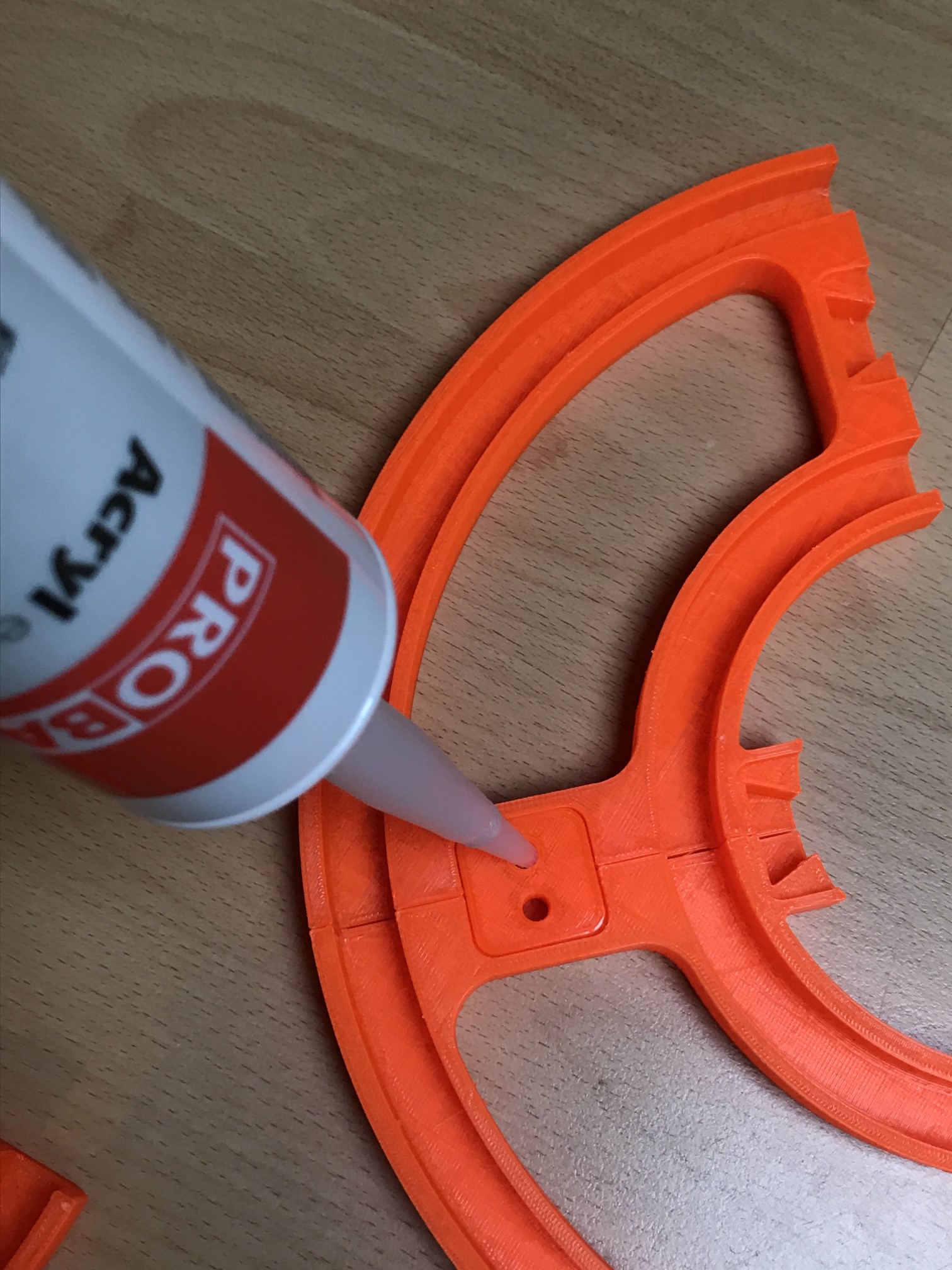

                            What material did you make the orange coil former from and what did you use to glue it together ? thanks.

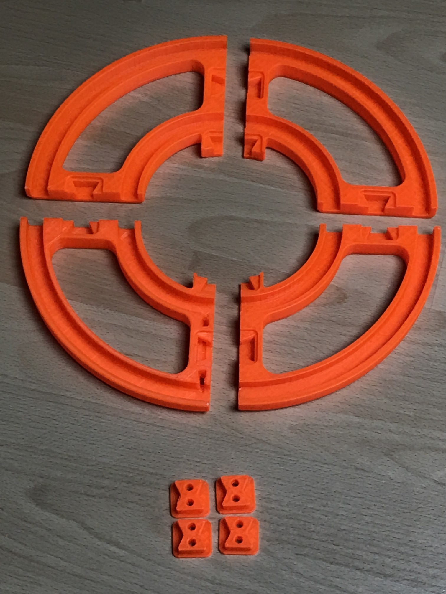

                              The orange parts are all 3D printed PLA plastic. We use RTV silicone to fix them and to seal coils and connections. More pictures and the parts can be found at Thingiverse:
                              https://www.thingiverse.com/thing:2478864
                              We also designed a special to type battery pack / holder:
                              https://www.thingiverse.com/thing:2529149
