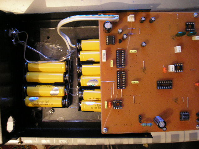

    Have built the Opt 2 HH, and seems to be working ok.
    I am using a Minelab 10inch concentric mono and will see a 1gram nugget at approx 5 inch of which i feel is quite good in Auto track. Although when i switch it to Fix mode it will not even see it. In auto it will pick my gold ring at about 10 or more inches and I switch to Fix mode and goes down to maybe 4 or 5 inches.
    I am using cmos for ic8 and cmos timer 555 for ic5.
    any help.
    tks
    george

      I have found problem .. My soldering should be better.
      george

            I only have CMOS 555's. I believe the bipolar versions require a pull-up resistor on pin 3. However, Q1 and R5 effectively form a pull-up, so any 555 might work.
            - Carl

                  I use 7555 for IC5 but out voltage of IC4 = -2.3 and
                  IC4 very hot nearly burned.
                  so replace 7555 with NE555 then out voltage IC4 = -5 and work good.
