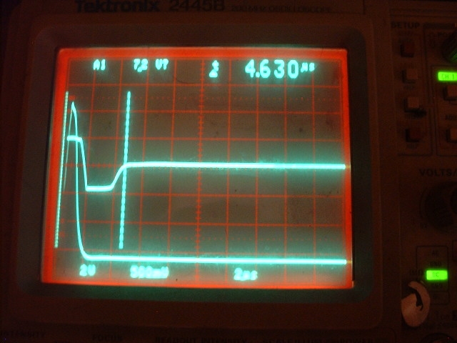

The TP1 Waveform
    Regarding the Q3 drive, -3v is a little low, should be more like -1v, but it should still be OK.

      I just realized that in Opt.1 there is R15=10k, which will cause the levels you are seeing. If you short R15, The level should be close to -1v. But none of this really matters, -3v is fine too. Yes, leave R9 at 220 for fast pull-down.
      On TP4, this is the output of an opamp, which probably does not swing rail-to-rail, so +/- 4v or so is normal, and will vary amongst opamps.
      I still cannot explain the funky TP1, so just leave R37 open for now.

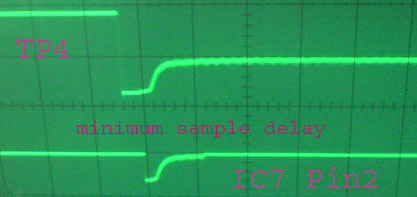

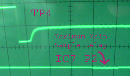

                  The problem is around the IC6 and IC7.

                    Your pic of TP 4 is correct. I am not sure how Carl got the pic he did. The voltage should be higher on the left, then drop negative and then ramp back up to 0V just like what your detector is doing. The higher voltage you are worried about is the signal you get at TP 4 when the pulse is occurring. If you also look at the pulse, you will see the pulse current on when the voltage is higher.
                    Let me know what you find if you adjust R 35 to maximum resistance and what you see if you check the 12V supply. I suspect you will see the 12V dipping when you hear the beep.
                    Reg
                      My HH TP 4
                      Here is a pic of my TP 4. As you can see, the voltage is higher on the left, then drops negative and finally ramps back up to 0V.
                      This is a proper pic of what you should see.
                      Reg

                        I cannot get the main sampeling switch such as Carl's.

                        Does my TP3 look correct?

                                First, Reg is right, my TP4 waveform does not look right. I suspect I took the photo before properly setting R18, and didn't notice it was wrong when I included it in the article.
                                Second, all your waveforms look fine. It appears you have the sample pulse width set to maximum, so you might want to narrow it a bit.
                                Third, if the beeping is still occurring even without the coil connected, then you have a circuit problem, and it should not be too difficult to track down. Use the oscope to probe all the nodes in the signal path, esp. around IC8 where everything should be DC. Look for jumping voltages that should not be jumping. Start removing components, beginning with the speaker and working backward, until the jumping voltages cease.
