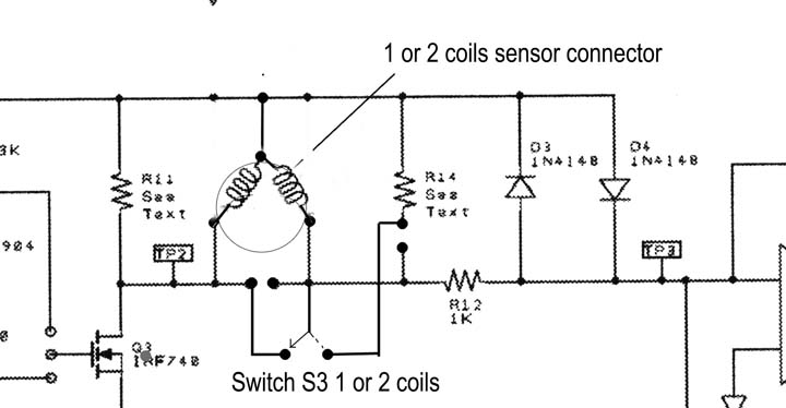

                              • #45
                                1 or 2 coils switch
                                Because I will using a 1 or 2 coil sensor, i will using a extra switch S3 , see image.
                                Any comments?
