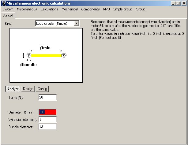

              problem with MiscEl
              Tinkerer,Please help me With MiscEl. I love its apparent flexibility but I can't get my desired function to work.
              What is wrong with my coil diameter entry? Meters is the default unit of measure for the Diameter box, so .28 should be interpretreted as 280mm, right? I am confused.
                Use 280m and 12m.
                You have to cheat with the wire diameter. Use first the copper diameter and then do it again with the copper plus insulation to get the wire length.
                For the fill factor I calculate the surface area with a normal calculator.
                For PI reference I use the outer diameter of the coil, since it has to fit within a coil form, but for Misc.El you have to use the average diameter.
                So my TX coil as described above, has 280mm outer diameter.
                Tinkerer

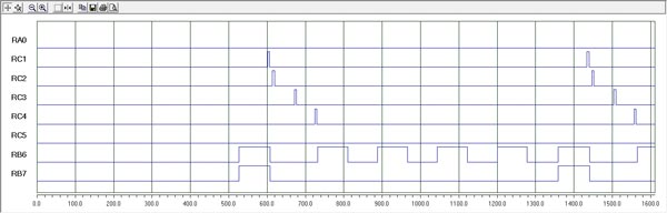

                    PIC timing schedule
                    Here is the timing schedule

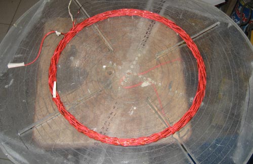

                      Polypropylene spacer coil
                      OK, so here is the TX coil as promised. It does work.
                      I will move this coil thread to the other coil threads now.
