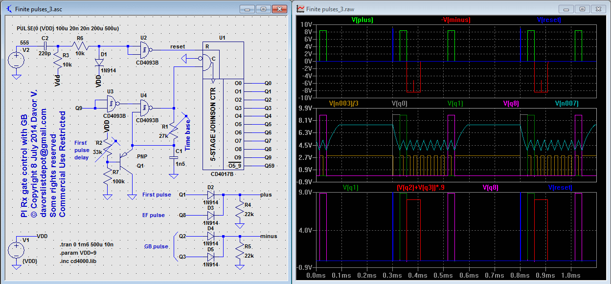

    • Since you are so fast, you could try this time base as a GB for minipulse too. It will take you 20 minutes at most
      Ask me for details if you are interested.
                    Davor have you built your time base ? how does the 4017 cycle through with the clock connected to the reset ?
                    • There is a clock on the reset line to restart the sequence. You get a first pulse,
                      a double GB pulse then a second pulse then after a time the reset starts it all
                      over again...
                      See here, the blue pulses are the reset or restart pulses;
                      http://www.geotech1.com/forums/attac...6&d=1406921335
                      • Maybe I dont understand how a 4017 works,
                        the counters need to be reset at some point in the sequence,but if the 555 pulse is connected to the reset pin (15), (not the clock pin 14), the 4017 will reset the counters back to zero with each 555 pulse, how do the counters cycle if the 555 is continuously resetting the 4017 with each pulse.
                        • Hmmm is U4 somehow running as a independent clock
                          how does this thing operate Davor ?
