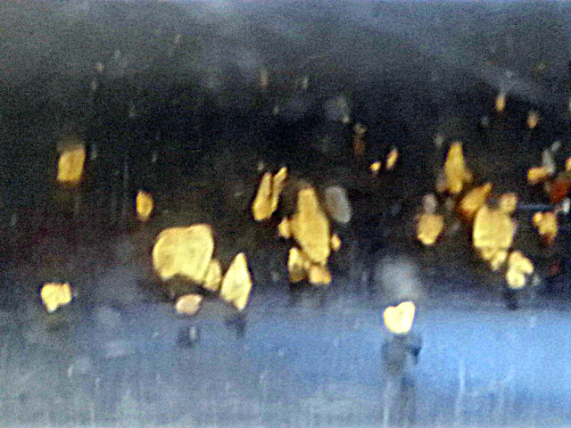

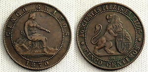

    Hi guys! I'm back from my vacation in NW Spain where I had lots of detecting and gold prospecting fun. I must say the MPP passed the beach tests with fying colors, it's able to find tiny coins like "perra chica" (1870) at great depths in a mixture of wet sand and rubble.
    Met people who are detecting nuggets in old riverbeds but I hadn't the time to gove it a try. Panning did show up some flakes, though:
    I'll be back next summer and would be glad to meet you guys over there to share the fun. Detecting is legal, no permits required. The same for gold prospecting and there's plenty of it. Who would like to join?

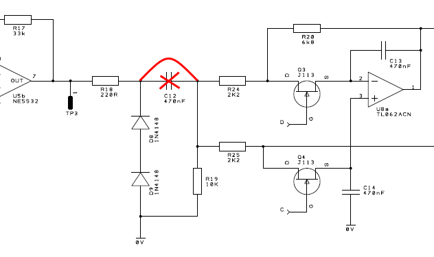

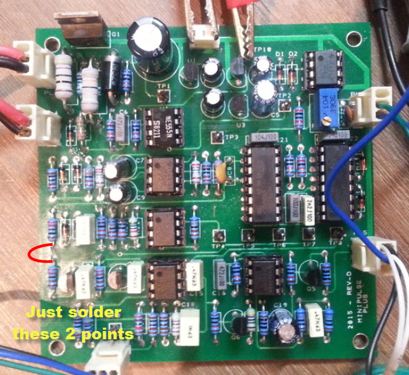

      I have shorted C12 in my MPP Rev-D following the advice of Eric Foster in this thread:
      http://www.geotech1.com/forums/showt...381#post219381
      Being absent from the Forum for a while, I have not followed the Minipulse Plus thread and what changes/improvements have been made. I have only just looked at the schematic and done some quick comparisons with the Minipulse B schematic of January 1989. I will say, however, that there was never a problem with EF with the integrate and hold circuit that I started to use around that time. The same arrangement was also used in the Superscan and the waterproof Aquastar when they were in production.
      Where a problem can arise is if the coupling capacitor (C12 in the MPP circuit) is too low a value. In the original MP it was 22uF, while in the MPP it is 0.47uF. The Garrett XL500, for which I designed the circuit, had EF problems for the same reason; they substituted a low value capacitor for the larger one I originally used. Luckily I checked an early production one and wrote a report for Charles Garrett.
      If you scope across R19, with the 0.47uF, you will likely see that the pulsed waveform no longer has a flat d.c baseline but is a ramp. You need a flat, or substantially flat baseline to get good EF cancellation, so it is either a big capacitor or direct coupling. In the MP I used a tantalum capacitor and offset the preamp output to -0.5V to give the capacitor a bit of dc bias.
      Today, with better I.C.s and tighter component tolerances, I generally couple the preamp to the integrator input without a blocking capacitor. With good balance in the differential integrator any small offset changes in the preamp cancel out anyway.
      Eric.
      The detector seems to work just the same (indoor tests). Recovery after a strong target signal seems faster.
      I'll check whether the EF signals I had been noticing will go away.
            Now that you have eliminated the AC coupling, wont you now have to look at the DC offset from the preamp ?
              I might, but it all seems OK because I can adjust the sound threshold as usual and the frequency swing caused by targets is just like before.
                Thanks for reply, I would be very interested in , if you still have your pcb open on the bench what the DC off set from the output of the preamp is ?
                With the surf pi for instance , it needs a zero off set for best target signal, thanks.
                            The offset is 1V. The offset of the differential integrator is 25mV with no target.
                              Thanks.
