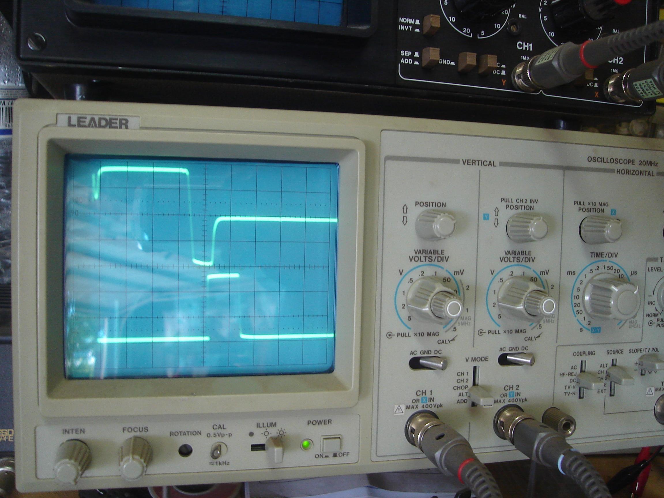

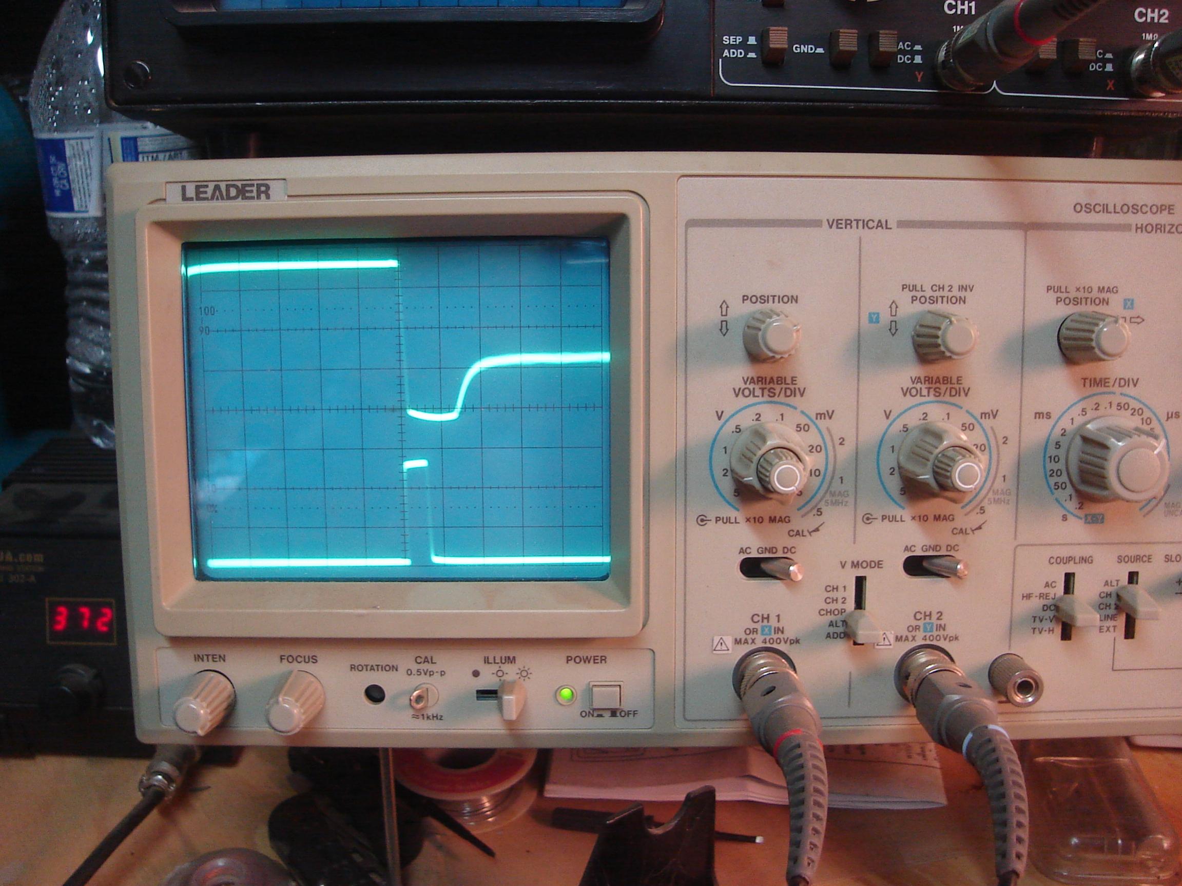

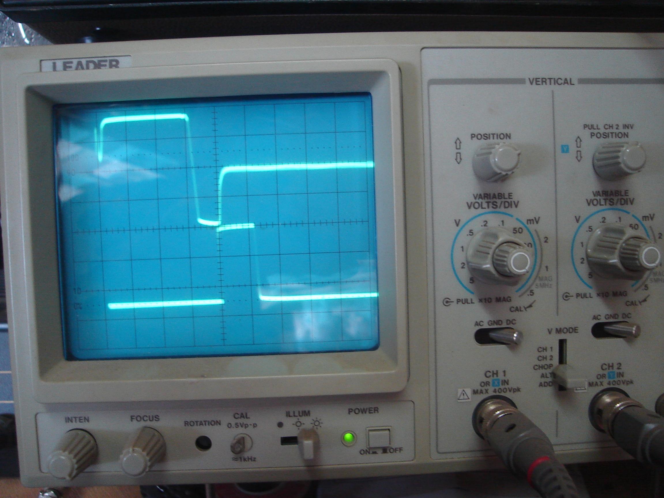

    And just so I know I'm setting things properly and reading my scope correctly, setting the time division to 1ms and adjusting to say 5000 pps on my board should give (show) a dot/trace every 5 divisions, correct? like example pic below, set at 1ms/3000 pps with a dot/trace every 3 divisions. Please correct me if I am wrong.
    I think you're getting yourself a little bit confused with the scope settings.
    The pulse period is the reciprocal of the frequency (or pulses per second). Hence 1000pps with have a period of 1ms, 5000pps will have a period of 200us, and 10,000pps will have a period of 100us.
    In your attached image you have a pulse occurring every 3ms. Therefore, the pulse rate is the reciprocal of 3ms. i.e. 1/3ms = 333.33pps.
    In other words, to increase the number of pulses per second (pps), you need to decrease the pulse period.
      You should change R7. Try different values and see how wide you can adjust the pps with R8 as trimmer.
        Holy S***, you know I knew something didnt feel right or look right but could not remember for the life of me how to set that.
        Thank you for the clarification, now I remember and was thinking exactly opposite of the right way.
        Now I have it set correctly, which using 50us as the time table I have form every 5 divisions, also had forgotten I have a meter that measures Hz/Khz so double checked it as correct. Will add a pic in a bit..
        This test board will be adjustable for testing purposes, right now it is set to 40us for the TX main pulse with the freq adjustable from 1000/10,000 pps set at 5000pps or 5.01Khz.

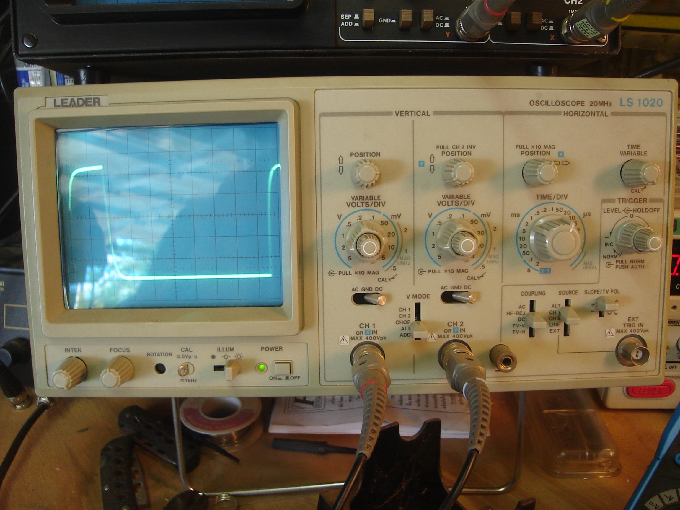

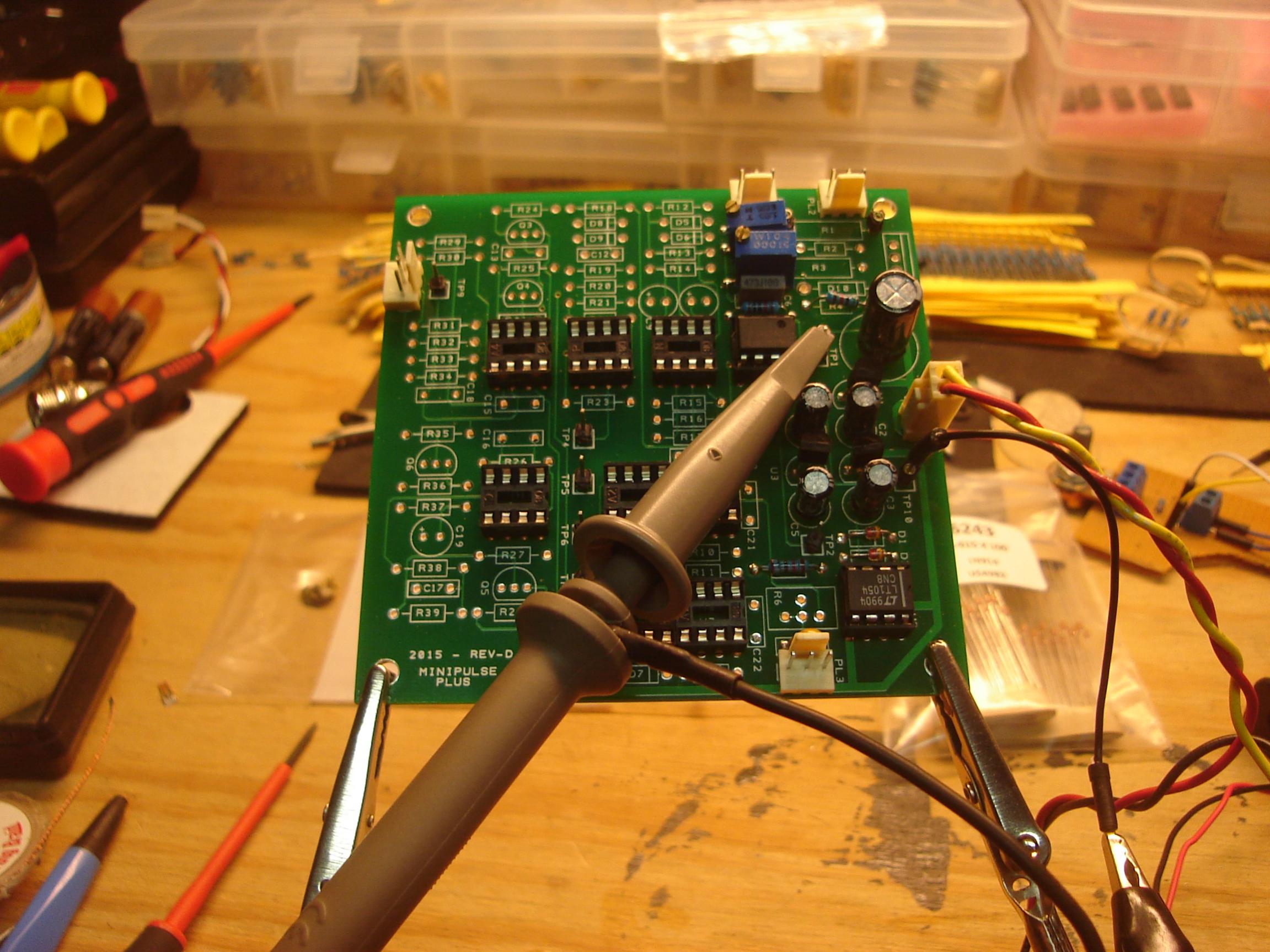

          Can you post a scope image of the signal on U6 pin 5?
          I cannot check this myself, as I'm currently away from home.

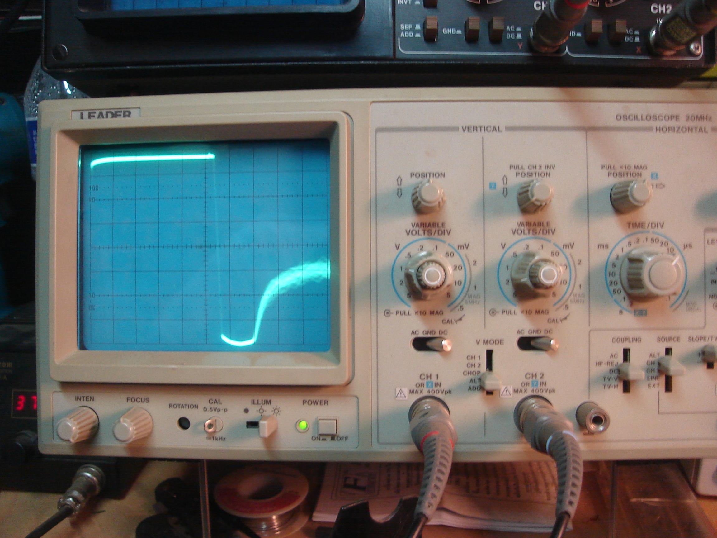

            probe pin5 U6

            Sure can, although during my test with the freq I installed a 15k in place of the 10k at R4 so the scope shot may not show what you are looking for.
            the scope is currently set to 2v div/20us div. let me know if I should change the scope settings to help with what you want to look for.

            Looks to be the same as the tx main pulse...

              However, I should have realised that you were working on a new build. I really wanted to see the signal with U6 installed in order to check if there is any loading. From a quick LTSpice simulation (with a simple bipolar transistor as the input and no protection diodes) the signal is limited to 5V amplitude. But it definitely needs the series resistor to work correctly. It's also ok with 15k.
                Thanks.
                OK, cool. we will come back to this point as I progress thru the steps and retry the scope shot just to see on board.

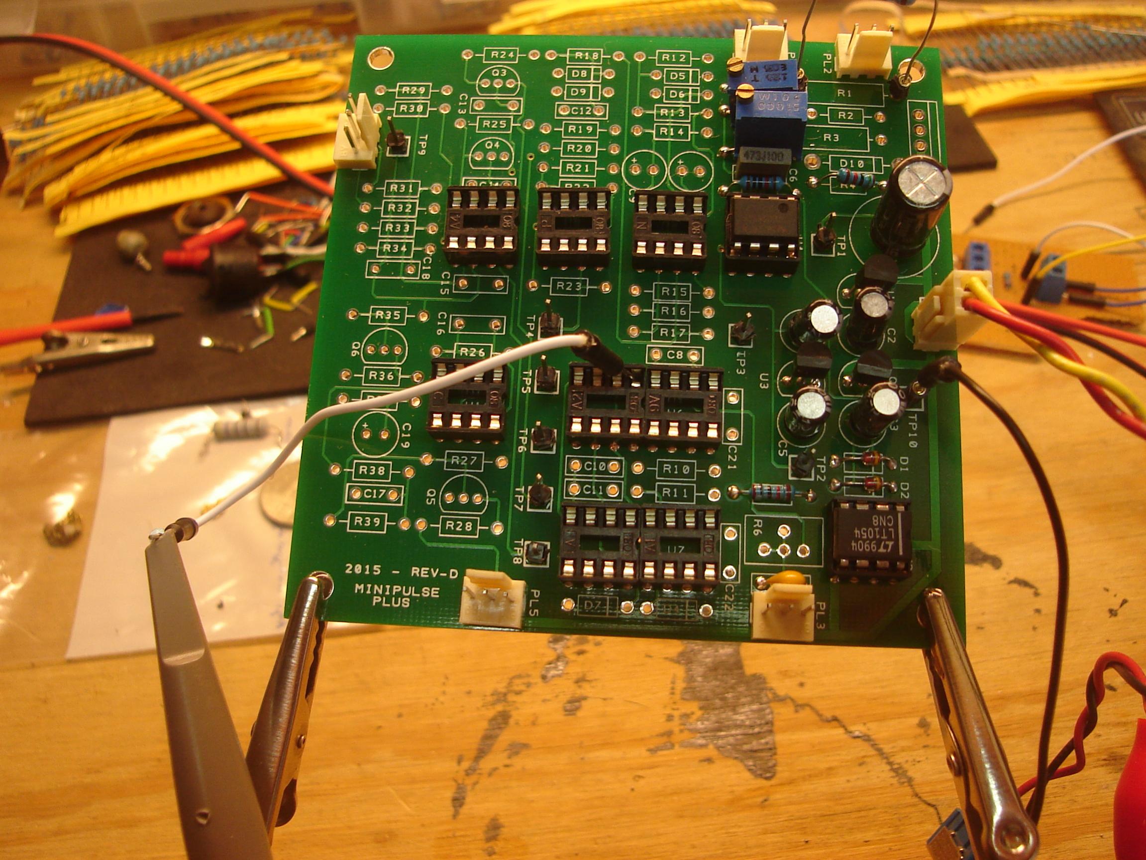

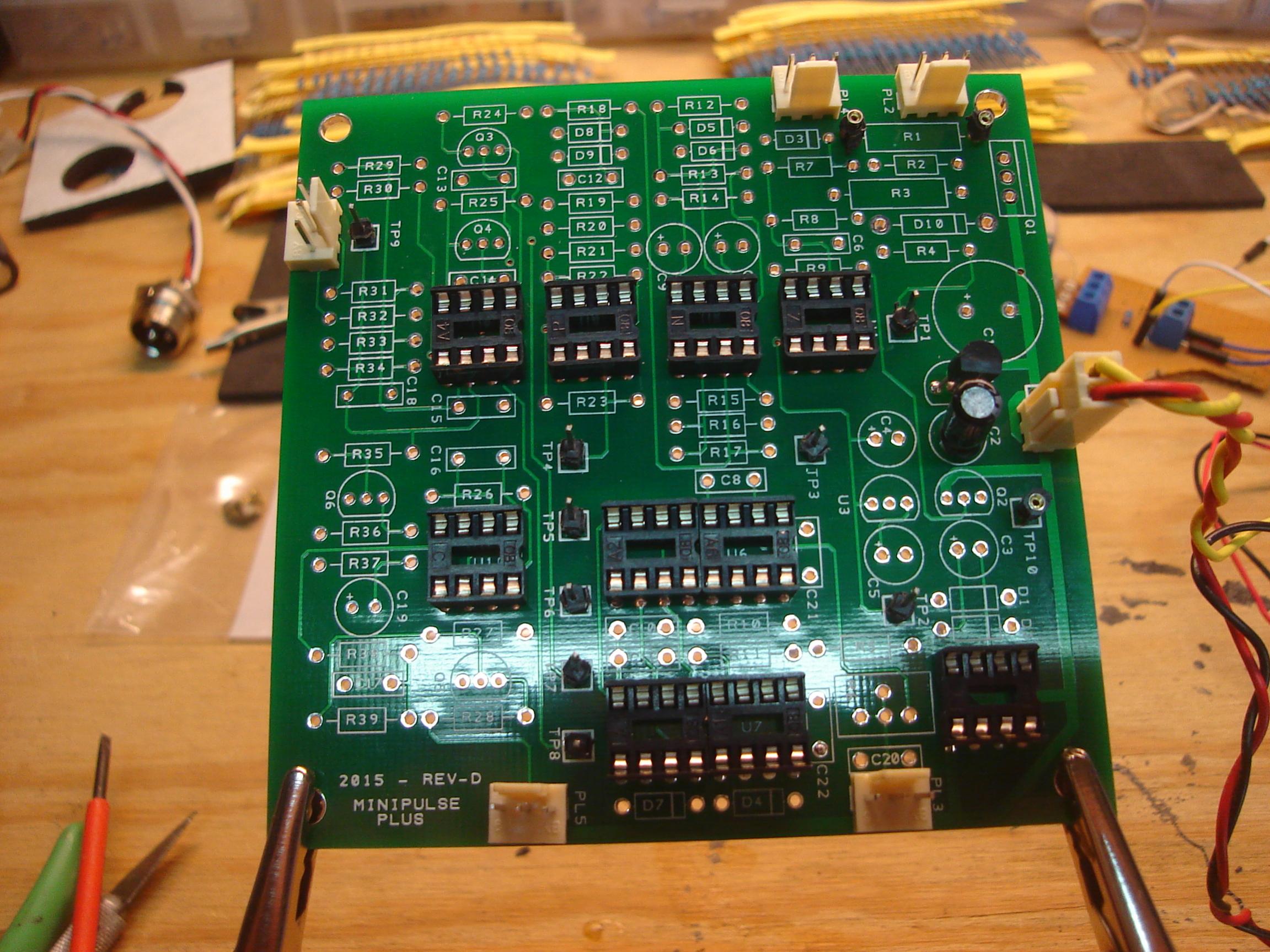

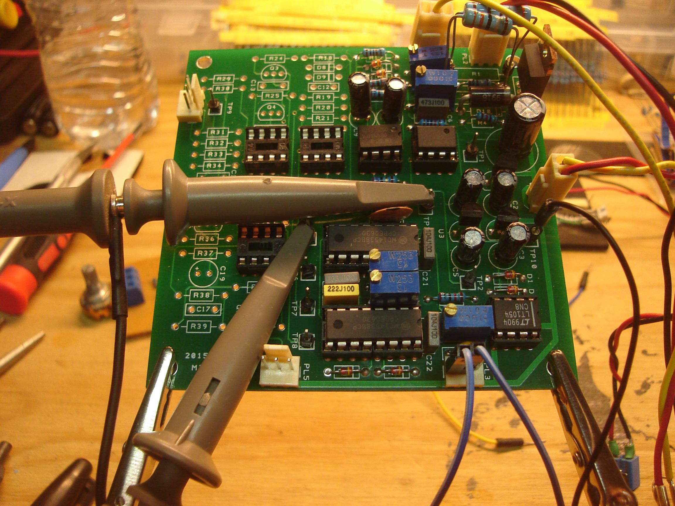

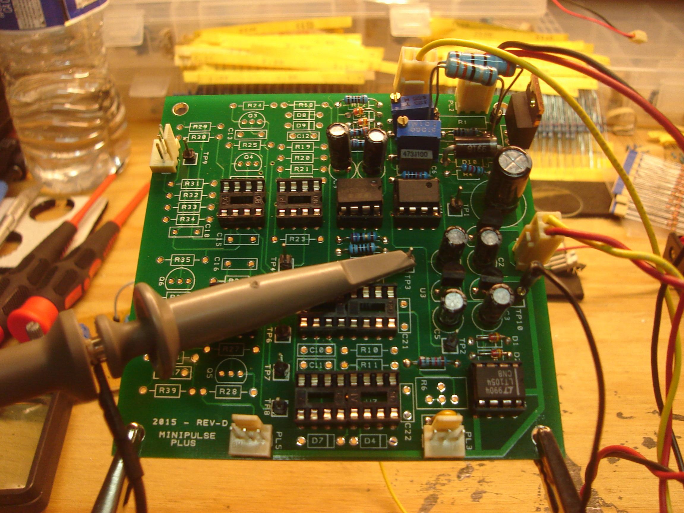

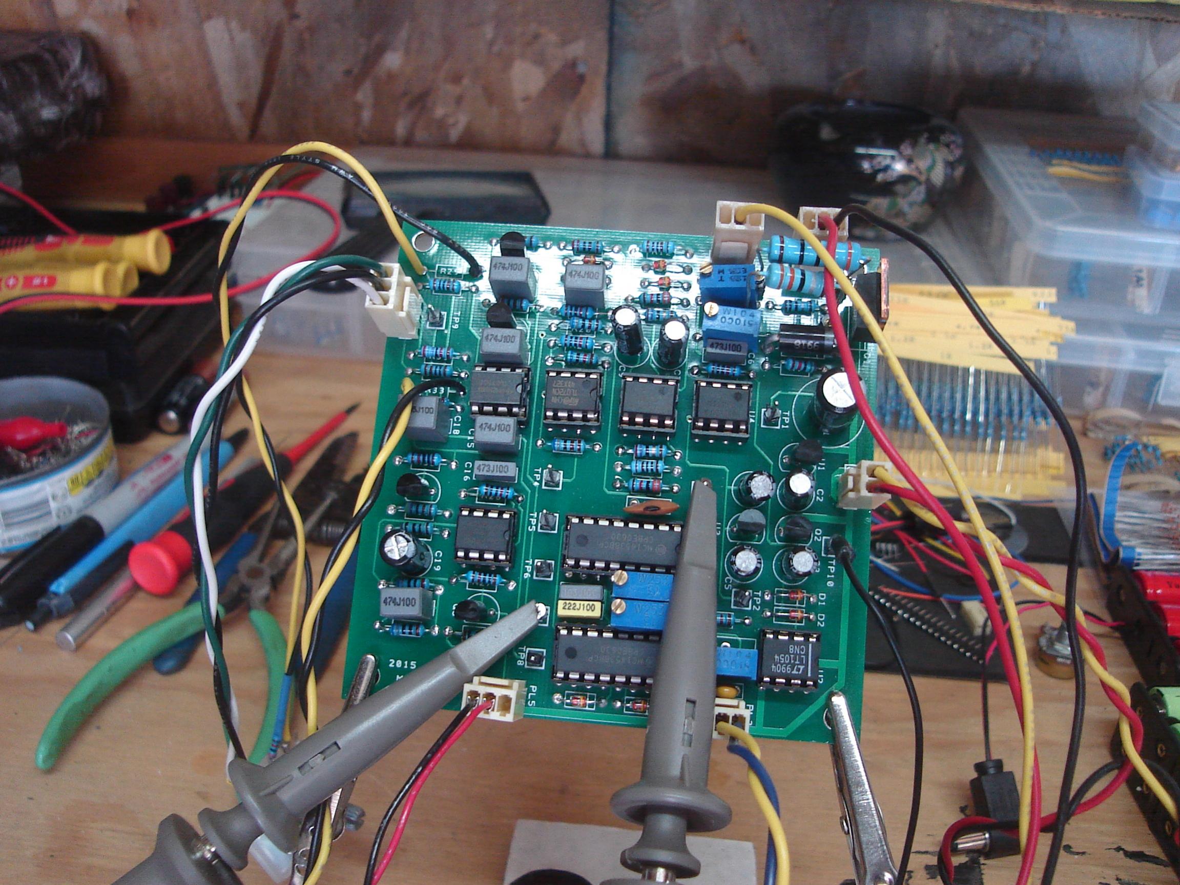

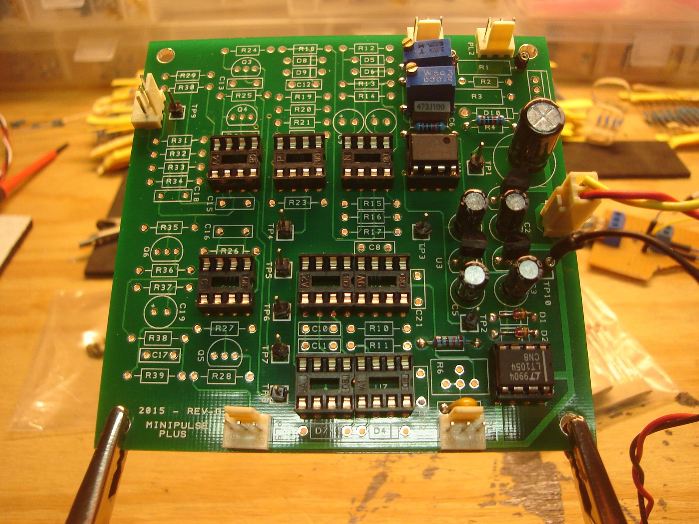

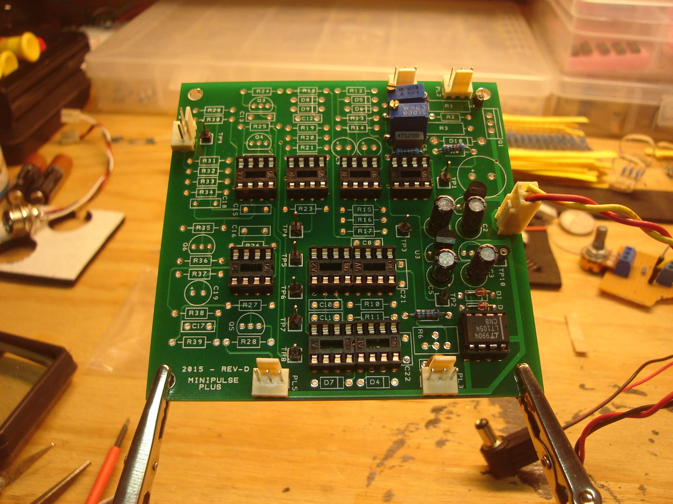

                  Finished steps 1 thru 7 now and everything is right on que and working perfectly. Thought I'd have it finished today but am missing some parts from my parts bins that I must have forgot to replace so will be waiting for a few days to button it up.
                  will post some pics after completion and add more scope shots for others to use as reference as well for their projects.

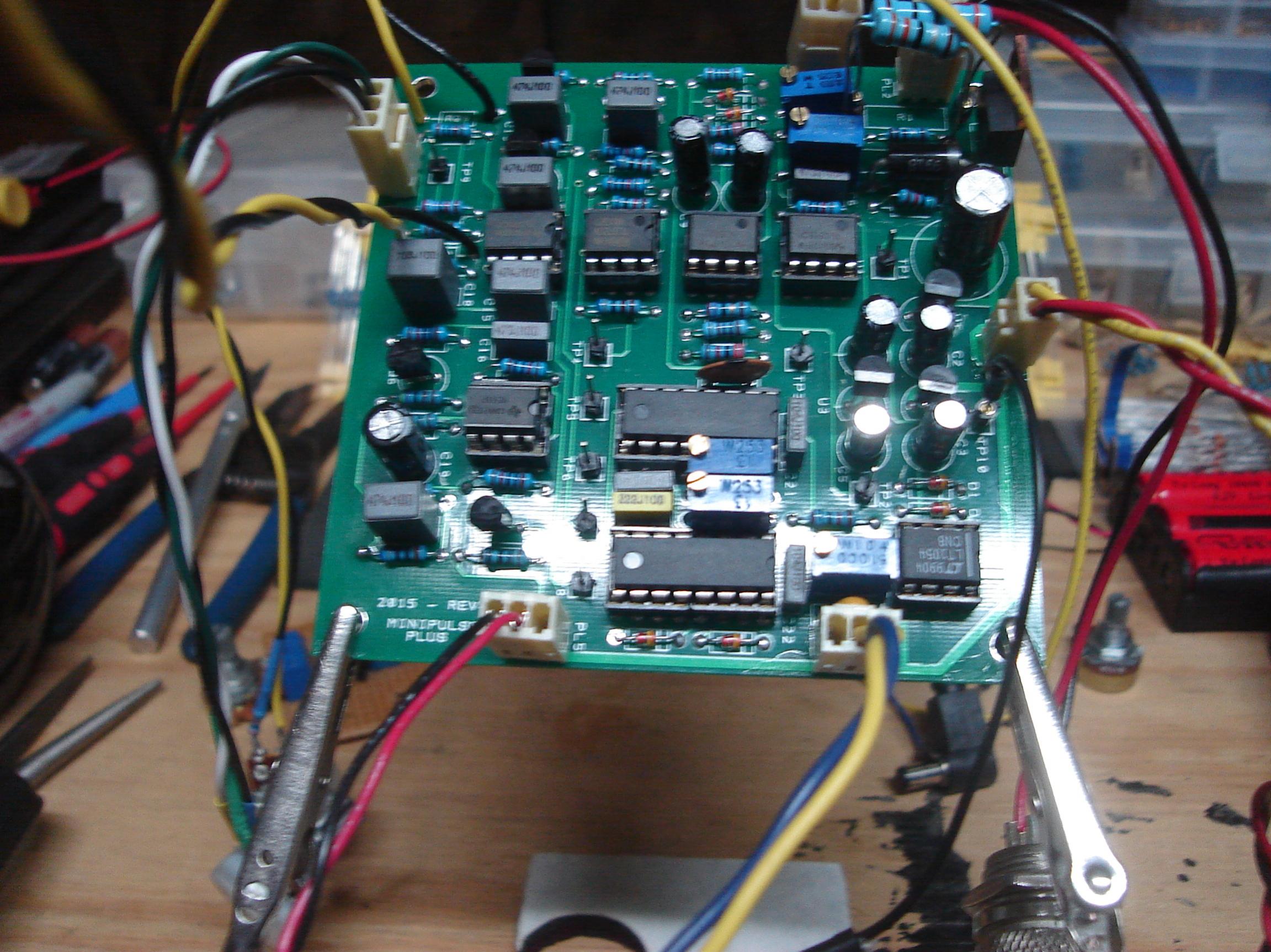

                    Finished - Modified Minipulse Plus #3
                    Well found some parts to complete the board so she is done and working like a champ without fine tuning yet. Did reset the TX main pulse to 30us with freq set to 3000 pps for starting point to initial testing.
                    First tests without tuning give:
                    US Nickel = 9 inches
                    14k Ring = 8 inches
                    1.2 gram nugget - 4 inches
                    .45 gram nugget - 1 inch
                    Will fine tune with test coils of 5x9 Razorback, coil spec is 312uH @ 2ohms shielded, second test coil is 8x10 DIY 3DSS, specs are 309uH @ 2.3ohms, 600v teflon 7/32 silver plated 24awg unshielded.
                    Some pics:
Name:	Board started.jpg
Name:	1 Power supply & TX oscillator.jpg
Name:	2 - Steps 1, 2 and 3.jpg
Name:	3 - Setting TX pulse.jpg
Name:	4 - TX set to 40us.jpg
Name:	5 - Testing TP3.jpg
Name:	6 - Testing RX section.jpg
Name:	7 - TX and sample pulse.jpg
Name:	8 - Board completed.jpg

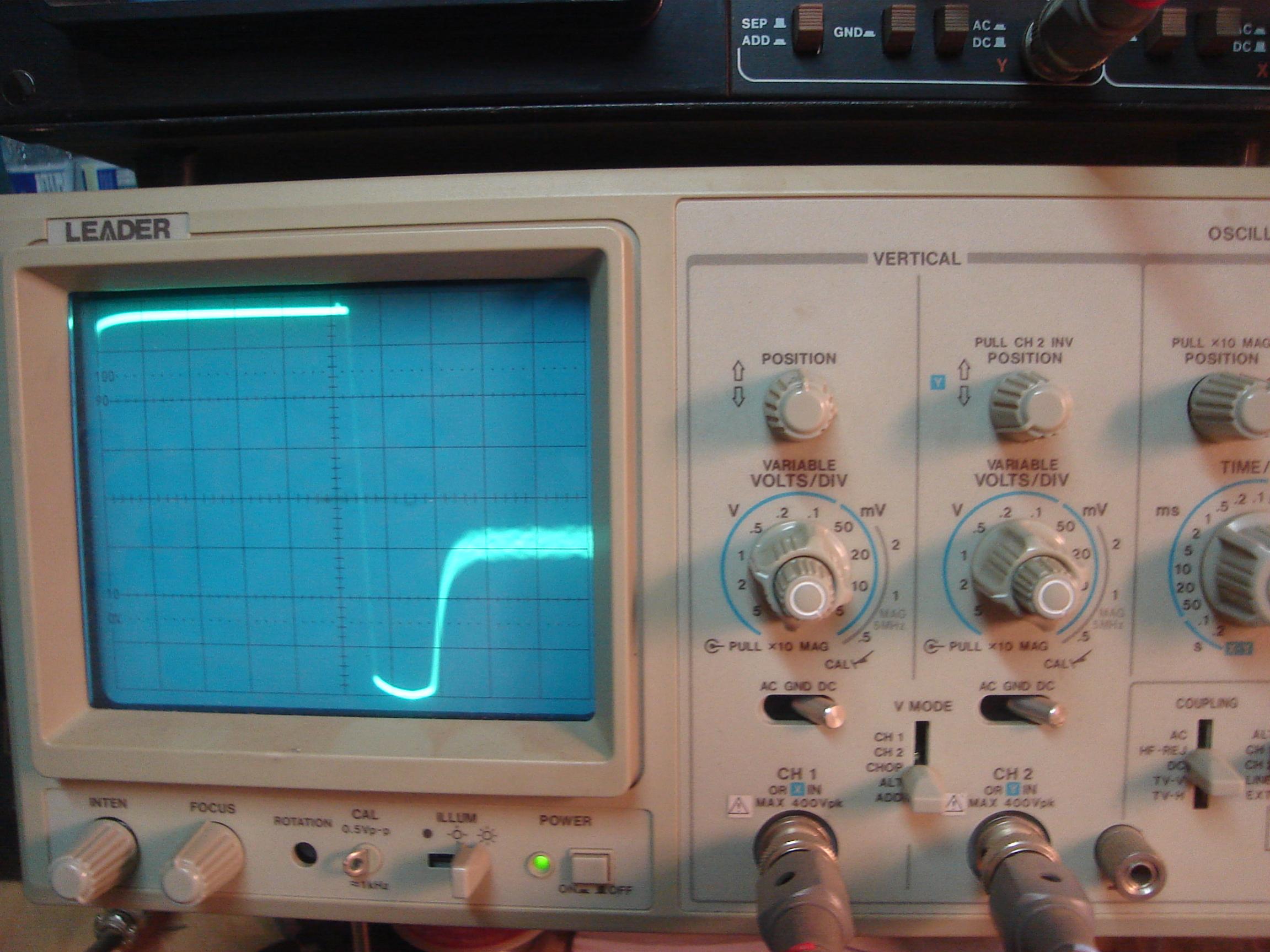

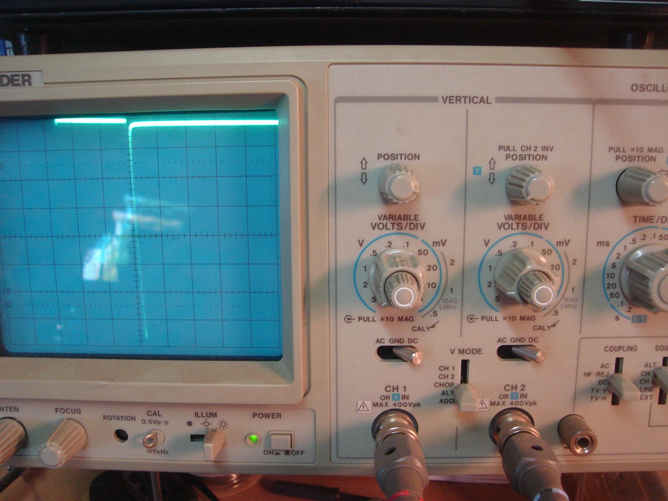

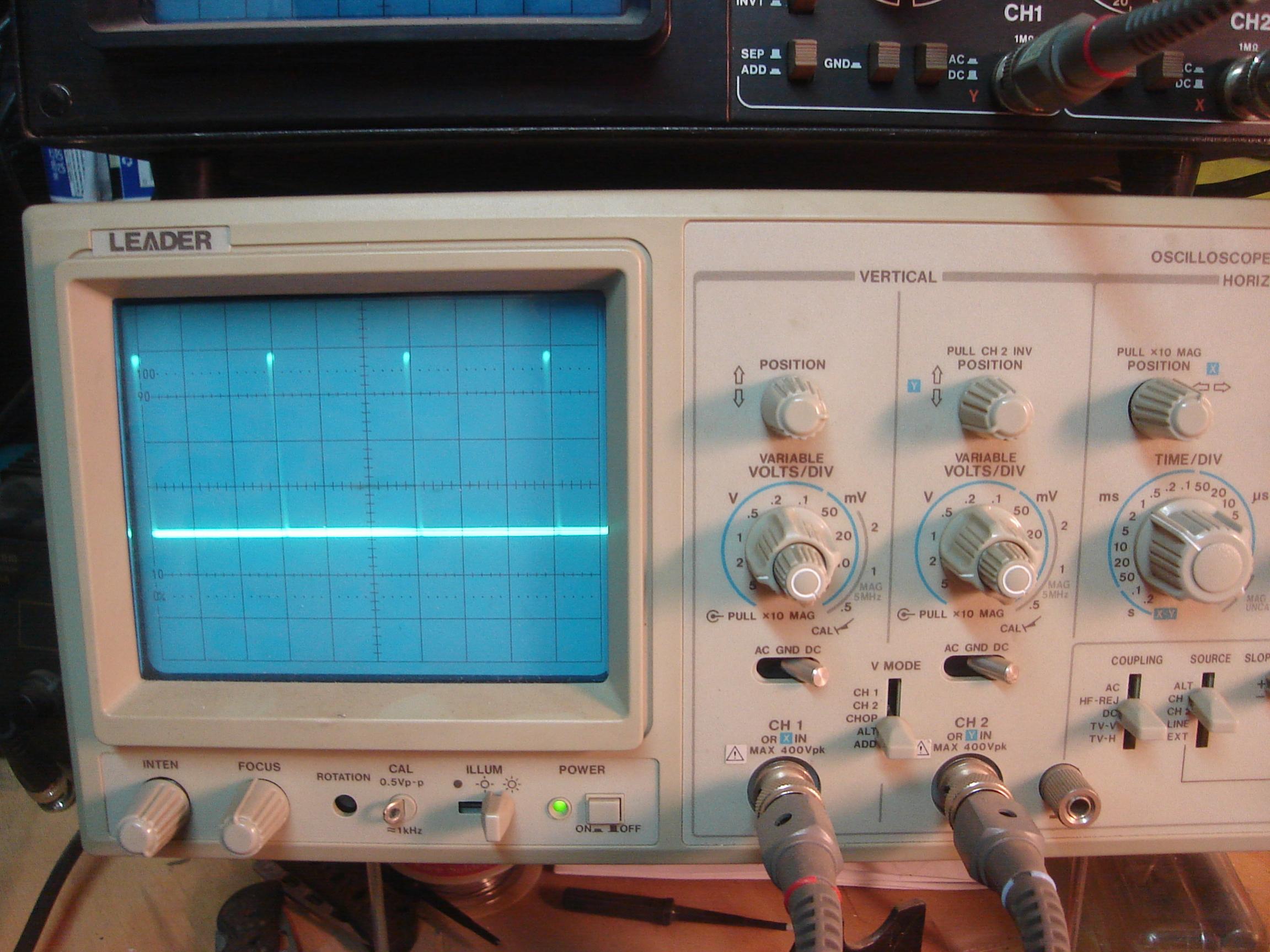

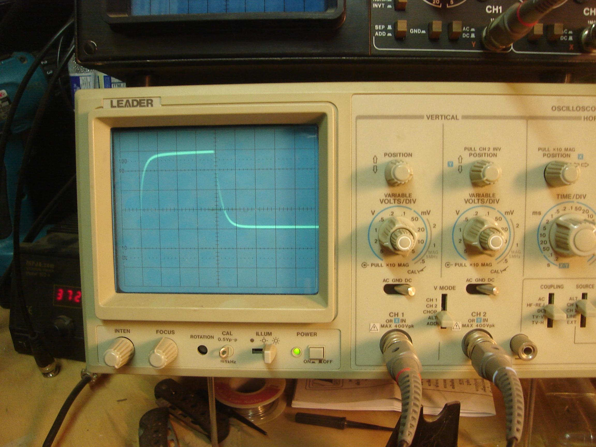

                      Scope shots
                      Some un-tuned scope shots, they me be out of order or not in build sequence but they are labeled and show what they should:
Name:	6us delay.jpg
Name:	380v flyback.jpg
Name:	TX pulse 34us wide Sample pulse 12us wide.jpg
Name:	TX with sample pulse.jpg
Name:	Voltage change 1.jpg
Name:	Voltage change 2.jpg
                      This board has R7/R8/R10/R11 using trimmers along with sensitivity pot added at R33 and pot added for SAT at R29. Also added dip single socket adapters for R1 & R3 for fine tuning purposes.
                      Will add more pics and results after fine tuning with multiple coils. Will be wrapping a new 3dss 7-1/2in round with 175/46 2 layer litz as well, so will be using 3 different coils to find the best of the bunch. Then will build it out after the best combination is finalized.
                      Gotta mention again, a great project with excellent documentation not only being a good learning platform or tool but an awesome PI detector to boot.... Thanks for making this a great and fun project for some of us, the electronically challenged...
