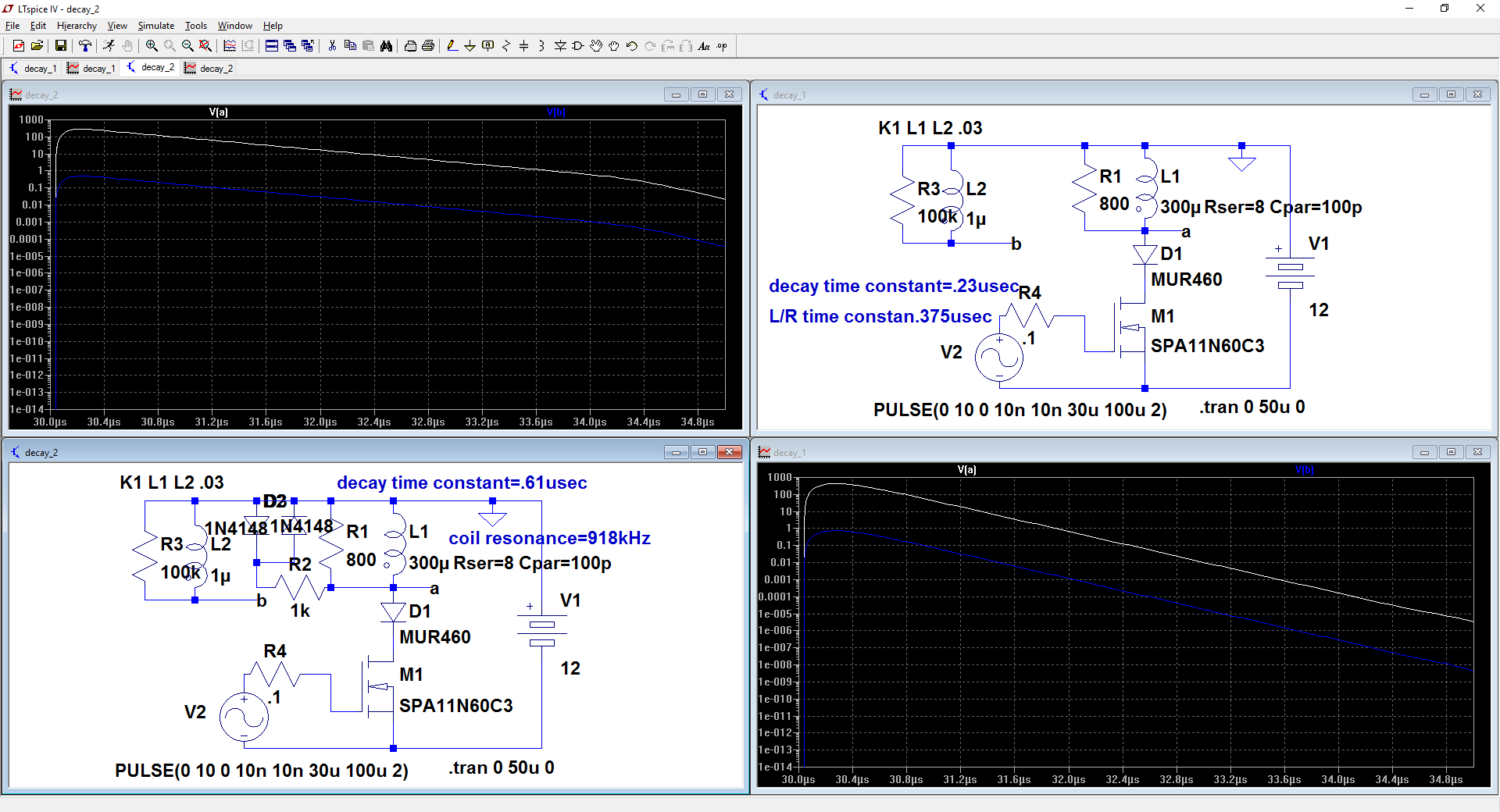

    Playing with spice. Simulation of a fairly high resonance 300uH coil that critically damps with a 800 ohm resistor. (Time constant) L/R=.375usec, critical damped coil=.23usec, coil with diodes and 1k resistor=.61usec. Is the simulation predicting what really happens? Are the decay time differences enough to cause a significant change in detection distance with a 2usec target time constant? Ran the simulation with a very low time constant target to see the effect on coil decay. If I made the target time constant 2usec could the simulation give me an indication of detection distance difference?
    Are the decay time differences enough to cause a significant change in detection distance with a 2usec target time constant? assuming the same delay time.

      Tried changing target time constant to 2usec with spice. Looks like target signal was higher with the diodes and 1k resistor, opposite of what I thought might happen. Might be a detectable difference in detection distance. The more I think I learn the less I understand.

            Target Time Constant (TC). All targets need to be charged with a pulse approximately 3 times longer than their TC because 3X will get you up near 95% of maximum current and provide a chance for the TX current to stimulate the target more deeply than just on the target surface. If you look at a LR current charge curve you will see that at one TC the current raises to about 63%, at 2 TCs it raises to about 86%, and at 3 TCs it raises to about 95% and from there on to 5TCs it is relatively flat and does not add much to the target's detectability unless the target you are seeking is massive and could use an additional TC or two to fully saturate.
            Delay Time. During the time it takes for the the TX coil to turn off, fully discharge itself (discharge slope governed by the discharge TC) and the flyback pulse with its oscillations caused by coil and TX circuit capacitance, the coil must wait for a quiet time when the receive (RX) time can be enabled. During this delay period, the eddy currents in the target are decaying based on the targets TC. Here is where the damping resistor value is designed to critically damp the coil for the earliest possible time when the RX signal can be enabled. But here are the realities of electronics that can sometimes interfere with our best intentions.
            a. MOSFET saturation. When the flyback voltage of the coil exceeds the maximum MOSFET voltage the MOSFET looks like a short circuit for any voltage above that maximum voltage looking like a flyback spike cut off at the MOSFET voltage such as 400V to about 600V or what ever you chosen MOSFET voltage is. Remember, the longer the TX pulse the higher the flyback will be so look at the peak pulse flyback voltage at the longest TX time you might use. The optimum damping resistor value is to allow the earliest sampling time without catching the very end of the damped coil discharge oscillations or the residual eddy currents still decaying in the coil, coil shield, coil housing or coax wire near the coil.
            b. Coil Capacitance. Coil capacitance works with the coil inductance value and the coil discharge energy to form a short term LC circuit that still oscillates after the initial flyback pulse decays to 0V and pops up again at a lower value and again at a lower value. This is called a damped oscillation and something that an optimum value of damping resistor should minimize so the stable 0V point is as early as possible and the RX time can begin. Now, any extreme spike voltages should be kept below about 0.6V by the two clamping diodes. The first op amp stage gain will send it in to saturation if it's gain is set too high or the supply voltage is too low. Here is where two stages of about 33 gain is better than one stage of 1000 gain because the op amp comes out of saturation faster and thus less potential delay time and more target eddy currents to detect.
            c. Coil discharge TC. Eric Foster mentioned a research paper he read that said that a target stimulation TC that is five times faster than the target TC will stimulate it as good as if the turn off was instant. With that being a reasonable law of physics that tells us that if you want to fully stimulate a target there is a point where you should aim. This point is defined by the coil inductance divided by the damping resistor effective value. Why effective value and not real value you might ask? The input resistor to the first op amp stage usually has an input resistor of from 1K ohm to a max (that I have seen) of about 2.2K ohms. This value is effectively in parallel with the damping resistor because the clamping diodes conduct at any voltage above 0.6V. More capacitance in a coil, coax cable MOSFET or PI TX circuit causes a lower value of damping resistor and thus limits the smallest and lowest TC target that can be effectively stimulated by that coil and circuit configuration.
