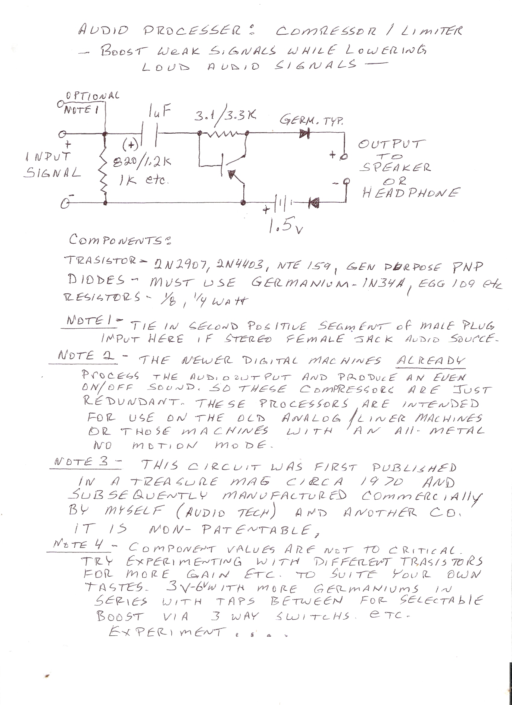

    Hey guys just been looking into audio boosters. Does anyone have a circuit for one or know where i can get a kit for one? Obviously im after the type that boosts low signals/sounds but doesn't blast your ears off with larger targets/sounds. Just dont want to sped $158 on one from ebay :/
    This is a Cool Easy Circuit.

      stereo or mono? something from low power 1... 0.5 watt pop up micros...
      http://www.ebay.com/itm/TDA2822M-1W-...gAAOSw9GhYc5i7
      http://www.ebay.com/itm/LM386-Super-...MAAOSw5cNYRnVR
        Awesome thanks guys. I will experiment soon. Seems very simple...almost too simple
          It may get even simpler if you have any audio transformers from old discarded receivers.

                actually this is typical circuit for LM386.
                  http://chemelec.com/Projects/Amp-LM386/LM386.htm
                    Gotta Love the LM386 ! Simple to use for sure.

                      I dont think this circuit is working correct, dc current is flowing thru the speaker..
                        LOL, Of Course it is. How do you think the speaker would make sound? It follows the source signal. Trust me ! It works better then fine.. Read the document. It was produced commercially for years.
                          Just to double check. This will raise lower sounds while not blowing my ears of with the louder ones?
                            LOL...SORRY ,i trust you, , the critical point is the supply voltage (1.5 VDC) it must be working.
                              Yes it limits the Blast. Works some what like a Compander circuit. https://en.wikipedia.org/wiki/Companding
