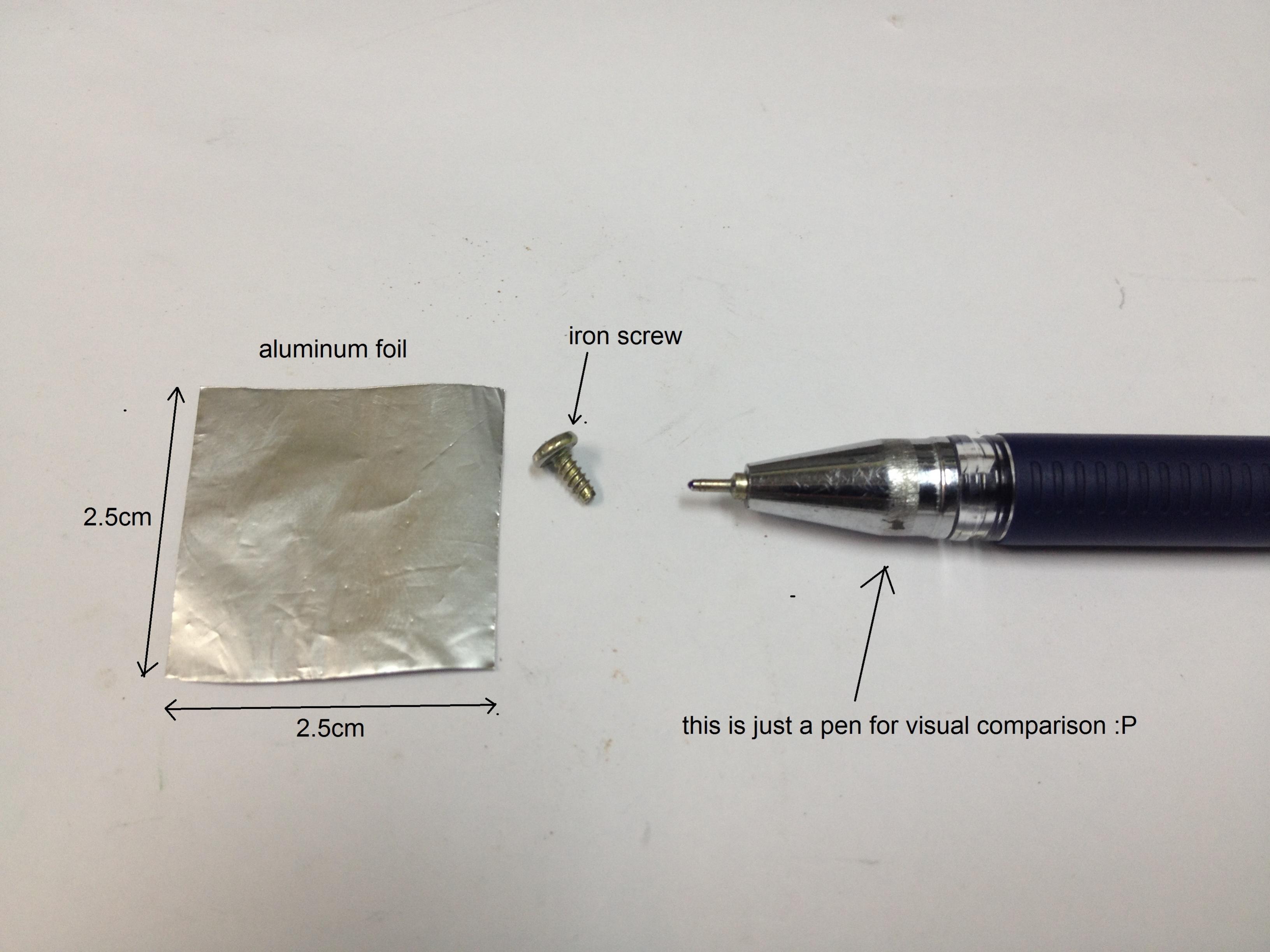

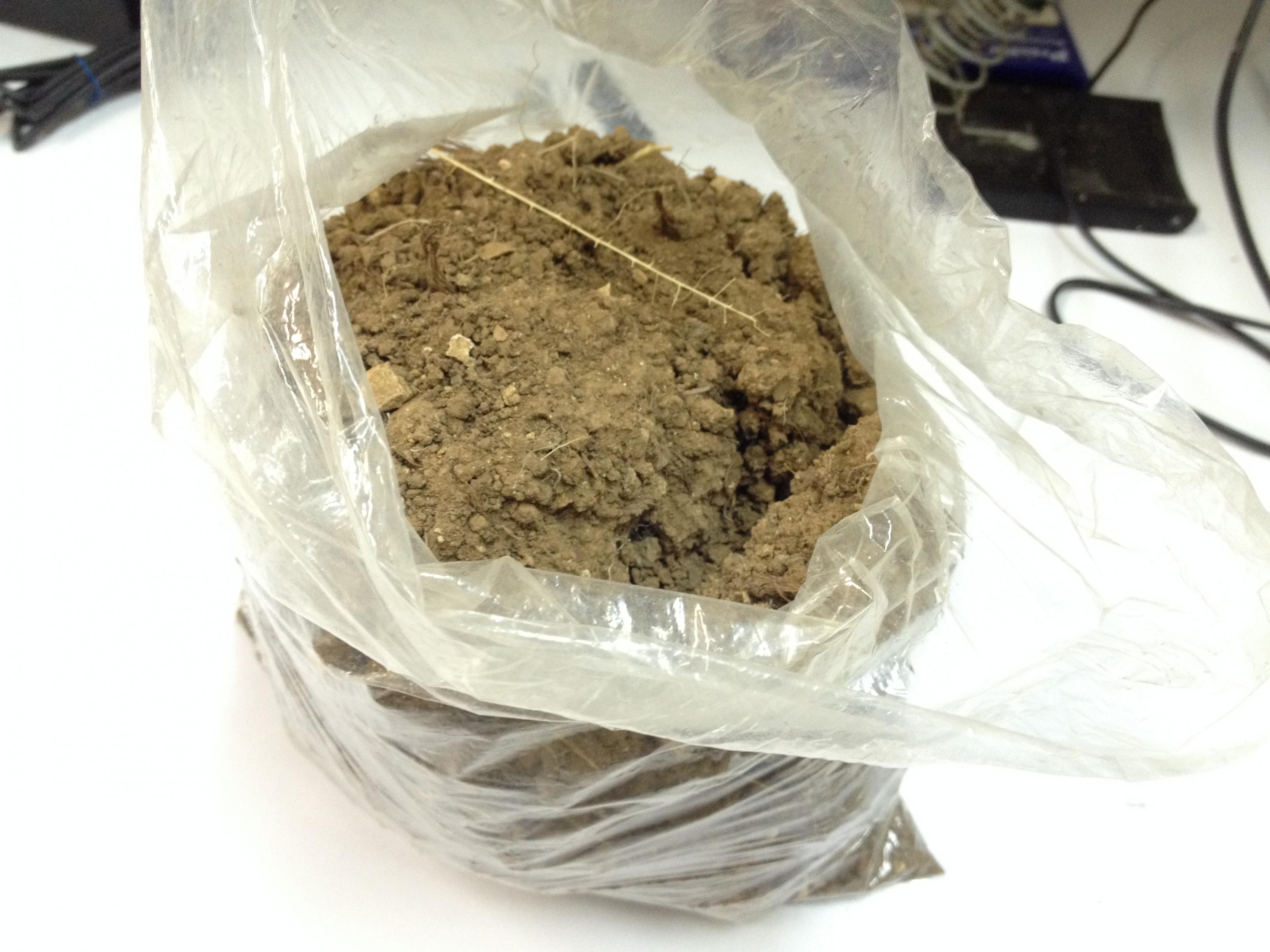

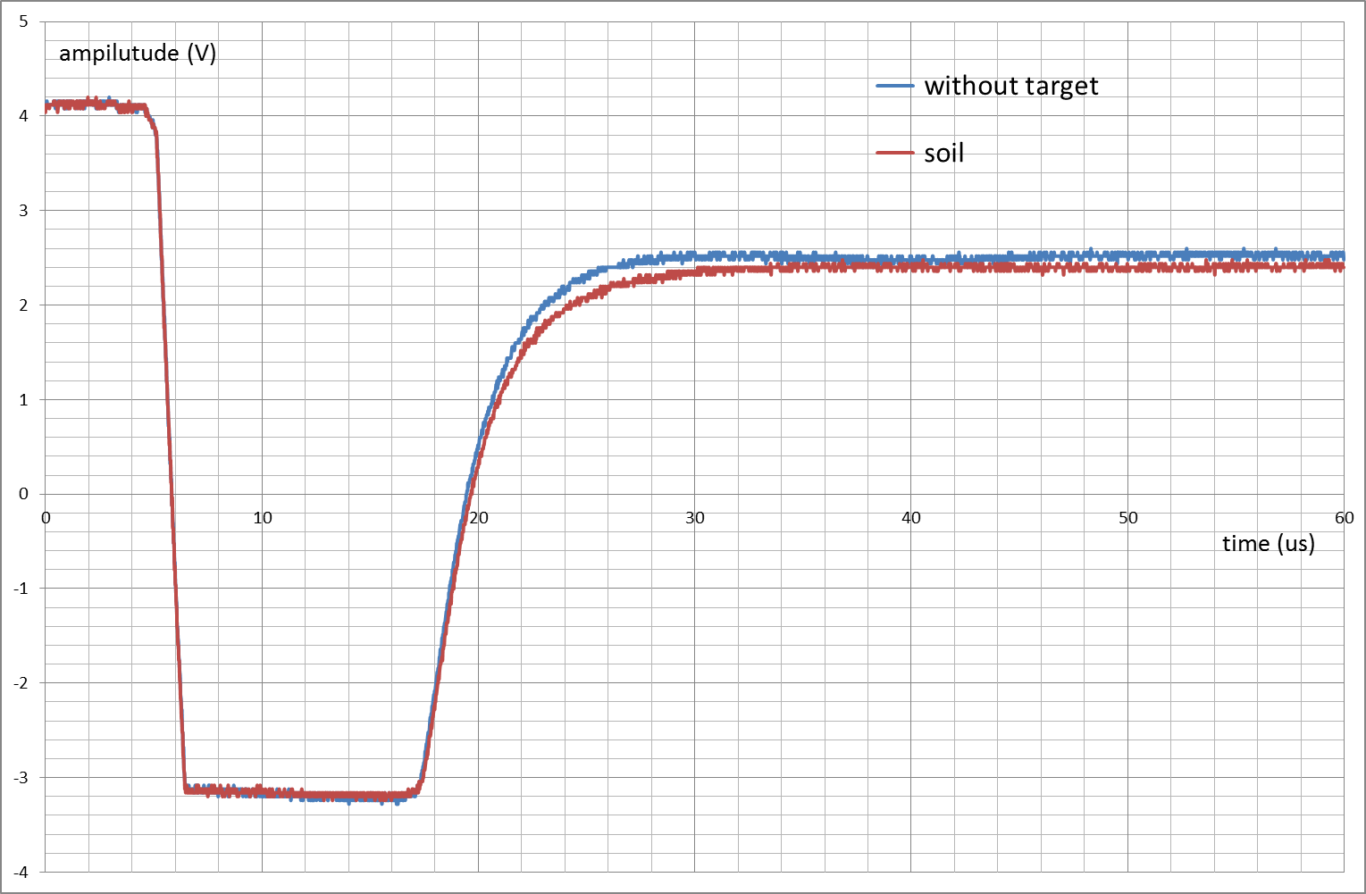

i did some measurements to compare the soil response with some other targets which are a bag of soil
a thin aluminum foil and an iron screw

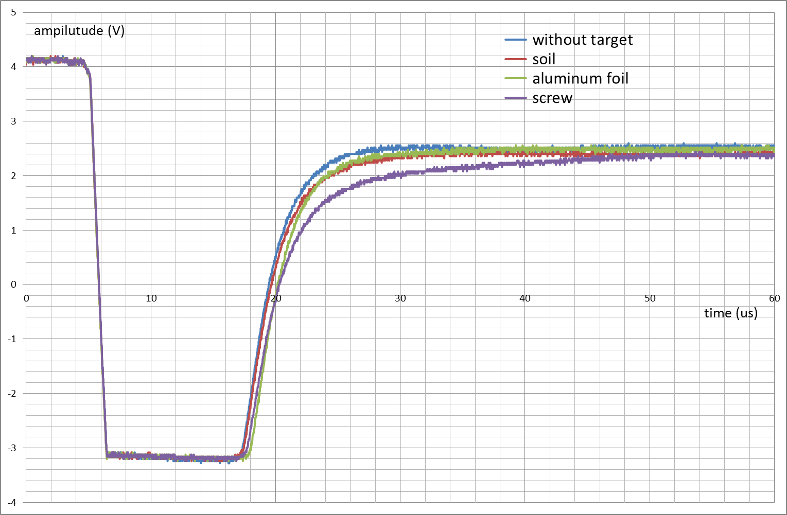

i plotted the preamp output for the three targets when they were laid on the coil and i got this charts:

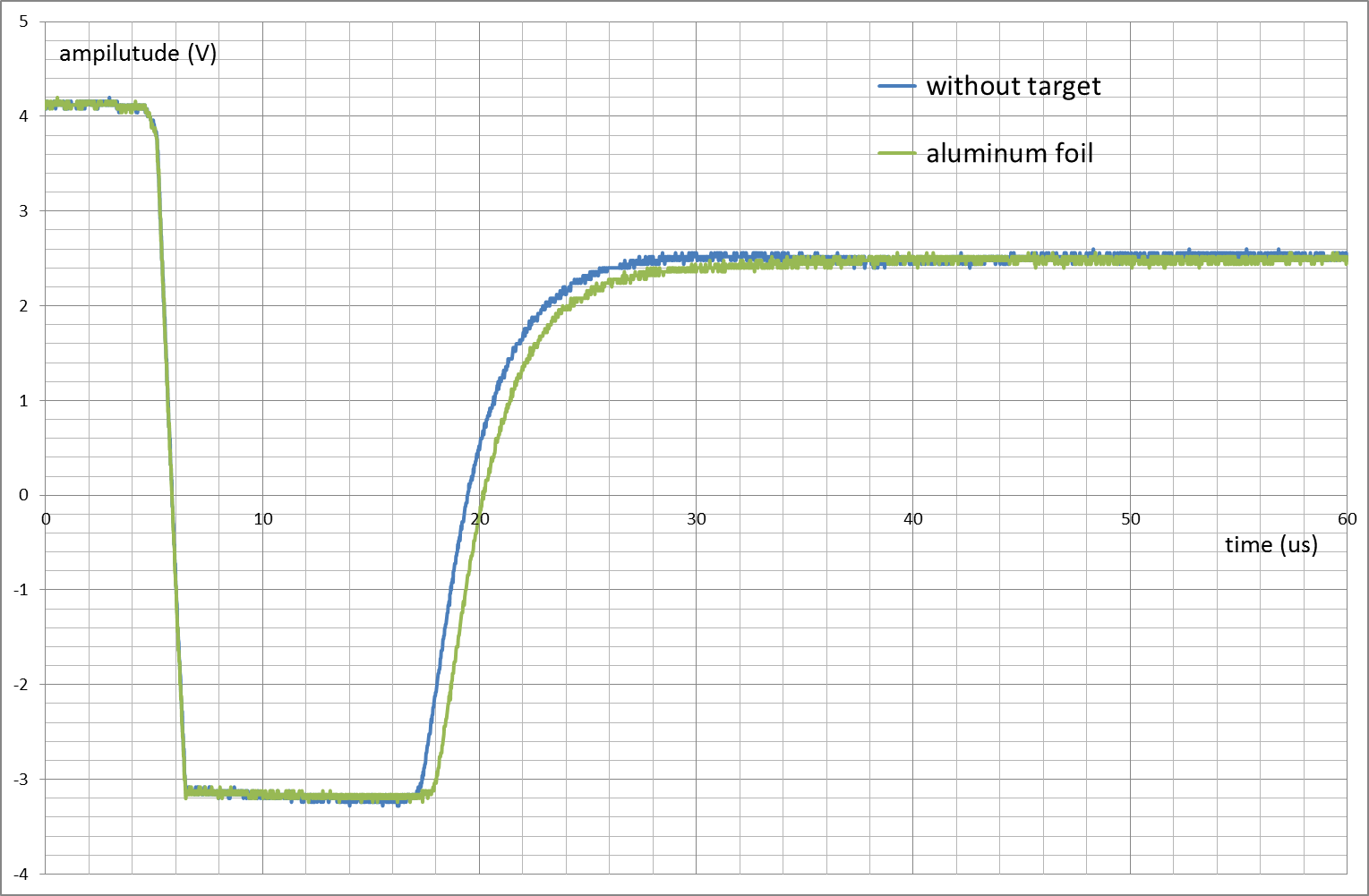

we could see that the aluminum foil as expected has a short TC, practically i could reject it totally with sample delay less than 40us

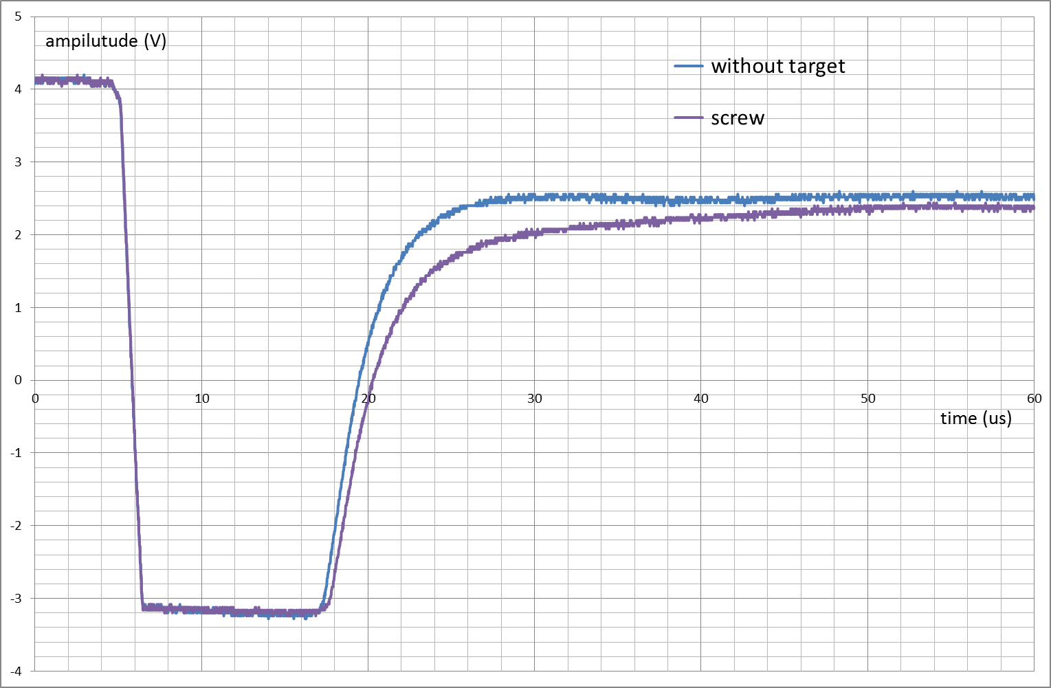

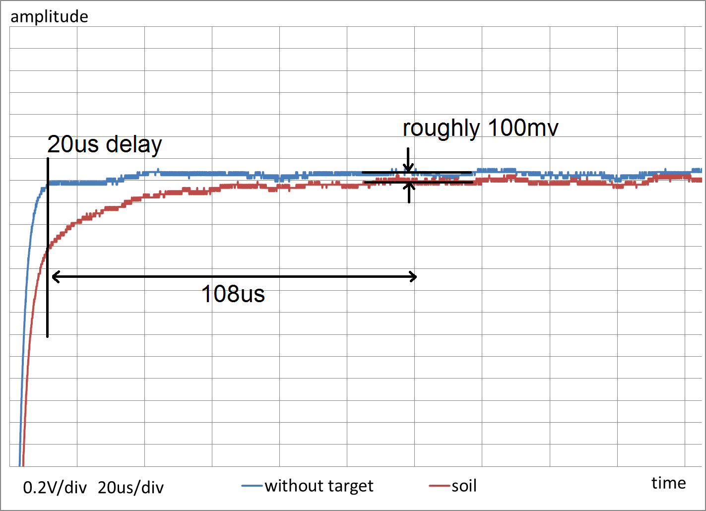

the iron screw has a longer TC as well the soil which TC seems to be very long (i forget to plot the soil response with a longer time sorry for that maybe i ll do later)
i think that clarify a lot and explains why i was sensing the soil even with long sample time delay
here the sampling data for who is interested https://drive.google.com/open?id=0B1...W5iWDctTEw3Wlk
