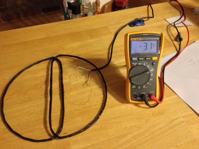

    I'm in the process of trying to build a coil for my TGSL. I wound two coils that ended up with the following specs after binding, superglue and electrical tape:
    TX Coil:
    99 turns of AWG 30
    5.80 mH
    22.4 ohms
    14.85 Khz when connected to oscillator
    RX Coil:
    104 turns of AWG 30
    6.40 mH
    23.9 ohms
    14.14 kHz when connected to oscillator
    These are off spec with dfbowers guide, but I was hoping they still might work.

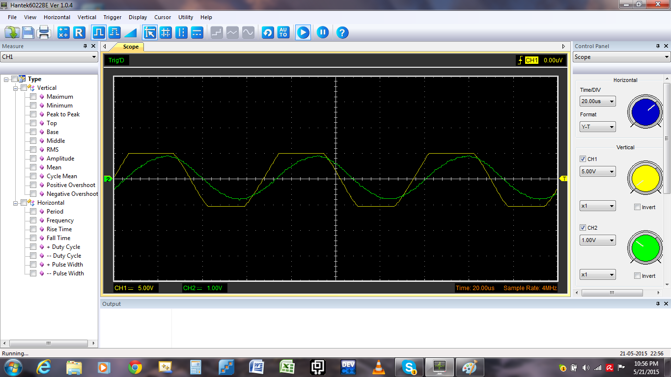

    But when I did that, the phases of J1-1 (TX) and U101 Pin 7 were separated by a lot more than the 20 degrees lag recommended by the guide:
    So I probably know the answer to this question, but I'll ask it any way. Are my coils enough off spec to cause the separation between phases shown in the scope screen shot?

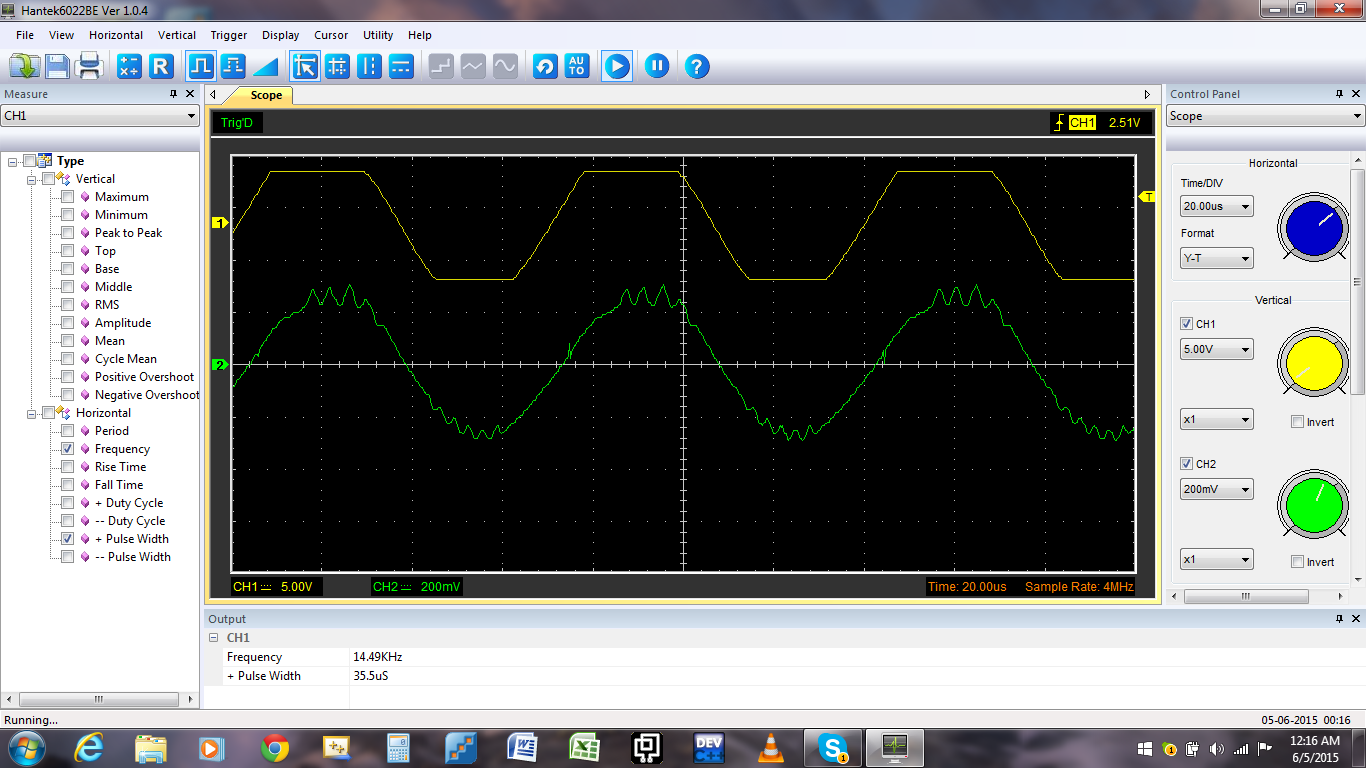

        After reversing the leads on the RX coil (duh), I got this phase relationship between TX and RX.
        This is much better. RX lags TX by about 6us or about 32 degrees.

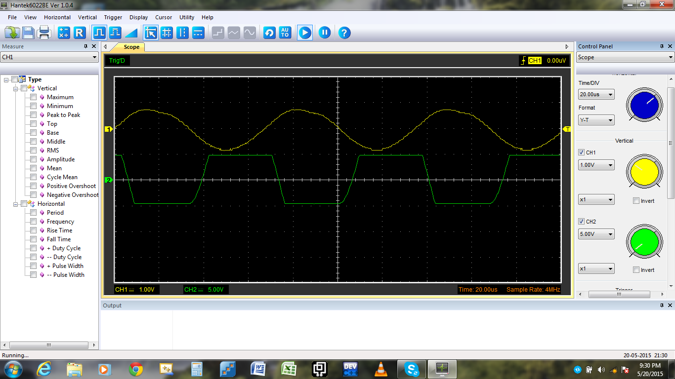

          I was able to overlap the coils to get the proper phase relationship with RX lagging TX by 20 degrees (4us):
          (Yellow is TX, Green is RX)

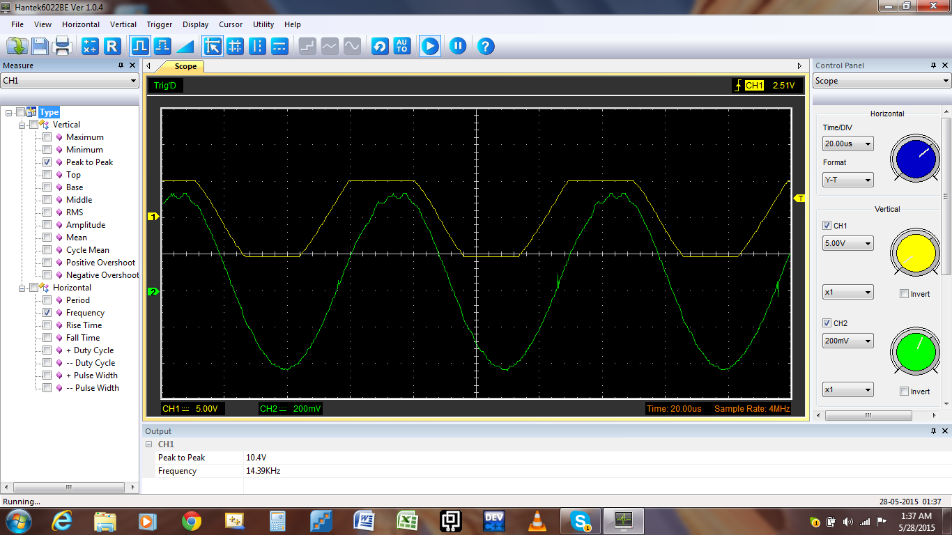

          And the "null phase" (U101 pin 7 and TR5 gate) seems correct:
          I am able to reject a ferrite rod with the ground balance and the discriminating circuit works properly.

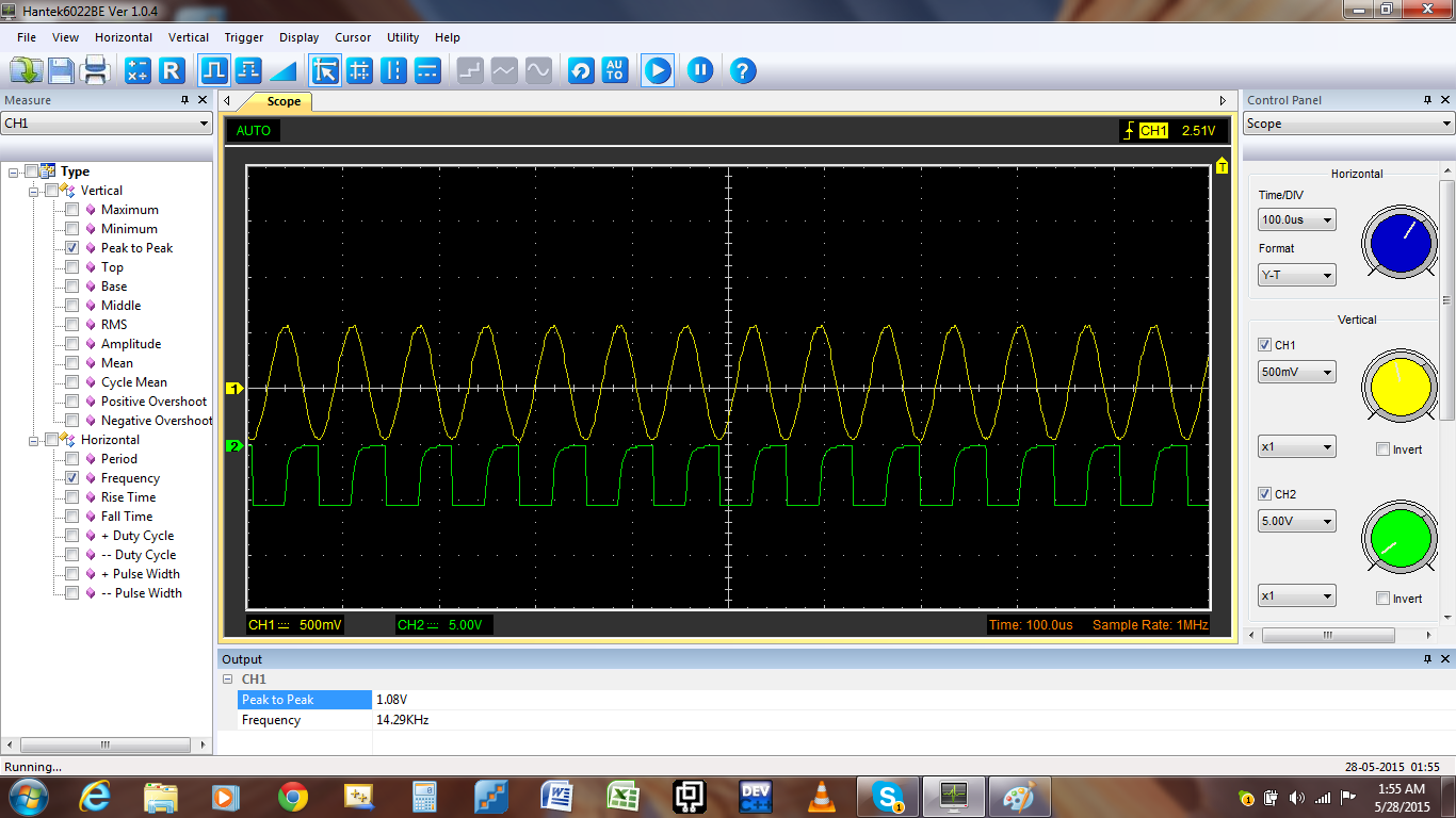

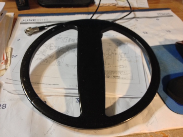

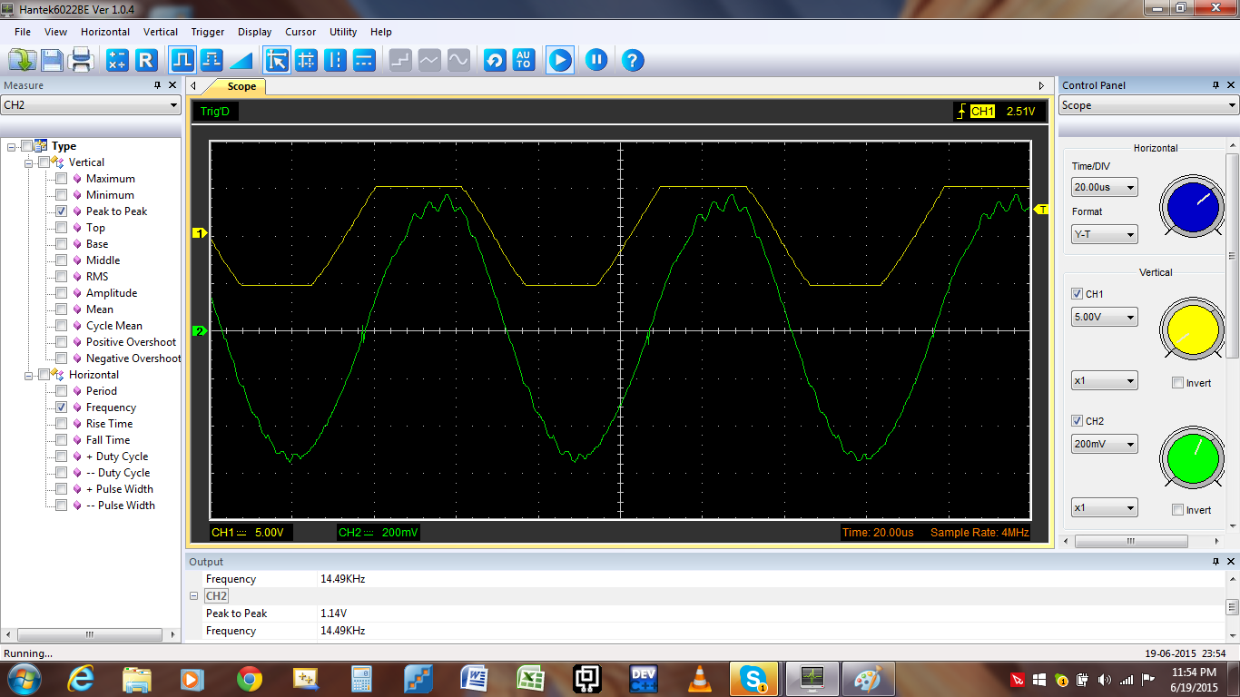

                    Null change after potting
                    I potted the coils using MG 832B. I did one pour, rather than multiple pours.
                    Below are screenshots of the null phase relationship when the coils were only hot-glued in the housing and after the coils were potted.
                    I have also attached a photo of the bottom of the coil after potting.
                    The null voltage increased to about 1.15 volts from the previous 400mV. However, the phase relationship remained the same.
                    The depth of the detector may have actually increased slightly.
                    So, it looks like the null phase relationship did not change enough after potting to affect the overall operation of the detector.
