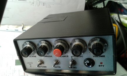

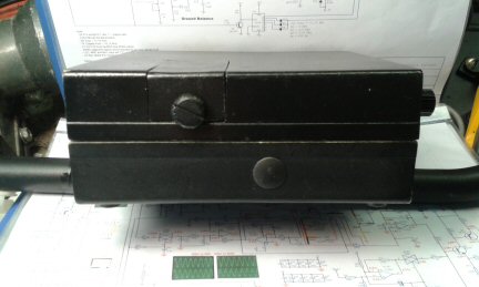

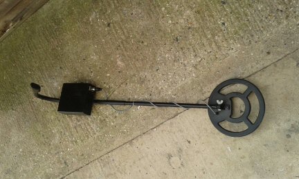

My completed UMaxII (on vero etc) With a nod to the TGSL project

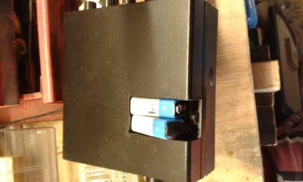

    Batty compartment holds a spare too. Easy to get at in the field

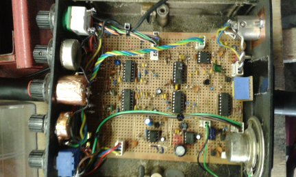

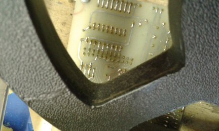

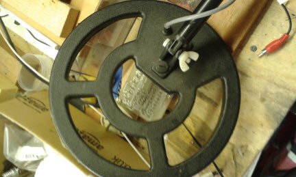

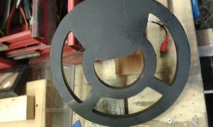

    Coil built into a cover. ABS sheet to close it. 'Weld' with a thick mix of ABS shavings and MEK.
    [ATTACH]35537[/ATTACH]
    Where did you get the bracket for the coil shell where the bottom stem attaches?
      Aha! That is a clamp thingy used to secure a boat awning. I found them on Ebay (or at a Chandlers) for about 2.50 each. All nylon and they are easy to tap - just screw the bolt you want to use first (ie a metal one first). It is secured with those plastic thingys that join kitchen units together - - NOT rthe type witjh a metal screw. The stem etc came from an old £5.00 punt on Ebay (70's BFO broken).
        Took a while to find it ...
        http://www.yachtchandlers.co.uk/acat...-NYC13754.html
        75p a pop!!Fits most poles

            Look nice.
            What are dimensions (between ears in first line)?
              Look nice.
              Width for pole end is 9mm. Just ordered four more. BTW I use nylon nuts and bolts from Ebay --way cheaper than so called metal detector coil bolts etc.
