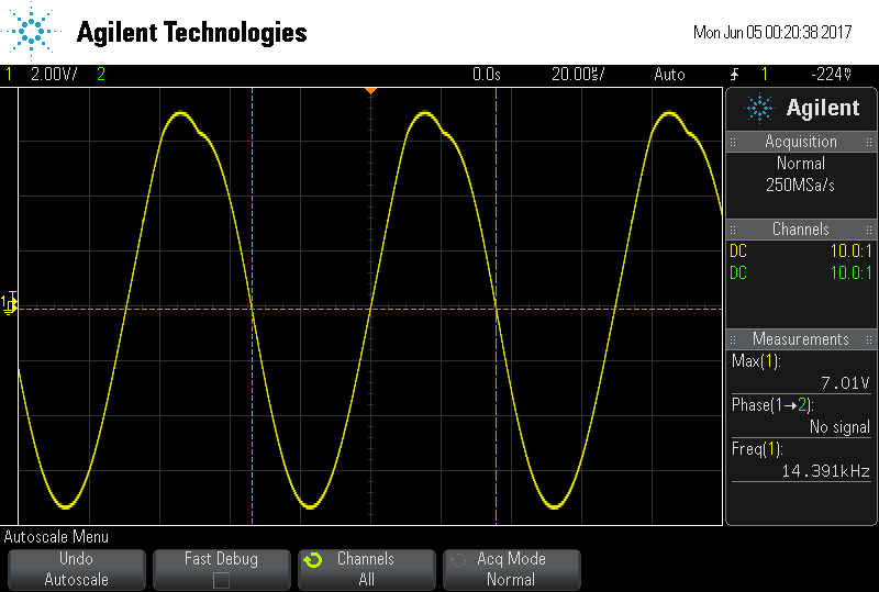

    heres my tx signal:

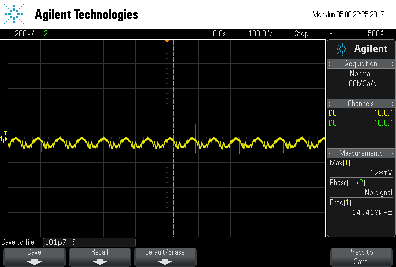

    and heres U101a, pin 7:

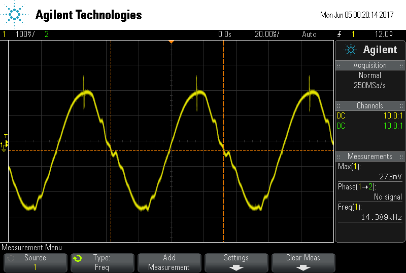

    its a really weak signal (could be correct) but it has those spikes that reach twice as high voltage as the rest of the signal. any idea what is causing that?
    when i measure directly at rx:
    it has similar spikes and its also a relativly weak signal, but maybe this is as it should be.
    now to the issues, when i was trying to null the coil (by making a difference of 20 degrees between tx and U101a, pin 7) they were following each other, so i can adjust it a bit but it stays around 60 degrees if i remember correctly (forgot to take an image of it). how is it that they are following each other? and do the other images look correct?

    Do you have O Scope in Auto Trigger ? Trigger off the Tx signal .
      Hello. Try to null your coils with the GEB pot in middle position that will automatically give you the 20 degrees phase shift between TX and RX than move Tx to achive the best null. Also ground your cable shielding and pot's too, its important! While nullind sens at minimum disc off and Geb at middle position.

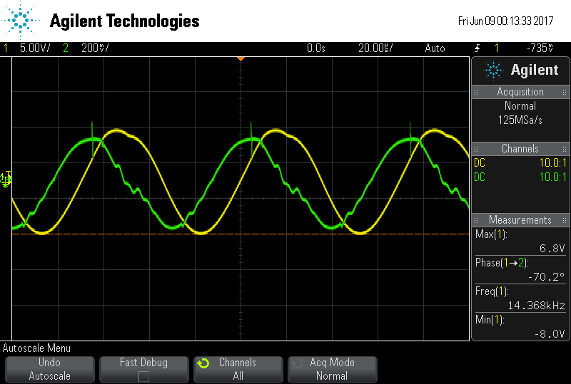

        i had the coils losely attached to a casing but decided to unattatch them to make the nulling easier, and i noticed that despite moving the coils away or closer together, they still have the same difference in phase. when they were moving earlier and "following each other" it was because i was changing the shape of the coils a bit.
        i set the GEB pot to middle and sens at minimum, tried disc off/on but nothing really changed. this is weird cause i remember that before i took a break with it this winter, i remember that the position of the coils were affecting the difference in phase between rx and tx, but when i move them now, nothing happens.
        looks like this regardless of how i position the coils, or how i turn GEB:
        tx lagging 70 degrees after rx.
          The problem must be with the coils. Tx coil has to be in opposite direction(winding) than Rx coil. If you have a good PCB than you must search the problem in your coils. Try to swap your Rx coil relative to Tx maybe that way you can get proper phase shift. Good luck!
            Try this way maybe you can make it work.
              thats how i have it now. but i found the fault, or at least one of them! the connector from coil to pcb didnt seem to connect properly so i changed it. now it works but it works very badly. getting only 10 cm on pliers and 1-2 cm on a silver chain. even a pretty big steel rod used for mounting a bicyle saddle gives only at most 15cm.
