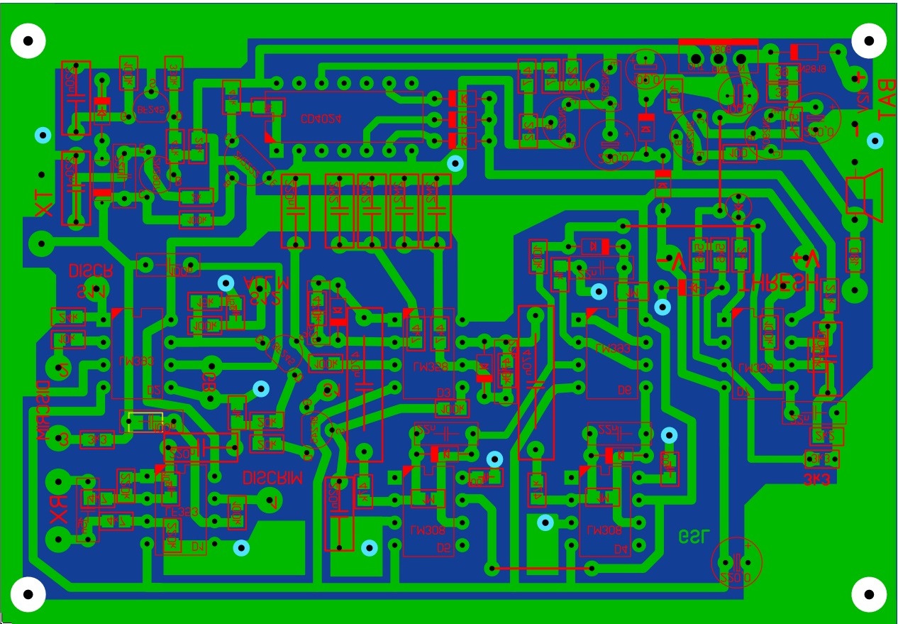

    Hi BKY1337, I attempted to shrink the TGSL in Sprint layout to 100mm x 100mm. I just posted today asking people to look it over to make sure I didn't break anything with my changes. If I get some people to confirm that it looks good then I'll post the gerber files and sprint layout so it can be used on the pcb printing sites.
    The photo is hard to check. To make the check correctly, you need the schemе under which the file and the Sprint layot file are made. You print the scheme and put it on the table in front of the monitor. On the monitor, open the file on the board. You use the "Connections" function and connect all the points that are shown in the file to a yellow line. Then you use the "Test" function to make it possible to trace all the elements that are connected to a each line.
    This is how the check is done. It takes a lot of time and it does not take a picture if the scheme is not well known to you.
      Is there an option in sprint layout to mirror the green copper layer?
      I found an option to load a background image as template, this is very useful.
      I made a screenshot and mirrored it with paint and then loaded it as background image.
      I will use this Layout: Click image for larger version
      This picture is mirrored^^
        I will use this Layout: [ATTACH]42117[/ATTACH]
        1. CTRL+A=select all
        2.Right mouse button on screen
        3.You select a function "Mirror horizontall" and press it.
        4. You get this:
          Thank You! Now i only need to replace the solder pads with holes.
          Btw.: Do you have a schematic or partslist for this layout?

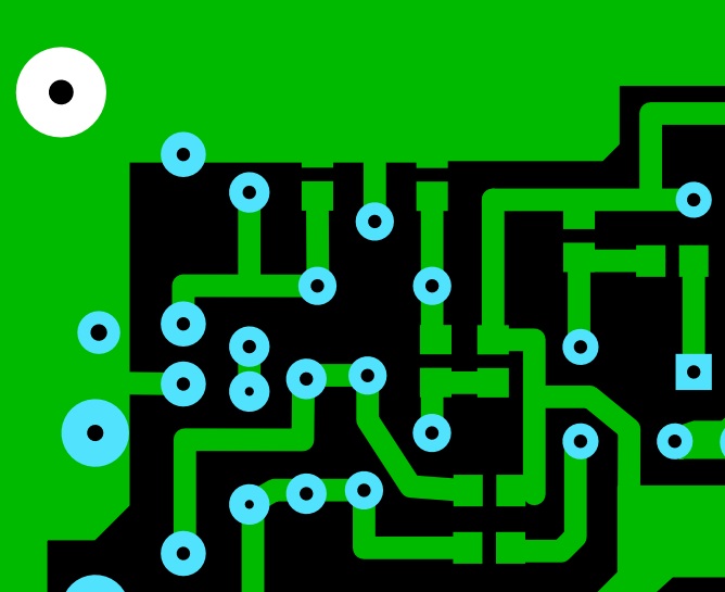

            It is easy!
            1. Highlight /Press/ a layer C1.
            2. Ctrl+A=sellect all
            3. Go to ""Pad""
            4. Select and press ""Through pad""
            5. You are ready
              This does only work for the THT holes.
                Are you sure? Look at the board more carefully!
                  Use the TEST function
                    The scheme is here:
                    http://www.md4u.ru/download/file.php?id=3541
                      This is what i got! Thank you Toros for the schematic!
