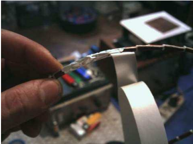

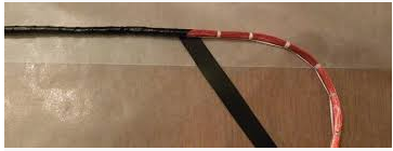

    Good morning all !!
    here I would like to know, once the reel is done,
    should I wrap it in (1) first with electrical tape?
    then after (2) with aluminum?
    or the opposite ?
ID:	371458Click image for larger version
    no idea.
    I have tried both way and many more
    everything I tried failed
    One was okay for a bit but failed a few months later
    graphite and PVA glue is fine though.
    think ? it might depend on your aluminium and tap wire as aluminium oxide is an insulator. Or is there some reaction between the tin on the wire and the aluminium.
      I always first wrap with electrical tape.
      Then the shield then another layer of electrical tape.
      The idea is to ensure the wires in the coil do not move and found that it is better if the wires are bound with an adhesive before wrapping. I have been impregnating the coils with polyurethane (wood finish) to produce a rigid coil.
      The first TGSL coil I build I shielded with aluminum foil it worked but did not have the distance others got.
      Second TGSL coil I shielded with a graphite/polyurethane mixture and used a very thin bare tinned wire (32ga) wraps with a wide spacing as a drain in the graphite.
      Second coil worked better.
