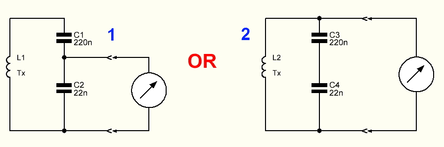

                      Hello! I haven't done TGSL for a long time and forgot. How to properly connect TX to frequency counter to tune to the frequency? Thank you!
                        I use a scope and connect as in #2, across the coil.
                        If the probe, freq counter or scope input, is high enough impedance it will not load the TX oscillator or add any significant C.
                          Thank you so much!
