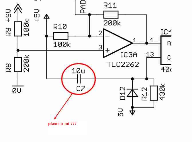

    Hello,
    Can somebody tell me what is the value of C7 ( 10u ??? )
    Is it polarised or not ???
    https://www.geotech1.com/thuntings/a...ntid=619&stc=1

    The value of C7 is shown as 10 microfarad, and the left-hand side of the capacitor will be the positive terminal.
    A tantalum should be ok.
      a electrolytcapacitor is better.
      I have problems with a tantalcapaciter.
      With a electrolytcapacitor works my bandido fine.
      The negative Pin to the Diode.
      Look at my Layout:
      www.hamkom.de/Bandido_Paul-Panzer_03-2006.rar
      paulpanzer

        You're probably correct, although I'm not sure why a tantalum should be inferior in this application to an electrolytic. Anyway, I bow to your superior knowledge, as you've clearly built a copy of this machine.
        By the way, I already saw your Bandido schematics and layout on another thread. This is some good work you have done with the Eagle s/w.
          Thank you for your help
          Greg
