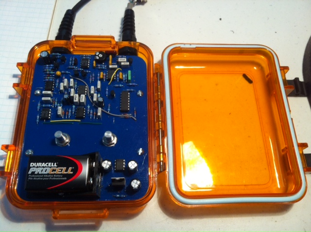

Project: Goldfish
    Here is a picture of the fully assembled PCB in the enclosure. I have a 10" DD coil made by dfbowers on this forum that I will permanently attach. I also still need to finish my headphones which will also be permanently attached through the water-tight connectors.

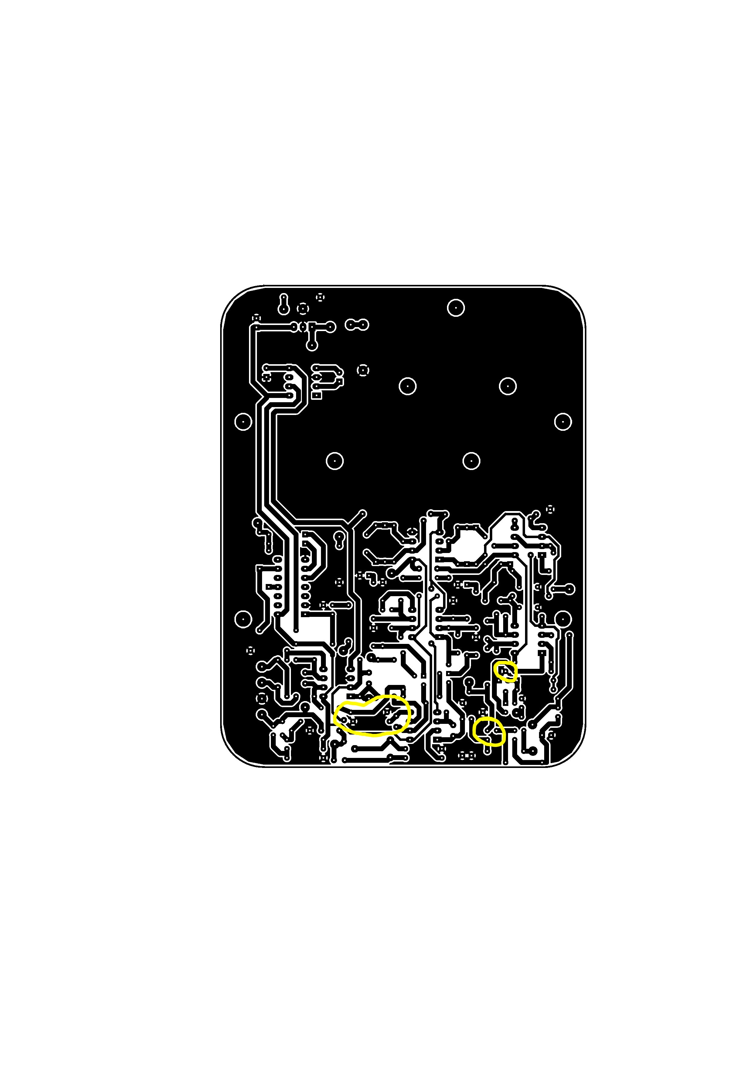

        See if this is everything you need.
        Rodney
          hello merc
          this is that what i need thanks
            Beware of isolated grounds. I think I had to add some jumpers to at least two areas to make a ground connection.
            Merc
              hello merc
              did you find these points already and did your machine run
              i etched pcb last weekend, tomorrow i will drill the holes and silver coat the copper
              maybe i can place first components this weekend
                Please keep in mind that I did not etch my boards. They were machine milled. I had a few cut grounds due to the width of my engraving tool. The black and white image I posted was exported for your use so I never actually made a board with it. I have marked some trouble spots. Please check your grounds carefully with a meter before populating your board.

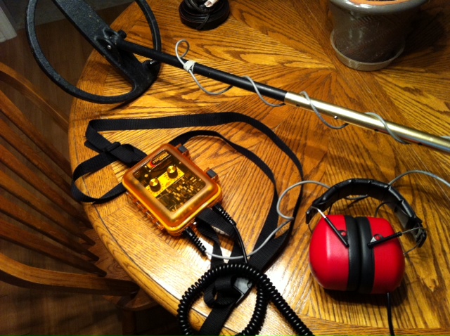

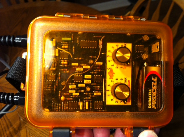

                  I think I have finally finished this project. Hopefully I will test it in the water later this summer. Here are some pictures of the Goldfish fully assembled.
                  Merc
                    Had any luck?
                      Not much. I've only been out once with the Goldfish. I went to a freshwater beach about 50 miles away. As soon as I got there I sat my stuff down and saw gold in the sand. It was a small 14Kt gold ring. It was bent and not in very good shape. I searched in the water a bit and found targets but could not seem to scoop them up. I was using a long handled scoop I made from PVC pipe. I was only able to scoop up one target, a pull tab. I did find a few coins on the beach but the only gold was found by accident.
                      Merc
                        Thats a nice project Merc
                          I know it has been a while, how did you make the headphones waterproof? To what depth do you think they will stay waterproof?
                            I did not attempt to make them waterproof. I did use mylar speakers so that if they did get wet, I don't think any permanent damage would be done.
