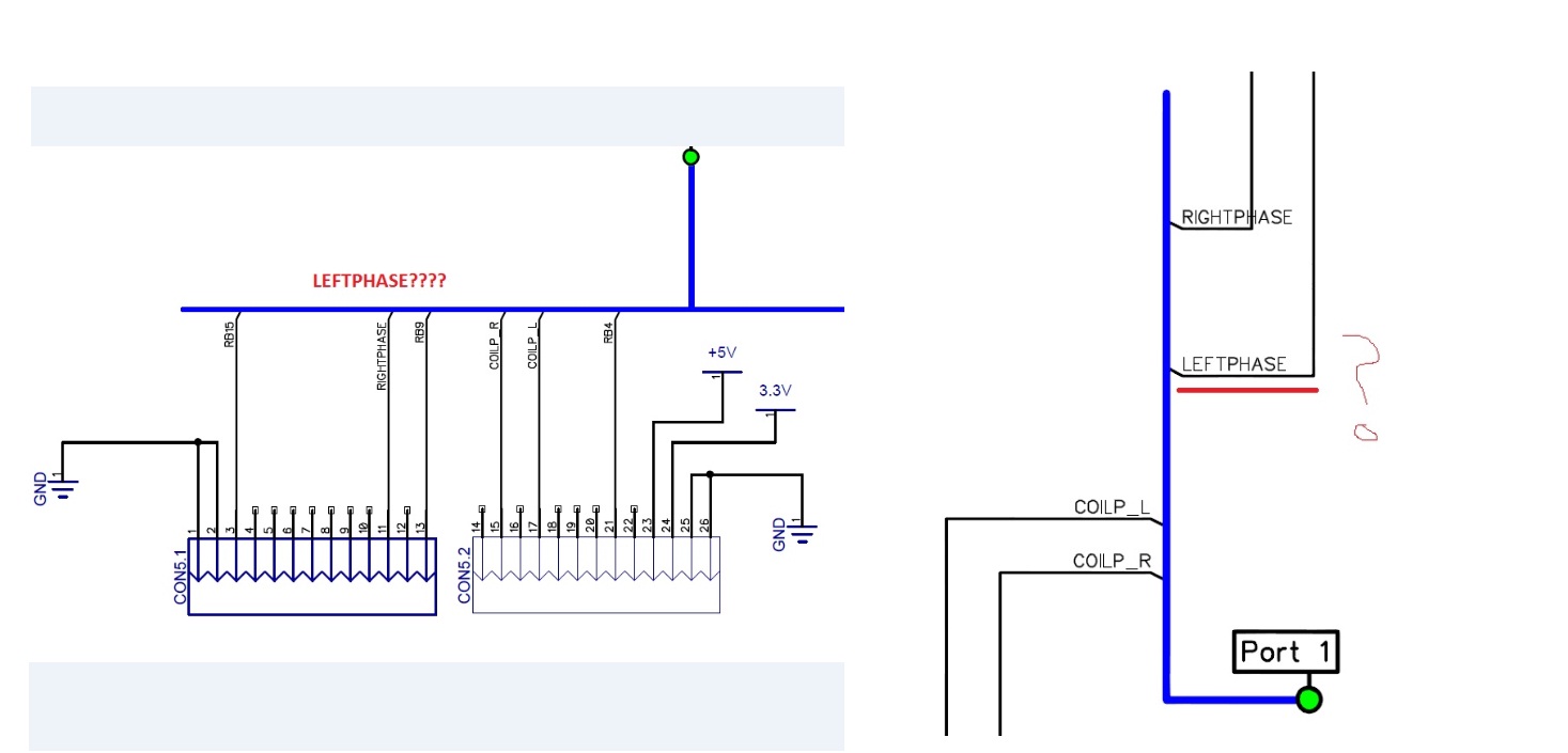

    Here is the complete circuit diagram of the SPI-MX 3b

    I finally got a chance to look this over. I'm curious about your TX driver, appears you are using cascoded IRF740's for the P-side switch. Why not just use a PMOS device?
      P-mos, maybe even better ...
      Hi Carl,
      yes good point.. it would be even simpler to have P type mosfets on the high side.
      As you know, a pmos of a given voltage max (400V) usually have much higher on resistance (7 ohms instead of 0.550 Ohms for example).
      I used the N channel mosfets because of that.. those two in series should have a combined resistance of 1 ohms.
      But you make me think
      The whole purpose of having a clockwise (cw) pulse and counter clockwise (ccw) pulse is to cancel out noise.
      The pulses have to be identical, and the topside resistance has to be the same (left resistance should be equal to right resistance).
      The lower the better.
      (Compared to 3 ohm coil resistance, 1 ohm mosfet is large)
      Because no two mosfets are the same, there is a variation between the resistance of the left side and the resistance of the right side, which will result in slightly unbalanced pulses meaning less noise cancellation.
      Perhaps an ultra low ON resistance P-mosfet (with 30V flyback voltage), in series with a DIODE,.. will not only make a simpler circuit, but result in much more identical ccw and cw pulses.. resulting in closer to perfect noise cancellation.
      I will try this and see if it works, and perhaps improves (the already good) performance (a process of a few weeks)
      Then I will update the circuit.
      Please let me know if you have a better suggestion..

          Hi Tec
          Congratulations on the project!
          I look little on schematic and i think you have one error.
          As you can see on picture on connector 5.1 leftphase don't exist, but it is used in next part of schematic.

            Thanks Yes, the connector is not needed it is just used as test points on the PCB.
            The left and right signal do go to the correct place on the the circuit.
            The next revision I will remove the connector to simplify the diagram.

                A diode adds a voltage drop, but the coil need to be tied / referenced to ground as it discharges. Because of the way the signal is measured on the comparators. (referenced to ground), can't have a voltage drop caused by the diode. I just remembered why can't use diodes.
                no voltage drop allowed. hence the convoluted mosfet configuration.
                lower on-resistance mosfets would be an improvement.
