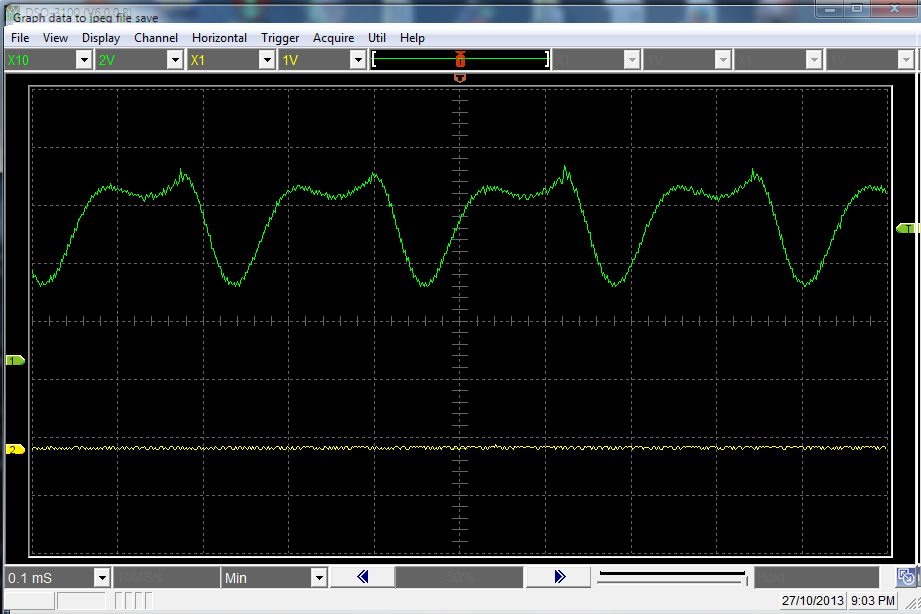

            TWO FREQUENCIES AT ONCE
            I was hoping to switch between two frequencies as a way of cancelling out mineralization...
            And accidentally got the oscillator to oscillate at two frequencies at once:
            Frequency1 and Frequency2 (3rd harmonic)... never thought of that.
            Could be useful to someone..

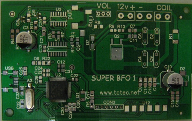

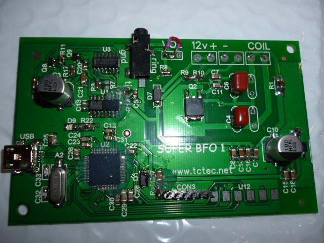

              Printed Circuit boards
              I have designed some circuit boards and assembled one.
              There were a few minor changes, but the boards work.
              I will do some more testing and then post the final schematic.
              I intend to sell the assembled boards ~$35.
              Summary of the 'Super BFO':
              It's a resonant oscillator using a single mono coil.
              Similar to a traditional BFO detector.
              It measure tiny frequency changes.
              It has a USB port it can be plugged into a PC and the frequency can be displayed (to one part in 80 million)
              It is useful for creating a BFO-Style ('Super BFO') detector, with different coil shapes and sizes.
              Also can make an excellent pinpointer (small coil).
              The audio is varying frequency and volume like high-end detectors.
              Fe targets decreases the frequency, Non-Fe increases the frequency.
              Firmware can be updated via USB.
              It uses a PIC32
              Tec

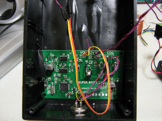

                Hi Tec
                sounds good please keep us informed, and I would like a board thanks.
                What value of coil inductance are you useing ? my intention would be to use this at the beach.
                  Good work from you Tec again. Pro board, very nice. Congratulations.
                  Why you avoid to count on third harmonic? It should be more sensitive.
                    What kind of depths are you getting in the field?
                      Thanks to Tec, my pre made pcb arrived today.
                      Looks a good job, now just have to figure which is the correct coil to make.
                      6666
                        I have done a couple of quick tests only on the bench with a 400uH unshielded 25cm mono coil connected with a 1 meter length of coax.
                        It works, loud audio, coil is a bit sensitive to my hand, but needs more precise testing.
