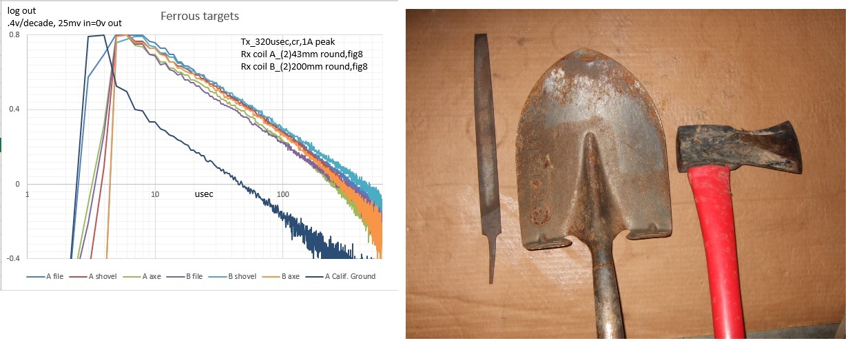

      Picture I posted awhile back. Ferrous targets decay straight line log-log in the beginning. Size can effect how long straight line log-log. The targets in picture decayed close to same slope as ground for over 100us.
        Iron targets have 2 responses: a magnetic response and an eddy response. Thinking in terms of VLF phase angle, a purely magnetic target will always exhibit a phase shift of 0-90 degrees and a pure eddy target will have a phase shift of 90-180 degrees. This is why some iron targets (like nails) with little eddy response end up in the ferrous region while those with a substantial eddy response (like washers) end up looking non-ferrous.
        In a PI, I suspect what you see early on is a magnetization effect akin to VRM. That is, the TX pulse magnetizes the target and during early RX the magnetization decays. The later slope would be the eddy decay.
