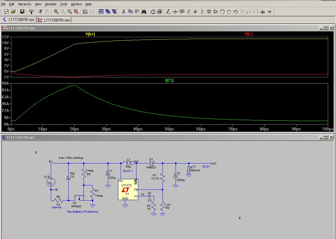

          • #50
            unrush current limiter needed
            Hello all -
            I might have weighed in on your discussion sooner but I received no email notification of any activity in this thread.
            I have not had time to read your contributions, but let me make this post, take a break, and then I'll see what I've been missing.
            My power supply would suffer from a large inrush current and resulting wear and tear on the input capacitors. I suppose that is a common problem - but I had been ignoring it and I can't do that.
            This potential problem came to my attention as I was working to create a new design using an LT1372 SMPS controller. SMD tantalum capacitors that I thought about using would probably not have a high degree of reliability, to say the least.
            The 99 amps input current shown here is only a simulated approximation, but if C1 would experience anything near to that amount of current maybe something should be done about it.
            Here is an idea for an inrush current limiter explained in Motorola AN1542:
            http://www.onsemi.com/pub_link/Collateral/AN1542-D.PDF
            After playing with this for a few days I think I have some pretty good values worked out for the circuit shown in figure 5A. We can knock the input current down to a less scary number.
            I think that my through hole power supply needs this 'IRL' incorporated. (I get tired of typing "inrush current limiter".) That will be a few days in the making, but I will show the upgraded schematic and simulation results here later this weekend, probably later today...
            Maybe it should be abbreviated as "ICL" instead of IRL?

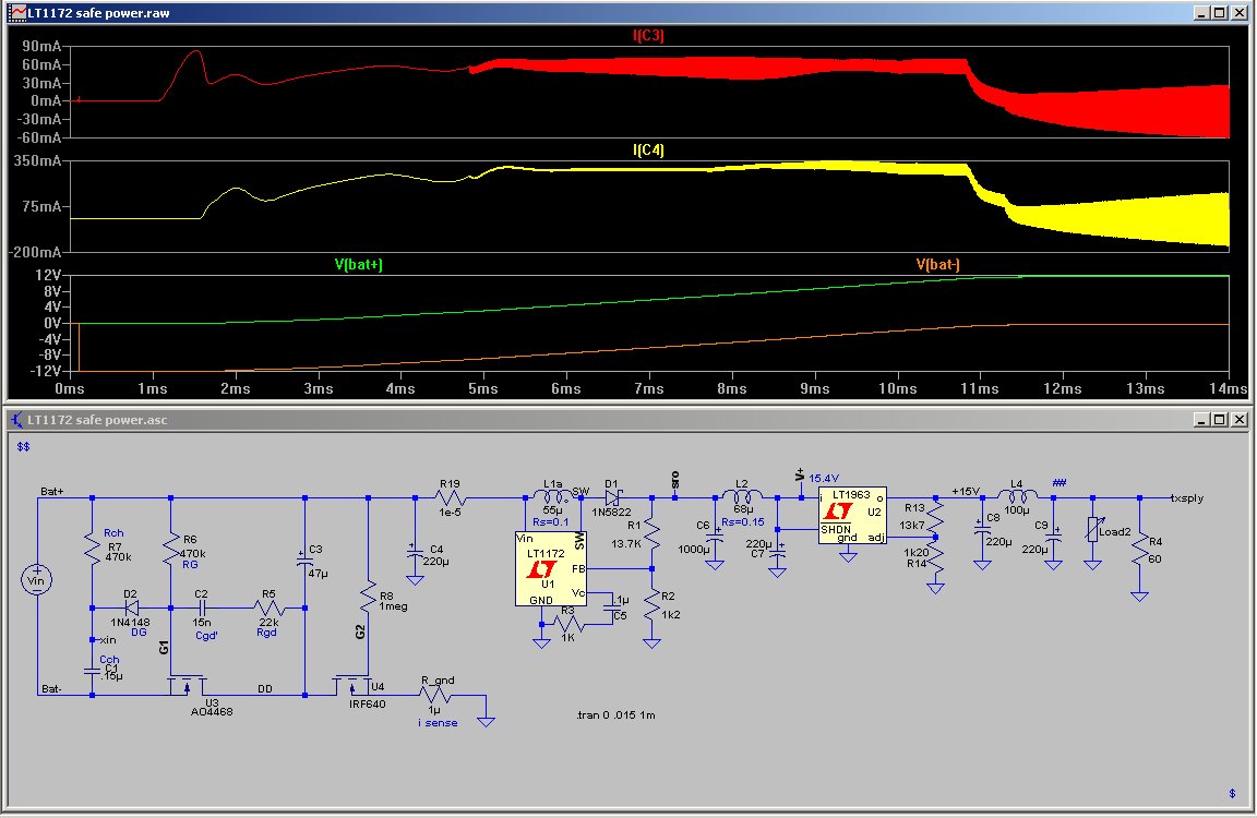

              • #52
                Here is how to add an inrush current limiter (hereafter referred to as ICL) to my through hole power supply. I tried, but was unable to combine the ICL and RBP (reverse battery protection) into a single FET circuit.
                The two FETs at the power input could be one of the dual FETS available from Vishay or Alpha-Omega, in the SO08 package. AO442 or Si4952, for instance. This is a through-hole project, using only a single sided board so SO08 would need to be mounted on the underside. Using another TO-220 device might be the easiest way to go.
                I looked for a way to use an extra winding on L1 that would provide a negative voltage and eliminate the need fot the negative voltage converter IC.
                I found that I could have a negative voltage, but if I drew more than only a few milliamps the voltage sagged dramatically. That was not what I was hoping for. I tried some different configurations but none of them made me very happy. That's strange because I simulated a negative converter with the LT1172 and added another winding, and was able to draw 50mA or so with no problem.
                You can see turn on at 100uS in the picture.
                edit:
                I forgot to mention -
                AO4468 is a single FET in the SO08. The RC component values I used in the simulation are tailored to that particular FET. If you use a different FET you might find that some of the RC values can be changed for better results, although, what I have here should work alright.
                An IRF640 would work, but with two FETs being in the ground path, I would prefer to use devices with lower Rds.
                I used the IRF640 in the RBP circuit here because I had trouble getting simulations to run with some of the other models I have.
