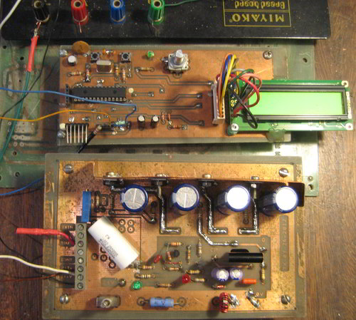

    Here is a peep at the TX board and the UNIPI board. I think we could make a single board with the PSU, the UNIPI and the TX board.
    The 4 Mosfets must be tied to the same heat-sink. As it is, it gets barely warm.

      yes i agree, and if some want something a lttle different im sure it will be able to be adapted in someway, and as you said earlier to someone on here this project will never be finished as in final which is what Geotech is all about.
      Maybe a good idea to use version numbers for those who get involved later on.
      Like your test setup tinker you have been busy.
      So now where do we go from here?

        Maybe a good way to proceed, would be to tackle the project at the different block simultaneously.
        We could look at the different options, discuss and suggest and come to a consensus of the version we want to execute. This will depend more on yourself than on me, because we are designing the detector for your specific purpose, namely, to walk the fields in the UK.

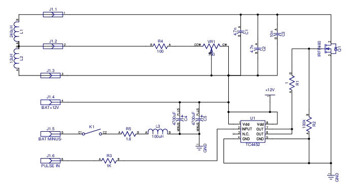

                      TINKERERS_TEM_TX_LP
                      Here is another little piece of the detector. A LP (for low power) TX board.
                      As I showed above, there is quite a difference in power between 12V and 30V TX. So this is the low power TX, running on 12V. Still capable of reaching very deep.
                      Enjoy
                      Tinkerer

                          The TEM-TX board the GG Group are working on with Tinkerer will have three switchable power levels and I hope to be making the new prototype boards in the next couple of weeks and Tony I have built three different audio stages for testing including the one suggested by satdaveuk.
                          Regards, Ian.
