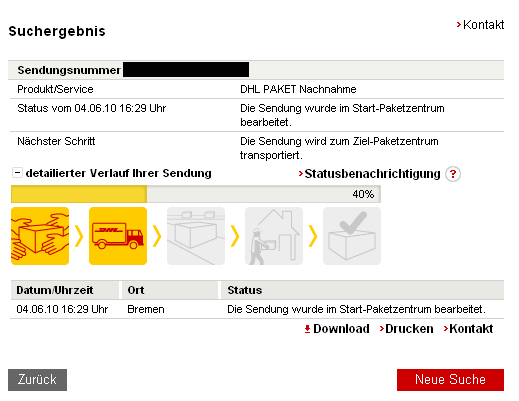

          • The package is on the way and will very likely arrive tomorrow.
            • Parts arrived today.

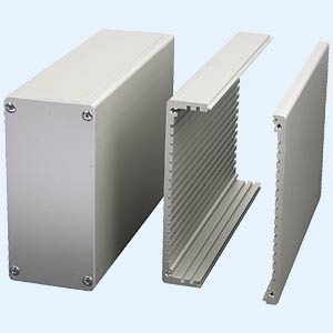

                          • With a high power detector, heat becomes a problem. Maybe a cast aluminium enclosure, of the type they use for automotive audio power amplifiers could be the solution.
                            These enclosures have external heat dissipation profiles.
                            It might also be useful to use 2 separate enclosures, one for the Power supply and TX circuit, the other one for the RX and controls.
                            Does anybody have some recommendations?
                            Tinkerer
                            • Case
                              Hi Tinkerer,
                              I have already ordered a modular ALU case for the IB-PI project (see below). One can combine different height. So the hole PCB will be a 160x100 mm bread board, which fits into the case.
                              Aziz
