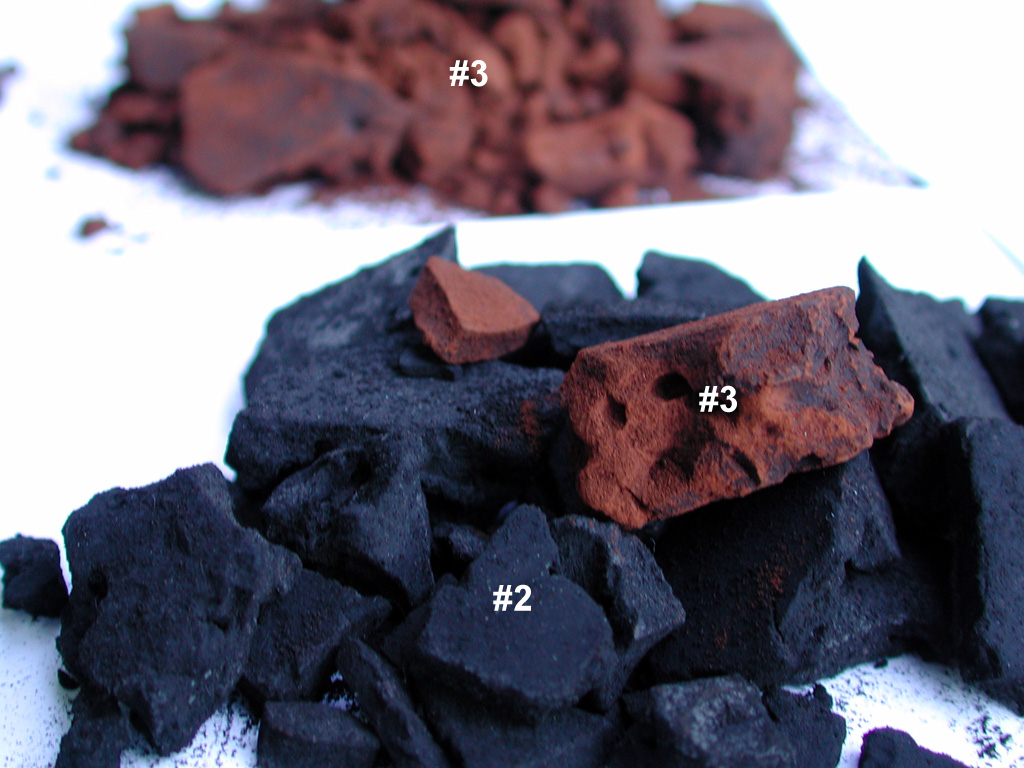

    Hi all,
    this is the result of converting green rust into maghemite.
    #2: Green Rust (not aged)
    #3: Maghemite converted from sample #2
    Sample #3 is most magnetic susceptible sample of my maghemites.

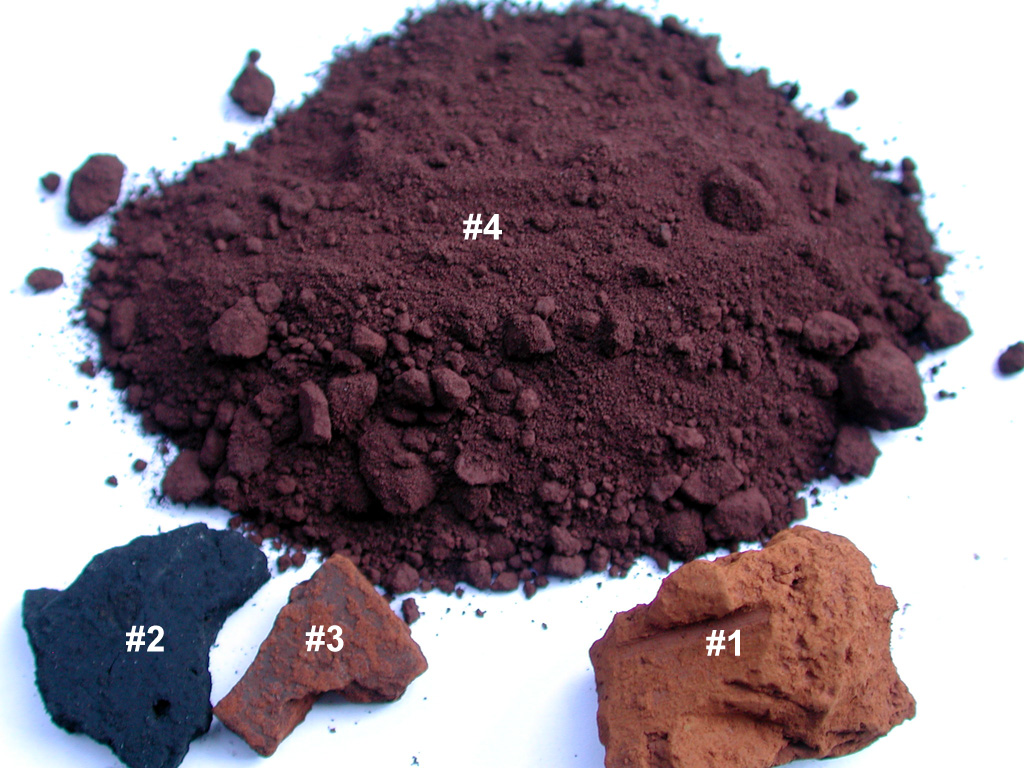

    More details.
    #1: First maghemite sample (out of aged green rust, notice: a different color)
    #4: Heated green rust above 300 °C -> hematite conversion from unstable maghemite occurs.
    This sample contains still maghemite and if I would heat it further, it would get more red and dark (more hematite). It has happened due to uneven heat application in a pot and cooker. The bottom of the pot had a much higher temperature (>300 °C).
    I have to reconvert this low susceptible sample using charcoal, some moisture and more heat back into maghemite.

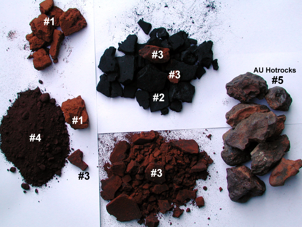

    Overview of the samples.

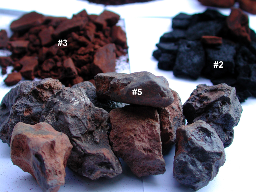

    #5: Some real Australian hotrocks.
    These hotrocks contain a lot of magnetite however.

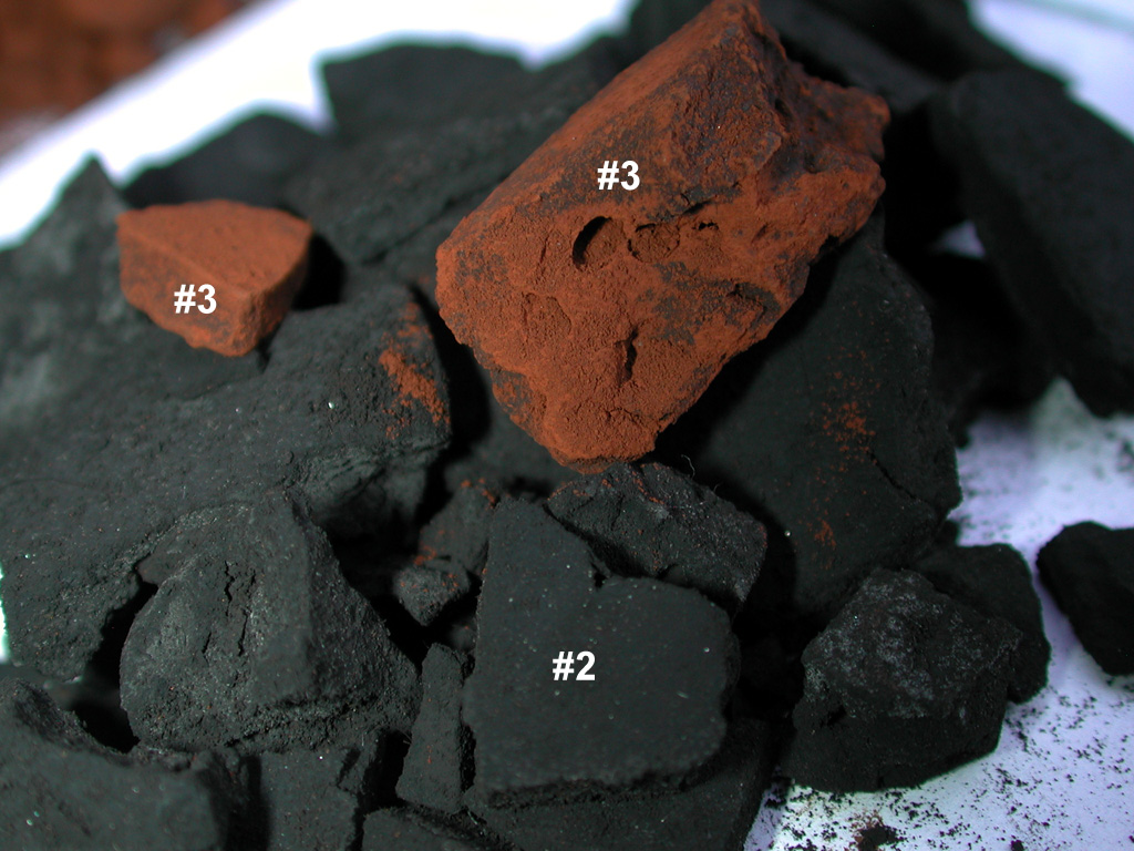

    More details.

      But this sample contains a much higher purity of maghemite and does not contain magnetite and other minerals.
