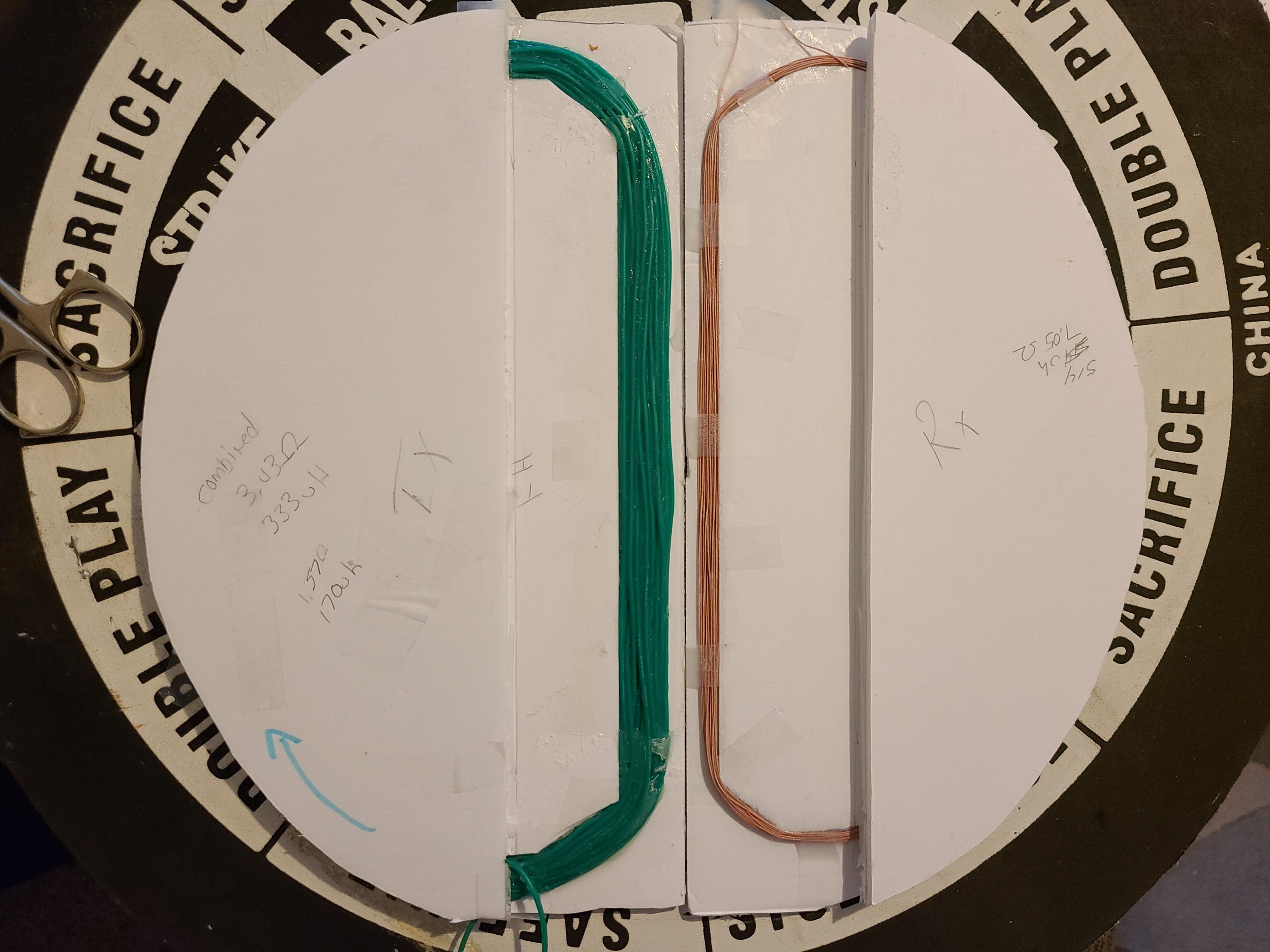

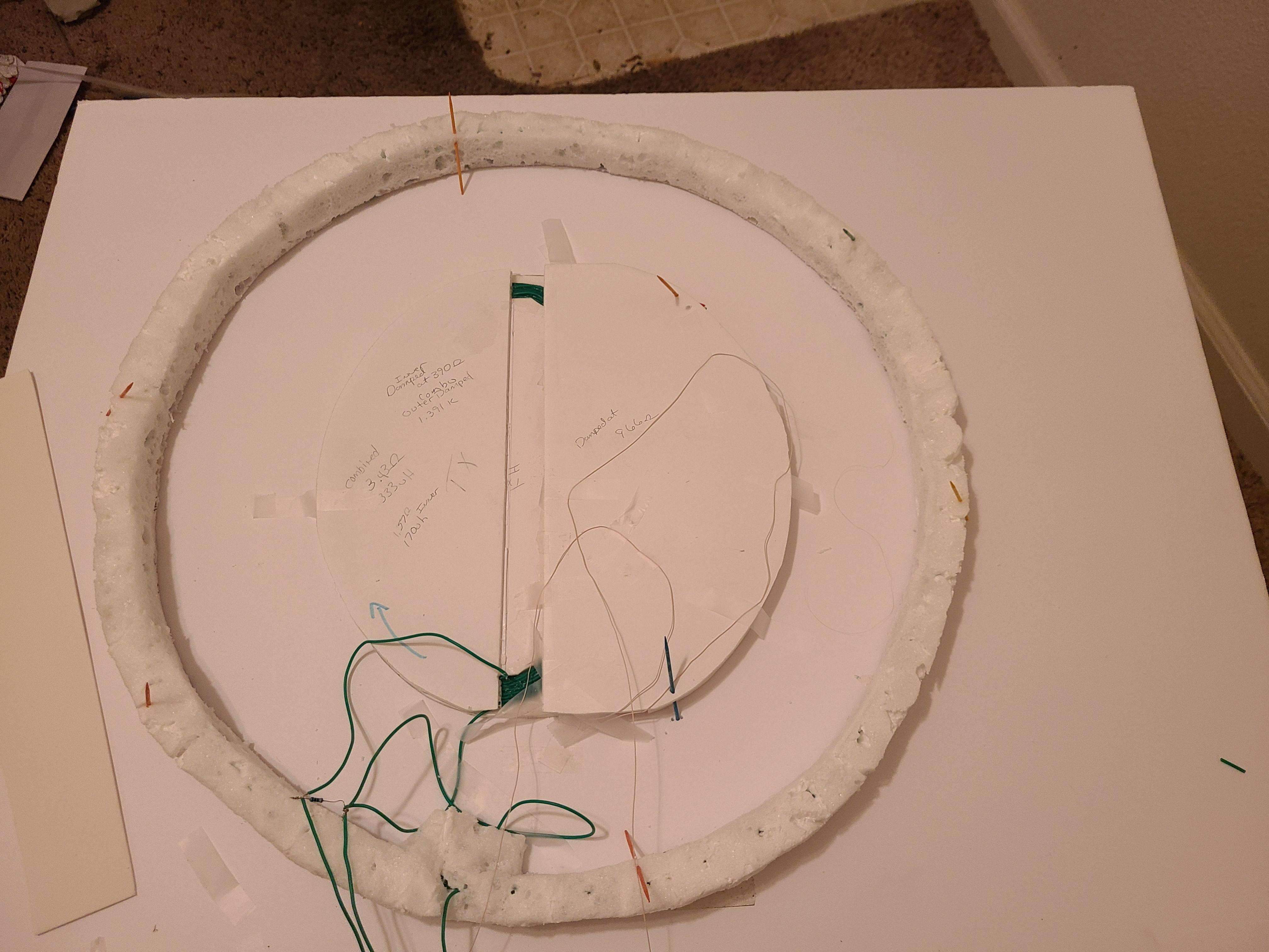

                      I was able to get the dual field DD coil up and running on a mpp.
                      Here is what I did it could be adjusted better for the voodoo but i just wanted to see if it worked before saying it was good just by balancing it with my genny.
                      The outer coil is 17.5 inches in diameter, its verticle stack basket weave coil.
                      I used 30 strand 26 awg tin plated silicon insulated wire( on ebay BNTECHGO brand)
                      120uh
                      1.86 Ohms
                      The DD coils are on 10 inch forms the tx is the same wire and the RX is 40/46 30awg litz.
                      Tx D=
                      170 uh
                      1.57 ohms
                      The dual field portion combined
                      333uh
                      3.43 ohms
                      Rx D=
                      514uh
                      7.05 ohms
                      here are the DD coils,
Name:	tx ,rx coils.jpg

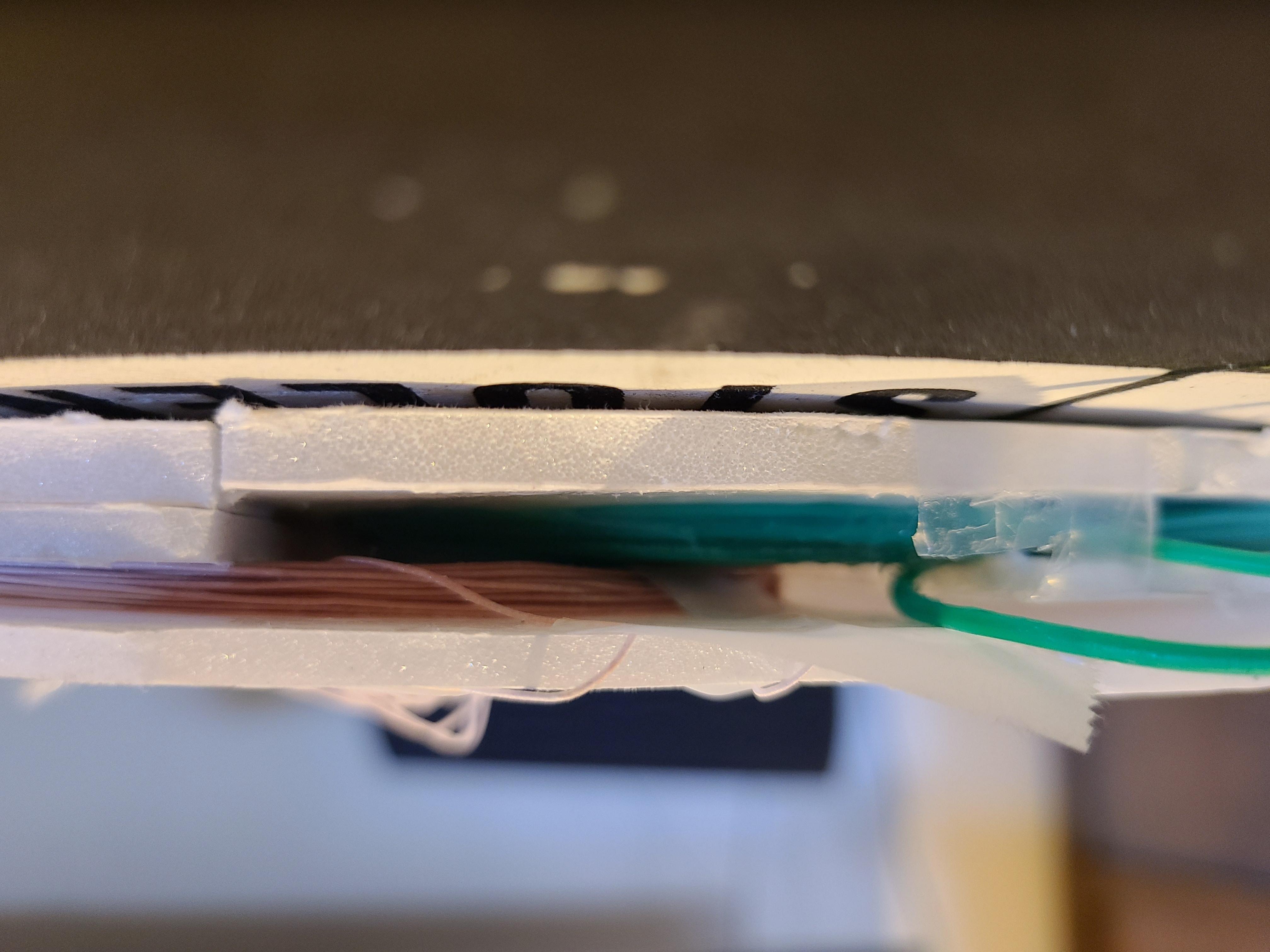

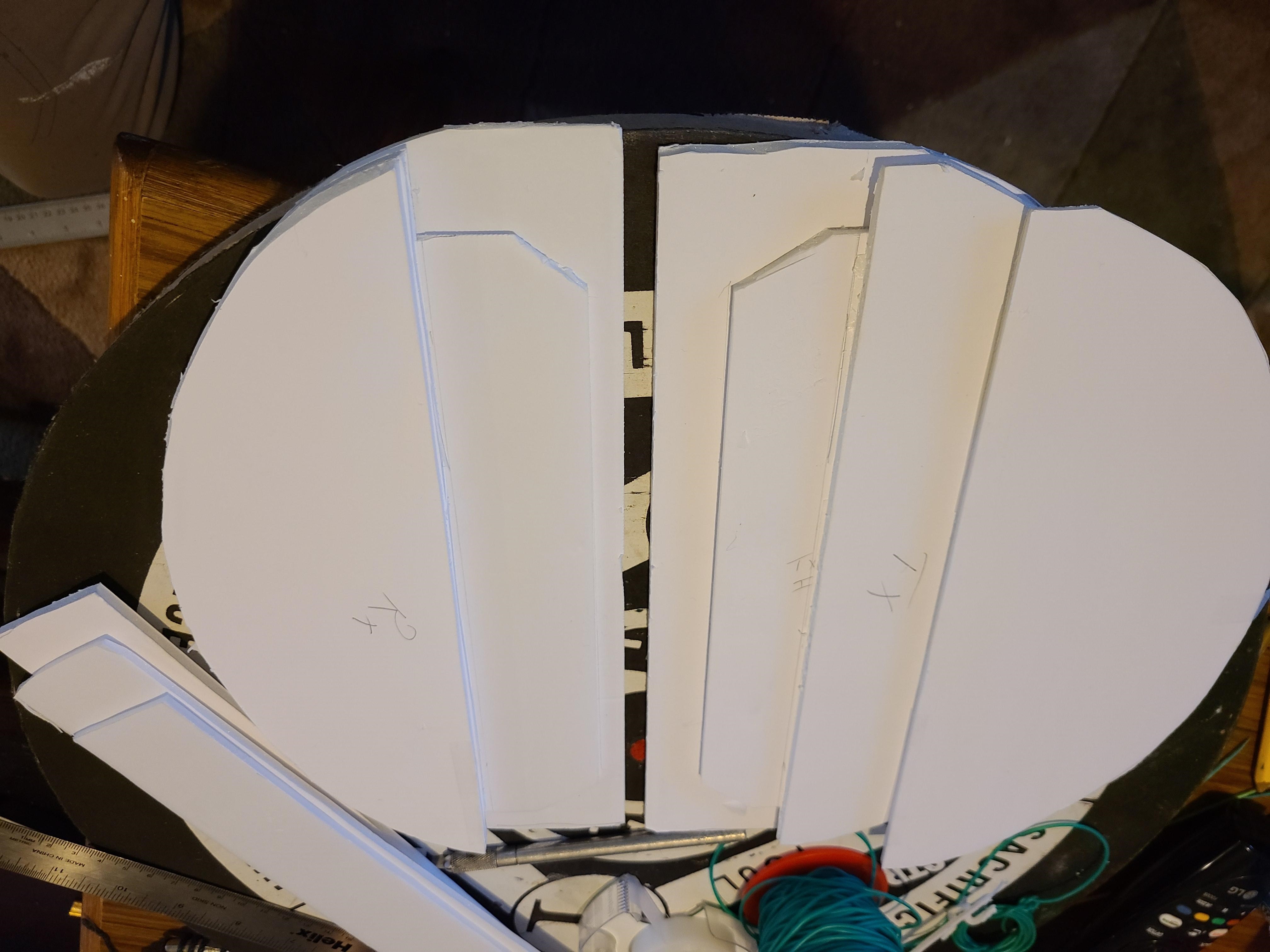

                      For the DD forms I made a stack of hardboard to hold the coils level when overlapped.
                      here is a side shot of the form and coils .
Name:	coil stack.jpg
                      this is the form with the sides cut back for overlap.
Name:	dd forms.jpg
                      Once the coils are wrapped and finished the d portion needs to be glued down.
                      I used super glue on the litz and natural silicon on the silicon wire
                      Here is a shot of the coil done and balanced .
Name:	final null working.jpg

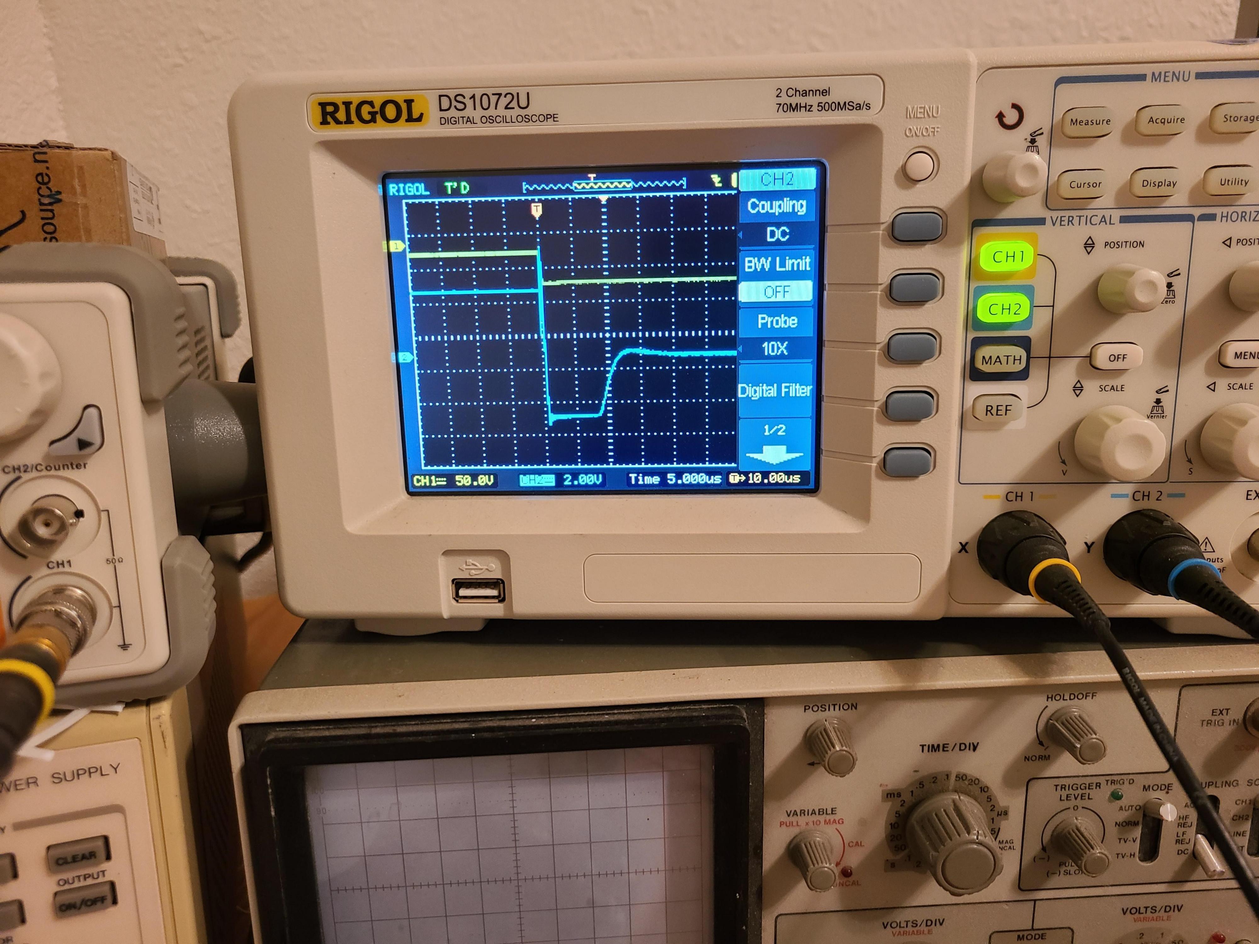

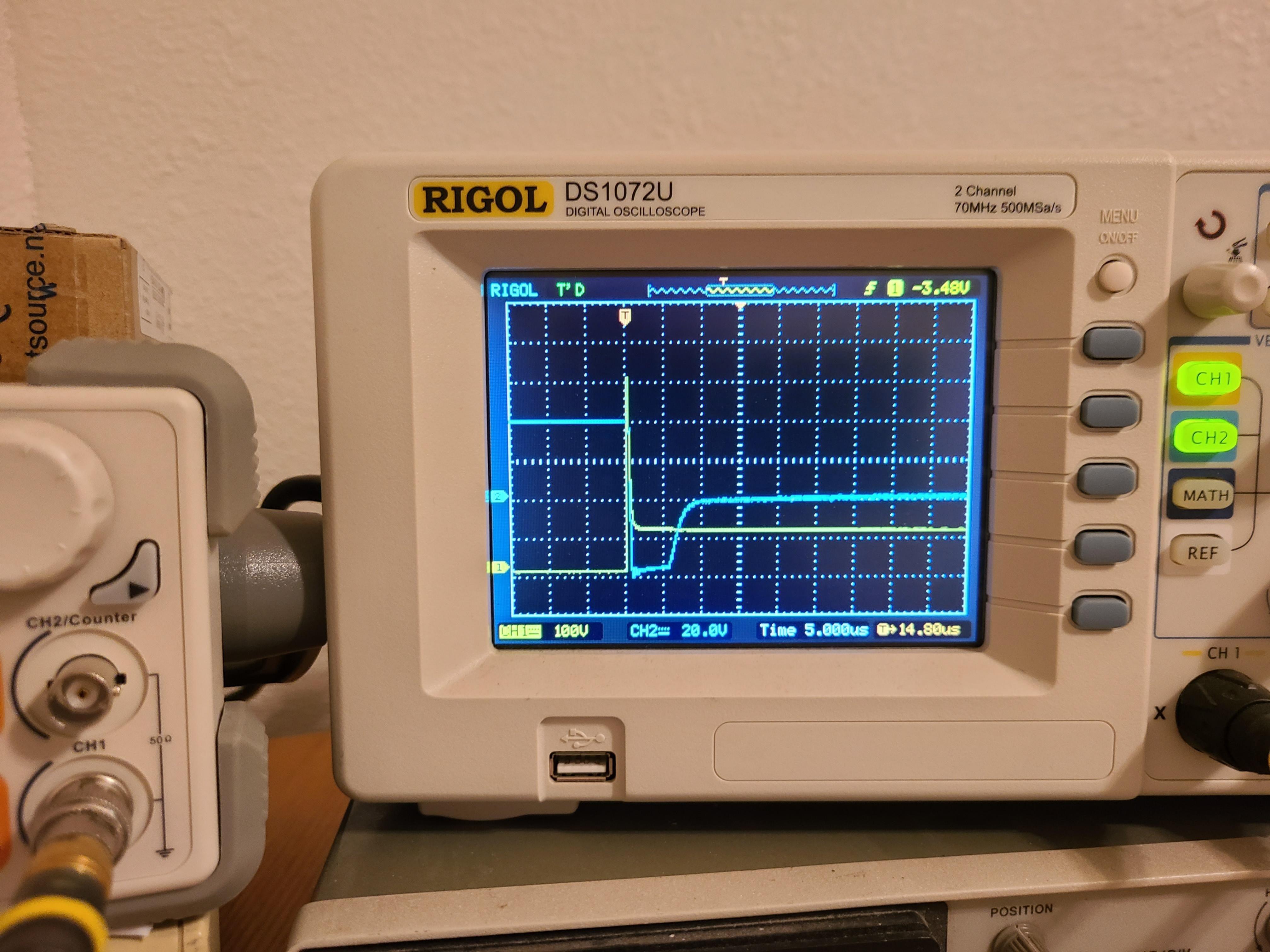

                      Steps to Damp and tune the coil ,
                      First the tx D coil needs to be damped by its self.
                      Just hook it up and damp as normal Start around 300 ohms on your resistor set up.
                      Here is the Tx d Coil Damped at 390 ohms.
Name:	center tx damp.jpg
                      Then the Outer coil and damping resistor are installed as for a normal dual field coil and the whole thing is damped as a assemble.
                      not sure of the # of attachments I can have so continuing on next post.
                      • This coil damped out at 1391 ohms.
                        Here is a shot of the final damp of the dual field portion.
Name:	tx 18 dd damp.jpg
                        final damp was at 1391 ohms.

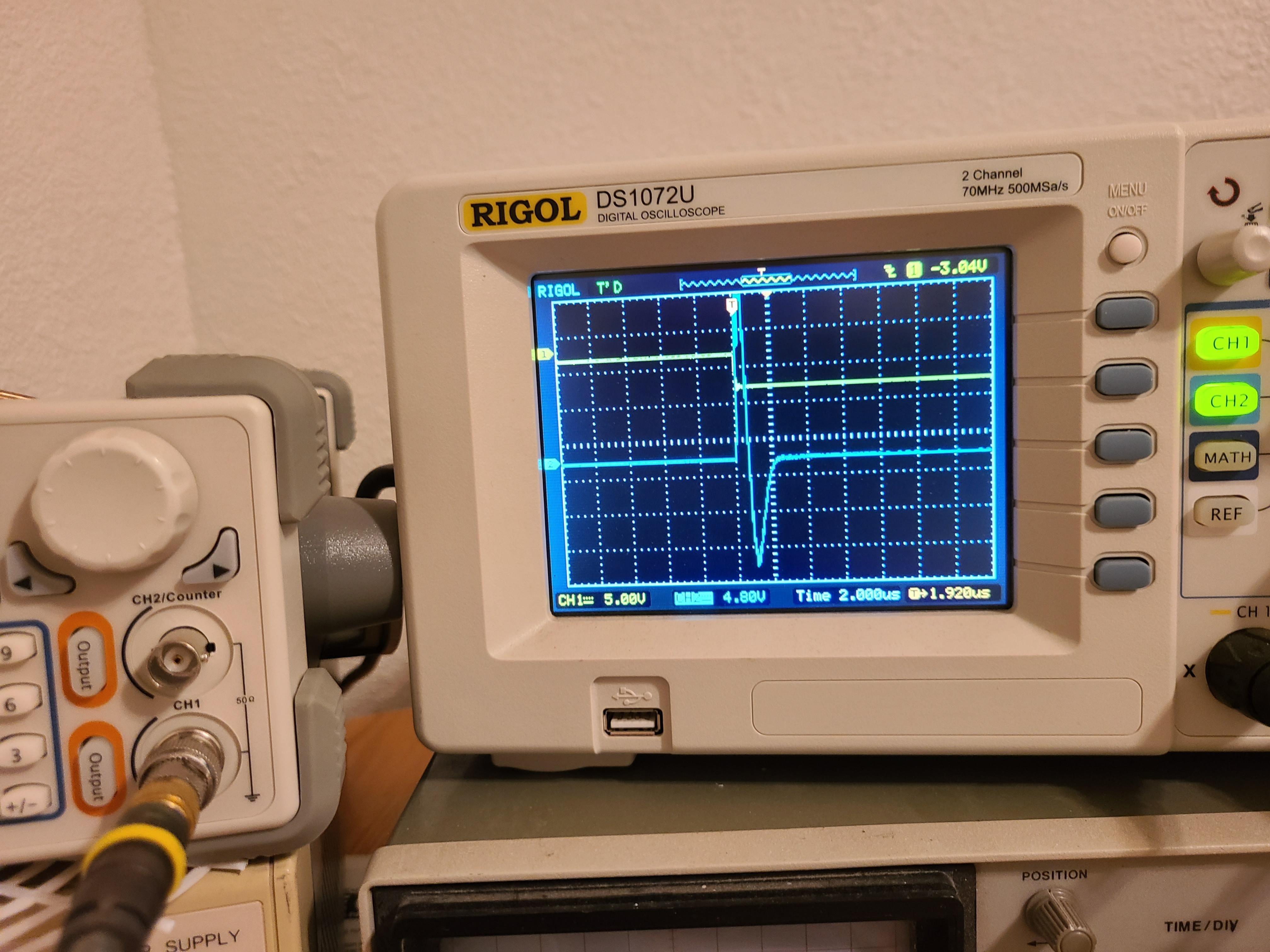

                                This is the rx coil pre damp to 966 ohms
Name:	rx damp 18 .jpg

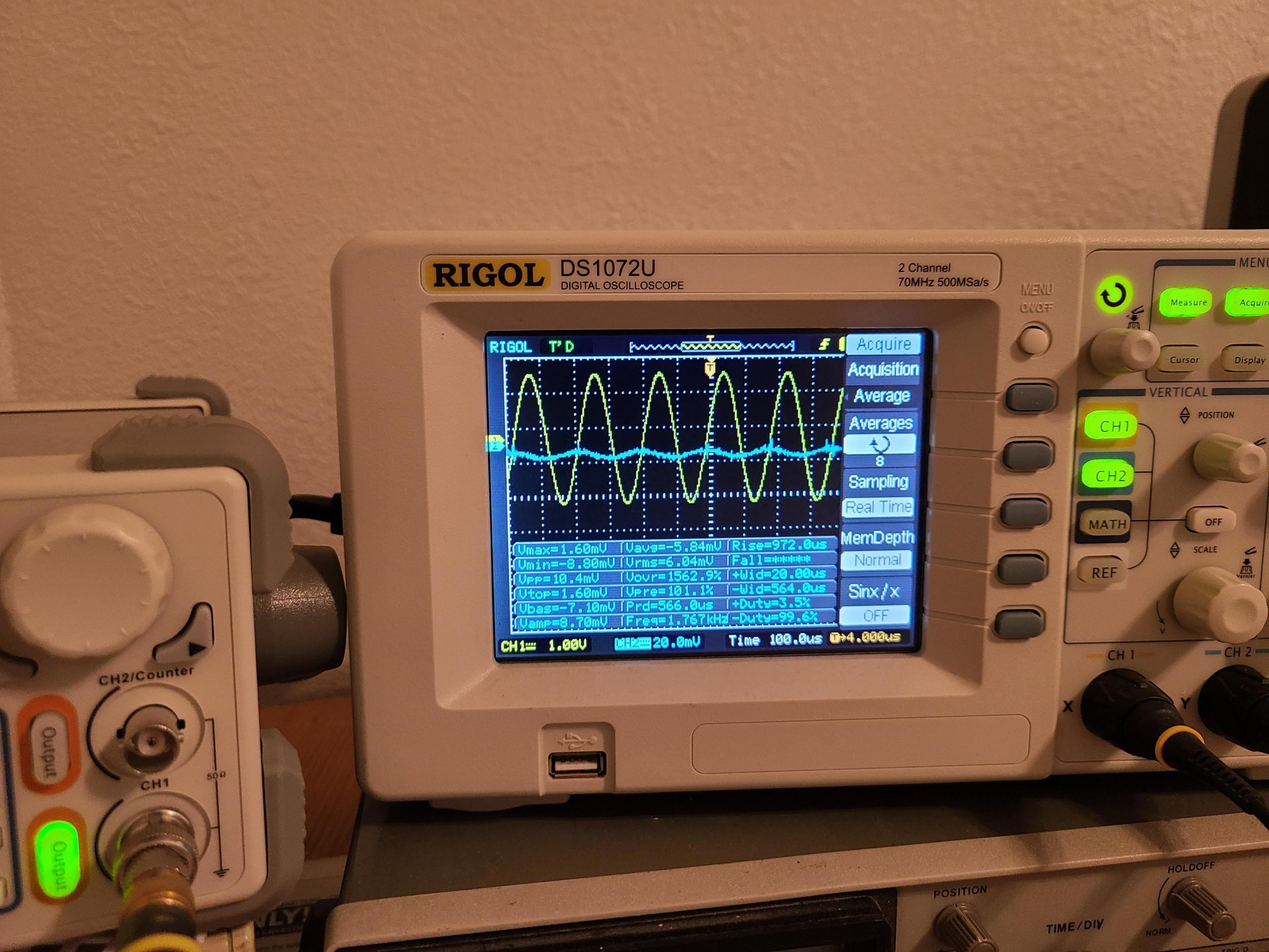

                                So the way I balanced this coil was to hook it up without the damping resistors to a signal gen then do the final balancing.
                                I found that on the Mpp I could not really get the null where I wanted. After connecting to the S.G it balanced out well and almost 3/4 a inch apart from where it balanced on the mpp.
                                Here is the null on the genny
Name:	18dfdd null on gen.jpg
                                Here is the Pic of the Rx coil at preamp out
Name:	18dfdd rx damp.jpg
                                I forgot to check the output at the integrator but will make sure its good.
