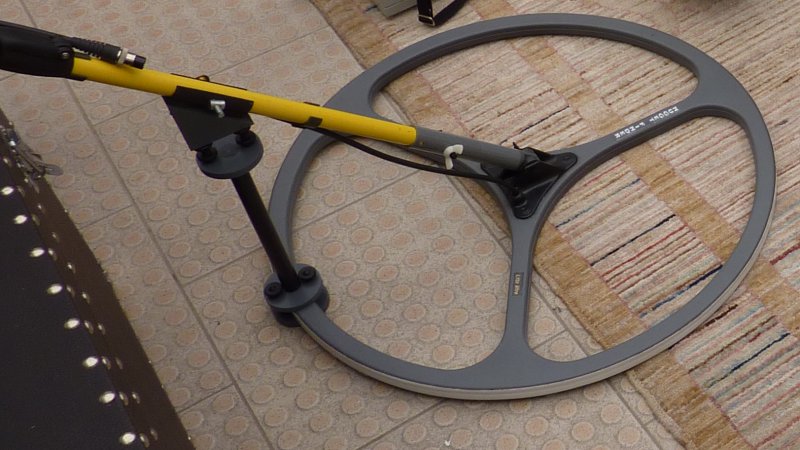

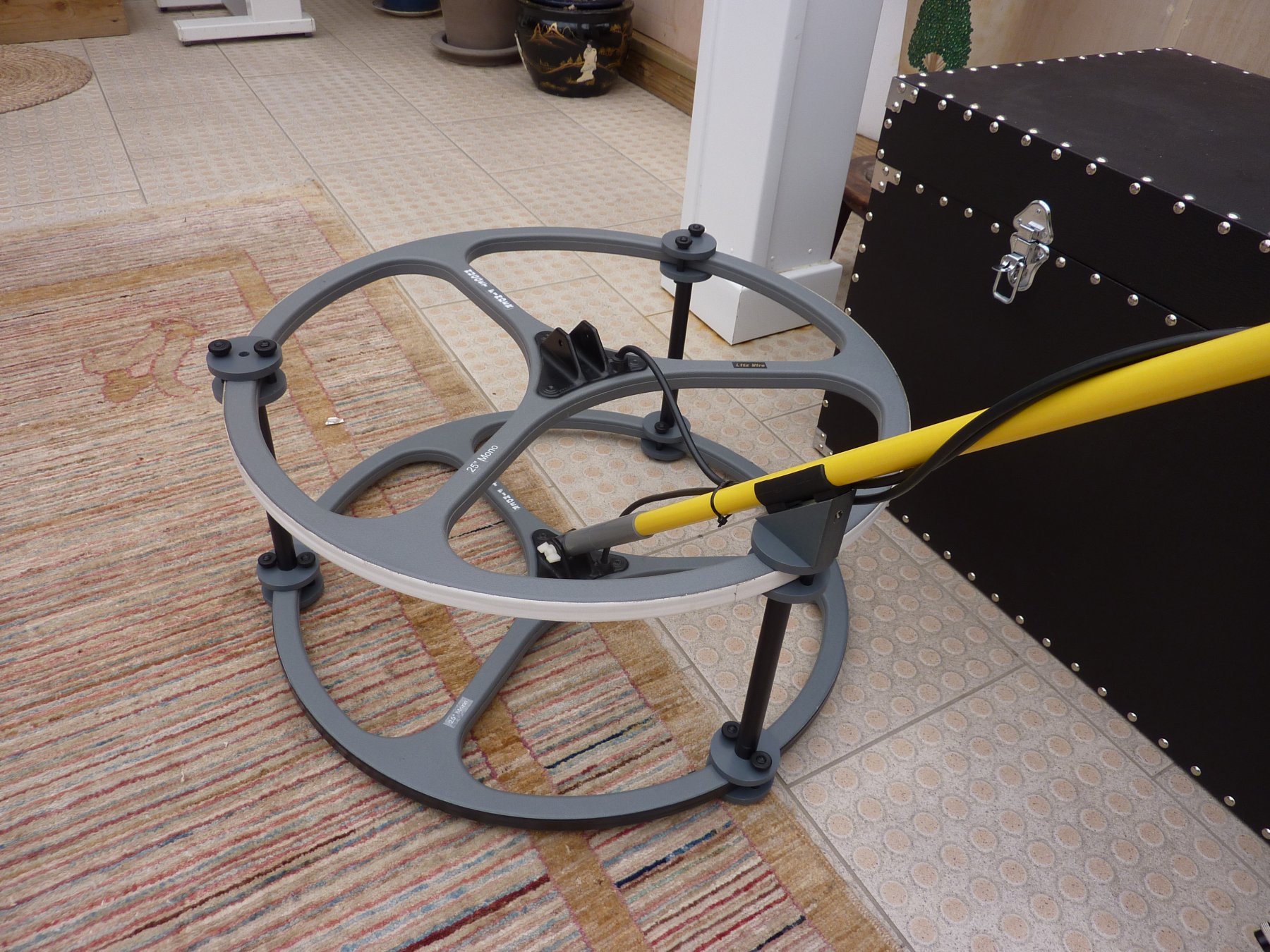

      This is very quiet and works well in noisy areas. You can crank up the gain too. These coils are light and the differential setup is not too cumbersome to use. However, in quiet EMI areas I take the top coil off.
      Eric.

      • Here is top coil removed.
        Eric.

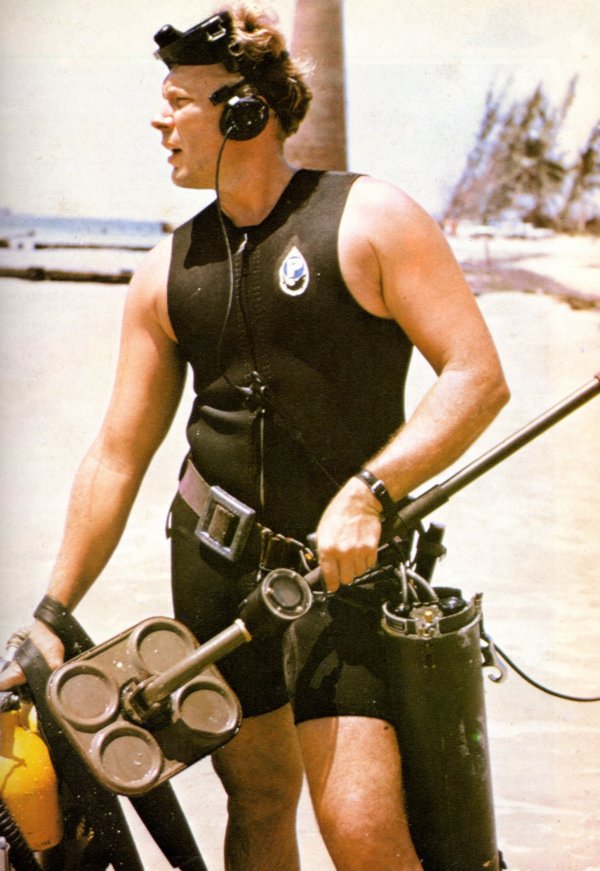

            I thought of this:
            Ex US Army mine detector modified for diving use circa 1970. Must have been IB and not sure if each RX has a TX or one TX around the edge.
            Picture credit, Research, Search and Salvage, FLA.
                      I'm obviously not original, but I still wish to see it's performance. I can't believe someone already thought of using this exact configuration for diving. I'm positively amazed!

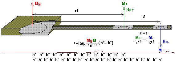

                          • Do you have a ground-breaking coil idea? But I only accept the mathematical description of the coils to avoid the misunderstandings.
                            Look here, like this:
                            http://www.wolframalpha.com/input/?i=PSY+curve
                            (see all the sine terms.. )
                            But that's not enough. I expect a three-dimensional description ( x(t), y(t), z(t) )
                            Ok?
                            Aziz

                              • Mine detector is AN/PSS/11 and it is outer TX with 4 x RX. Lots of info on Google.
                                Eric.
