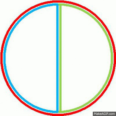

          I might have something very nice. It is based on Sergey_P's work on the concentric differential coil. I already had some discussions with Sergey on this one and for the time being neither of us did it a go in real life. To shorten the discussion I made an animated gif picture of it. Lets christen it Davor-Sergey coil.
          The animation begins with a well-known differential "tanga string" coil. there are two D's, blue and green, one against each other, fed in anti-series. Around them is a TX coil, red. Phases of the Rx coils are in reverse, and the whole shebang is balanced. Also it cancels far field electromagnetic noise, and also a ground signal. And it also has a drawback - one of the Rx coils is in counterphase and that creates problems in Rx.
          The Rx coils are then transformed, Packman style, and the left D consumes the right one. Area ratio is maintained, so that in effect it is still a differential coil with anti-interference and anti-ground-signal features. A step before the final one is a configuration that has the previously right coil in the middle and consuming half the area, and the left coil encircling it, but in a shape of a belt. The clamps connecting the inner part of the left coil and the outer part have currents in opposite, and can freely be discarded.
          Now the final stage... Both Rx coils started with N turns, thus the outermost coil still has N turns. It's inner part has also N turns. And the other coil has also N turns. And all of them are connected in anti-series. So in effect we have outer Rx coil with N turns, and the inner coil with 2N turns. Radius ratio is 1:sqrt(2).
          A bonus feature... if this is used as a monocoil (e.g. just discard the Tx coil and use the differential coils as a monocoil), there surely is no influence between Tx and Rx. It will function as a differential coil both ways, Tx and Rx, but it will also cancel far fields and to some lesser extent the ground. Why? because to cancel ground it would require a non-differential Tx coil.
          My doubts are in the coupling between Tx coil and the outer Rx coil. I'm afraid it could screw the balance due to proximity. Aziz, please check the balance of this contraption with your fabulous software.
            You are right with your doubts.
            Nearby the TX coil, there is a high magnetic field strength, which will be induced by the outer RX coil. In the center region, the magnetic field strength is weak and you would need much more turns to compensate the outer RX coil.
            Balancing is in principle possible but with different turns count of the RX coils (or radius). This would mean, that you screw out the anti-interference feature.
            Aziz

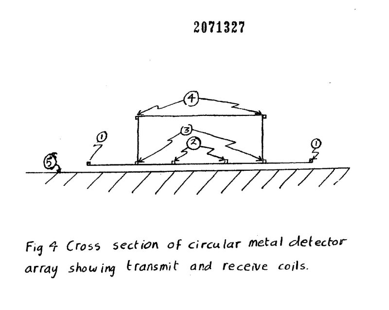

Name:	Corbyn Coil 2.jpg

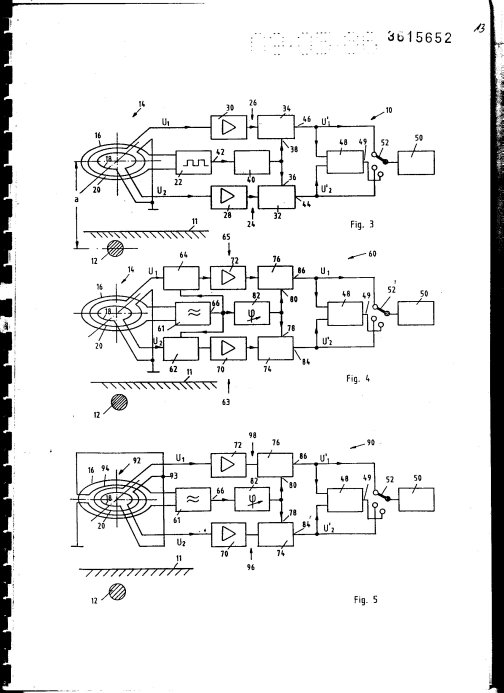

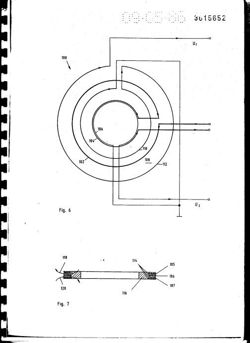

                      Another coil patent filed in Germany (DE 3615652 A1) in 1986. I can't read German but Fig 5 suggests sine and square wave drive (Impulserregung in text). 32 and 34 are Integratoren.
                      Eric.

                      • #41
                        Yes, the Geonics coil is basically a noise cancelling arrangement, but the configuration can be described as "tophat" albeit a square one. A closer arrangement is that of Corbyn (GB patent 2071327A) filed in 1979. Coils 1 and 2 are TX connected in series and reverse phase. Coils 3 and 4 are noise cancelling RX. The reverse winding arrangement of the TX is to reduce the ground signal, according to the patent, although it could no doubt be adjusted to give induction balance.
                        Eric.
                        Hi Eric,
                        yes, I know this patent already. The Corbyn coil differs from our tophat coil. Our tophat coil here is a true new invention and achieves superior performance. No counteracting of TX by BX (bucking coil) - the opposite happens. Better pin-pointing feature. Higher sensitivity to shallow & small targets. Fully anti-interference feature. Easy to build and balance. Can be made large. And goes deeeeeeeeeeeeeeeeeeeeeeeep.
                        There is sweet (but candyless ) magic in this coil.
                        The german coil patent differs too. A total different coil.
                        Cheers,
                        Aziz,
                        the madman, magician, anti-patent-troll and inventor *LOL*
