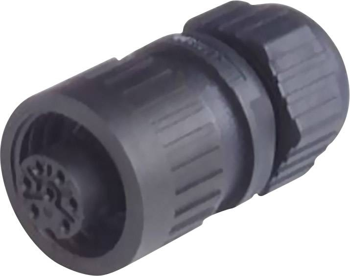

    yesterday a detectorist from my region visited me and asked me for a small DIY coil for lorenz deepmax x5
    he had a bigger coils with, i think, the 35cm version
    it is a kind of dd shaped coil for pi units with separeted connection cables
    was very hard to measure because the pins are deep in the connector plug
    but i was able to measure sure one line with 1,14mH
    i suppose that the two side has same mH, shield, but i think they dont overlap like vlf dd coil because of coil form it has a big straight part in the middle
    means they are fitted side by side or with little distance 1-2cm
    thats not sure but i think so
    has anyone soem experience with this machine or s able to measure the coils over the plug
    to give me the specs
    the task is to build a small (20cm) dd coil for better separation with working ground balance
    the is no commercial thought behind but i think its an interesting task to solve
    coil connector has following plug
    i will try to measure again a second when time makes it possible
    but would be kind if someone who has this machine in use could measure too
    kind regards

        The balancing for an induction balanced coil on a PI is not critical. One of the reasons for using an PI-IB coil is to allow the RX coil to have more turns (higher inductance value) to increase sensitivity. The IB arrangement also provides better pinpointing than a mono.
          tx 0,34mH 2R2
          rx 1,14mH 9R
          one parallel resistor inside coil on one side 211R or 2,01k cant measure because it was parallel to coil could only read the lines
