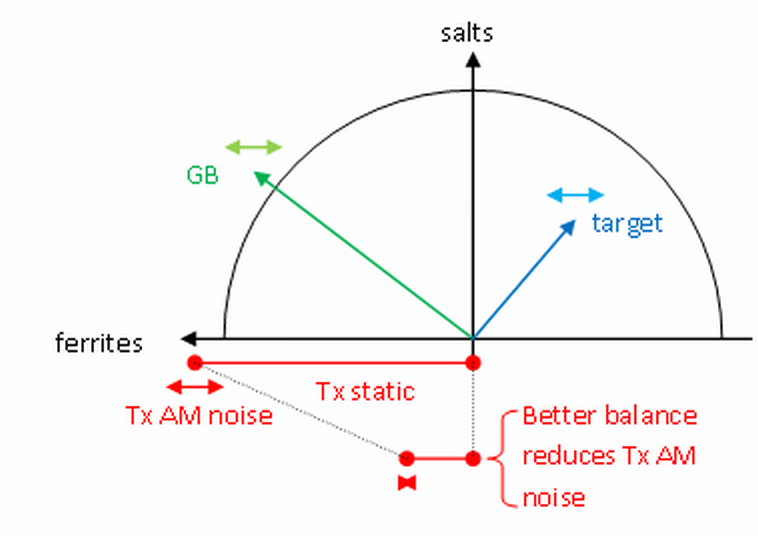

                You are mostly right, and I'll add only a few corrections...
                Product detectors are the least of your problems because they can cope with signal swing to near the rails without much problems. The most vulnerable to saturation is the preamp because it starts intermodulating at much lower levels. The crucial parameter is a THD ... you are supposed to amplify signals at below 1uV with "air signal" at few mV. Anything more than that and THD kicks in.
                The DC offset is not small, unless it is seriously compensated. Even then you have TX AM noise that introduces a dynamic component that can't be compensated, but it is at the ferrites' response phase and goes away with GB ... provided you are dealing with easy grounds. TX's 2nd harmonic is a cheerful li'l bugger that may assume whatever phase it wants and it also rides on an "air signal". It affects the unbalanced product detectors, and it is produced by unbalanced TXes.
                The best case scenario would include:
                - the least possible "air signal" as a better coil balance also reduce the AM noise and 2nd harmonic content
                - balanced Tx with well stabilised supply
                - balanced product detectors to reduce 2nd harmonic
                I'm attaching a picture indicating the importance of a good coil balance. You'll notice that poor balance is also responsible for fuzzy discrimination as it shifts the targets' phase response left and right.
