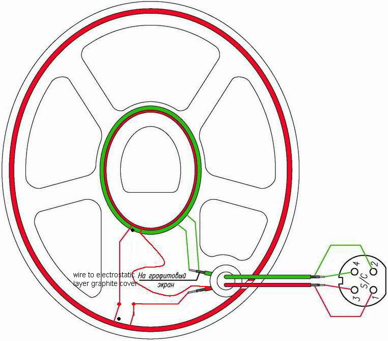

    Hi, anyone knows the pattern of Tesoro 4 pin plug for Cibola coil

      Many thanks, i suppose that RX is the red wires and tx green and the end of coils is the wire braid (mass)
        It is right the opposite.
          oups, ok thank.
          Is that the 4 pin plug to the same dimensions as the 5pin plug, I want to adapt the 5 pin by cutting the middle? because i've two 5 pin plug and no 4 pin.
