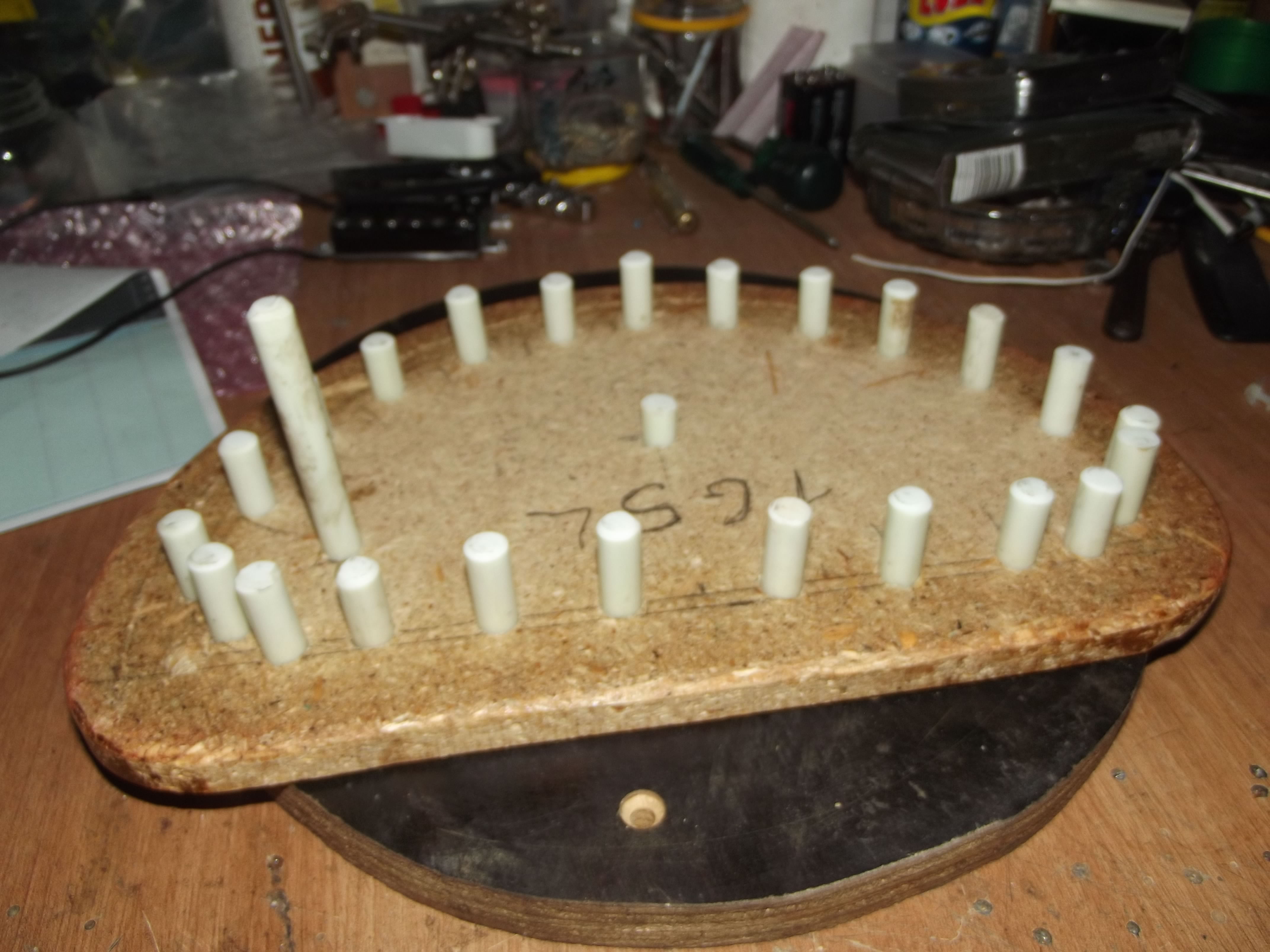

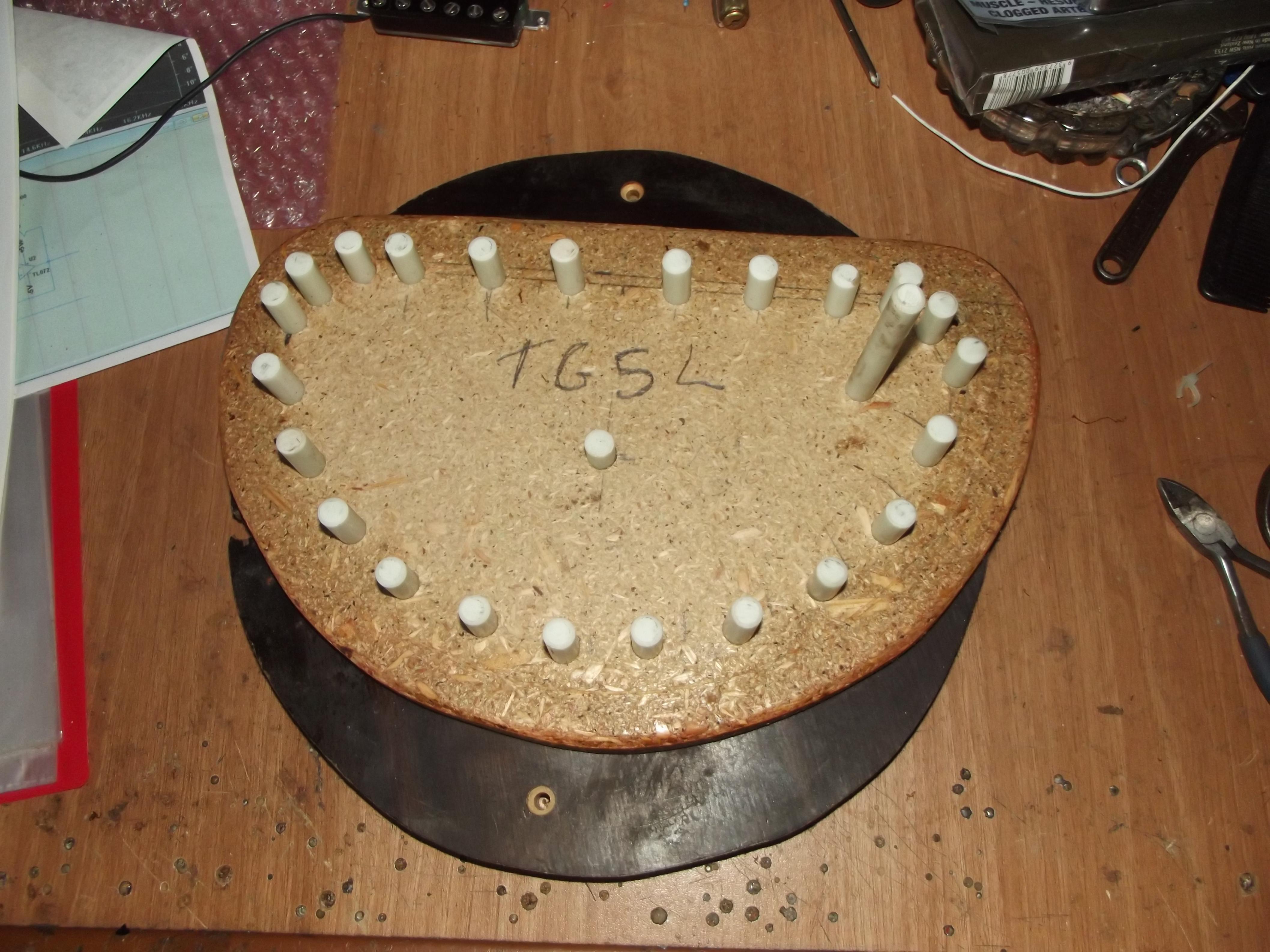

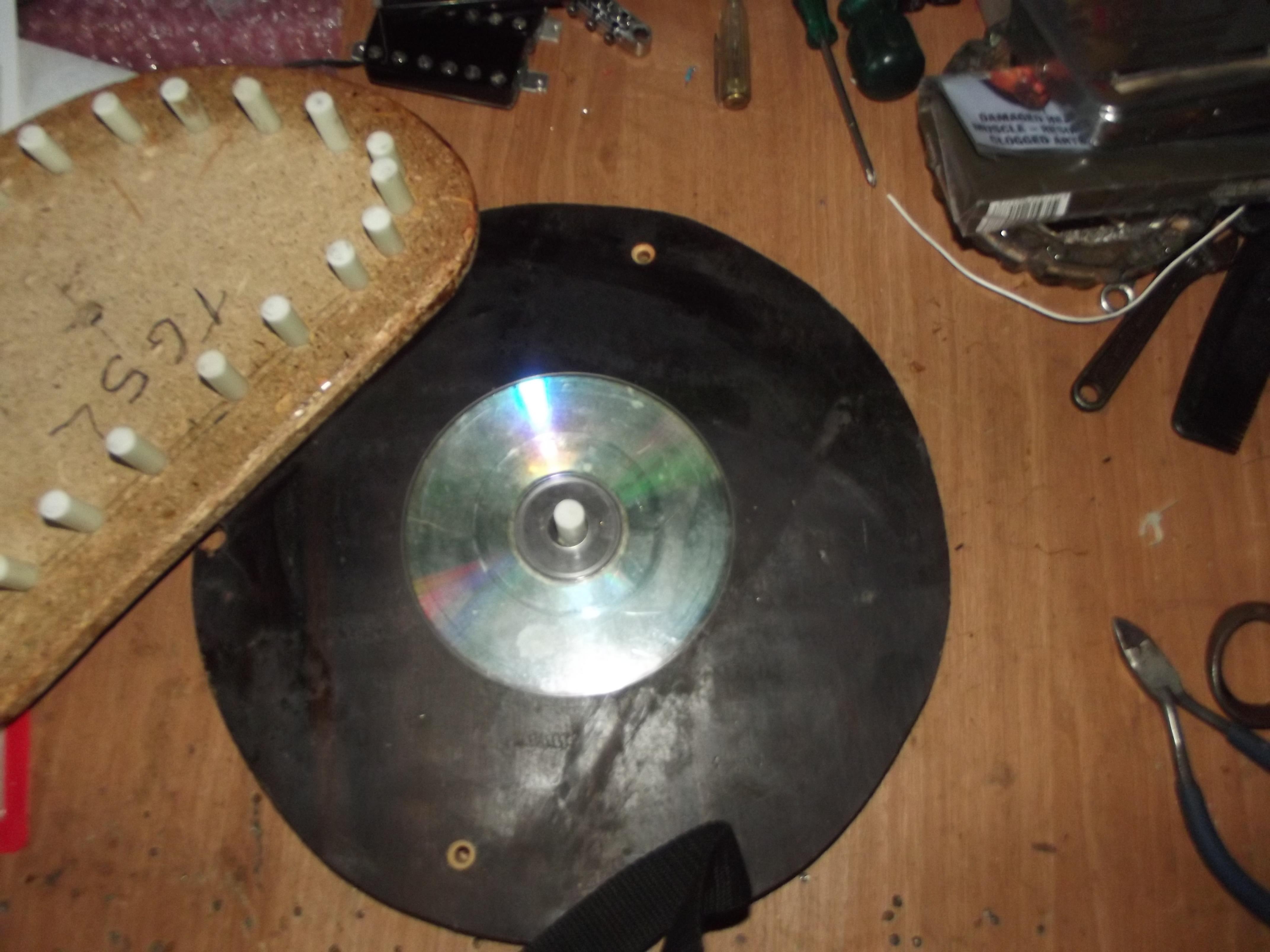

    HI ALL I have just finnished my Coil former-winder copied from the TGSL Download information ..
    I thought I would do this whilst waiting for my wire to be delivered..
    I am yet to buy the Board & or Kit as Silverdog is on holidays ,so I decided to go ahead with the coil ..Click image for larger version

    SOME 1st PICS
    CHEERS FROM OZ.............BARRY..

      Good on you Barry,
      some people make a matching plate - and fit onto the dowels. so the windings get contained - using say a 5mm spacer.
      Sometimes as you have it - especially with those shiny plastic dowels, the turns will want to ride up. Hopefully not.
      Good luck, the IDx is pretty neat too - you can make them go up to low teens kHz too easily. S

            Good on you Barry,
