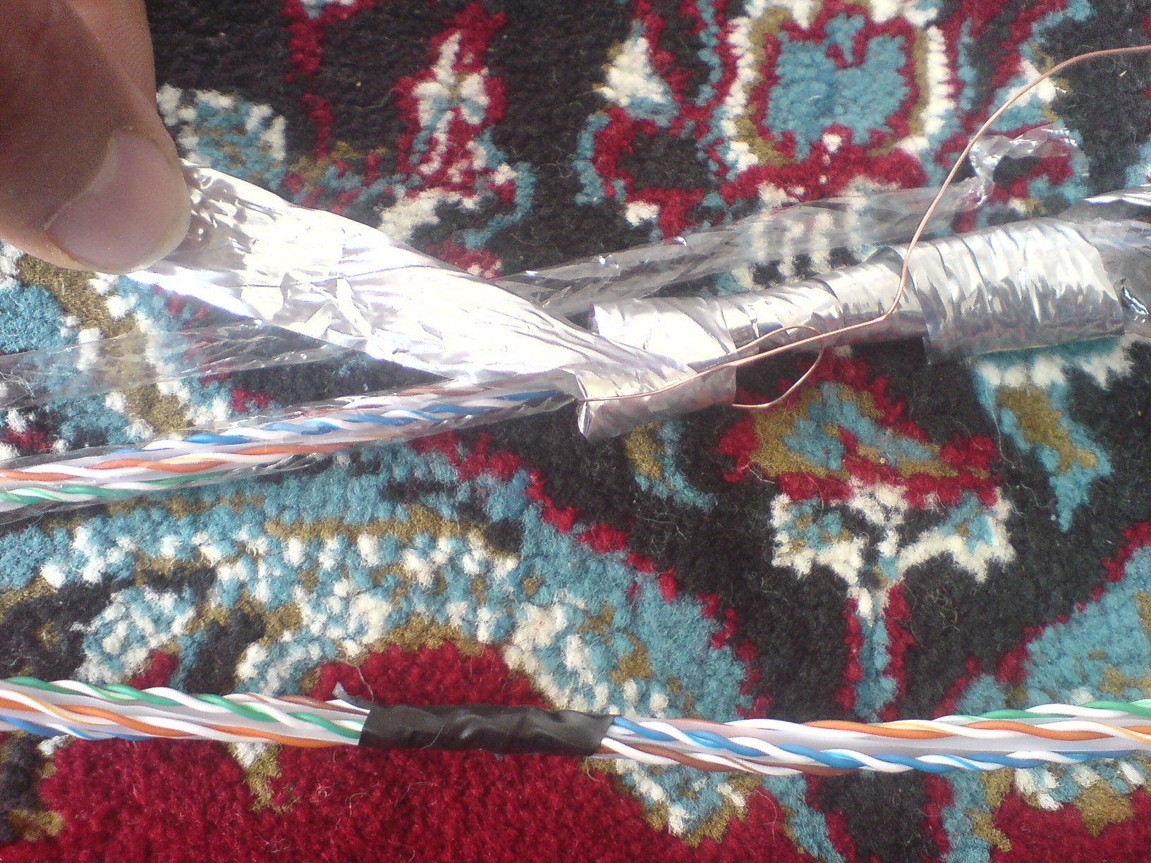

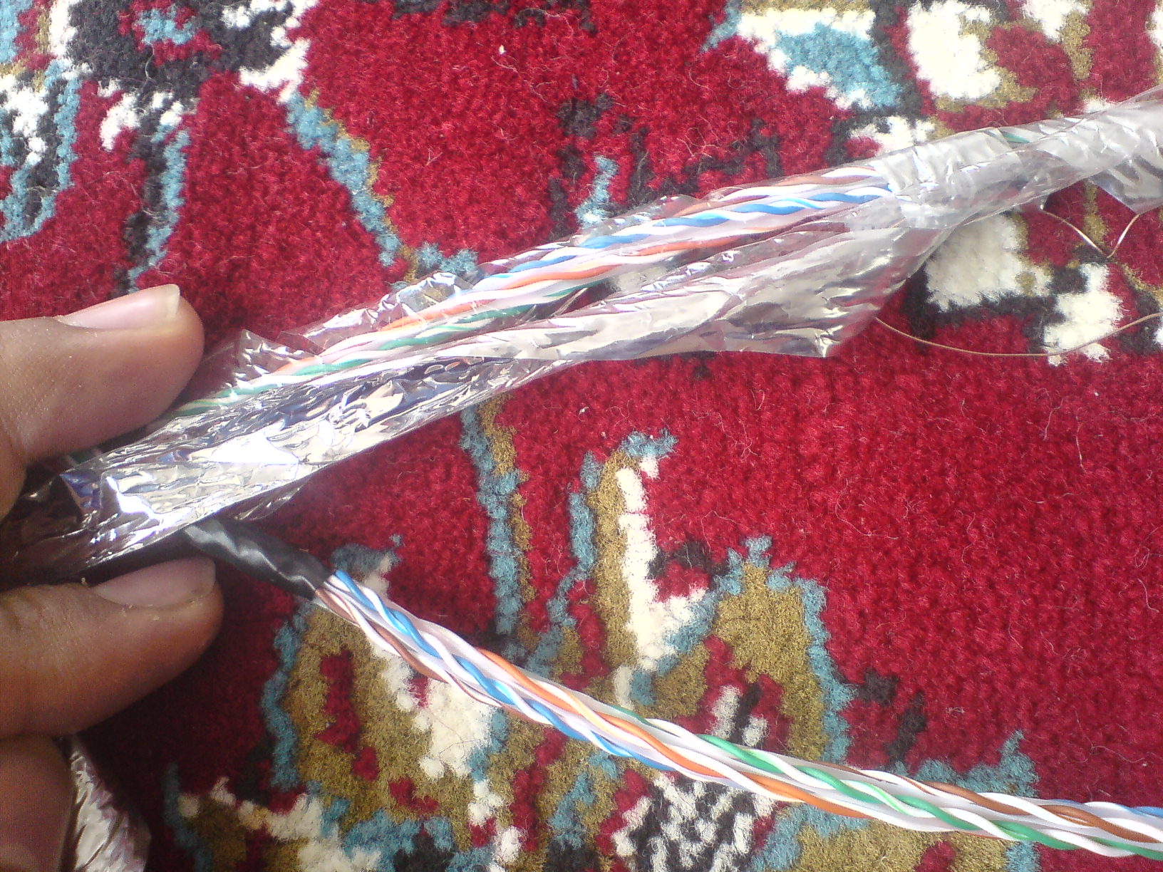

                  this shielding is ok or no ??tinned copper wire OK or this tiny foil ??guide me

                        before i tested silverdogs pi coils, i would have said don't use aluminum foil in pi coils, but that's what he used in his pi coil, and i also have another identical coil exactly the same except this one does not have the foil shield (he wanted them both testing to see if it was needed).
                        my conclusions are that it works perfectly fine, it does reduce the depth on the detector tested, the depth reduction was 2.5 cm, now on a vlf design a 2.5 reduction would matter, but here's the thing, the actual depth on the barracuda is-
                        unshielded silverdog coil- 12 inches(30cm),
                        shielded coil- 11 inches(27.5cm),
                        so, on the designs were are working on for mostly beach work, it does not really matter, since at 11 inches its way down into the dirty hard pack anyway, the depth reduction in this case is worth it, the barracuda is like a different detector with the shielded coil.
                        now the unshielded coil works perfectly fine, on a beach in the middle of nowhere, but in an urban environment like your workshop its as skittish as hell falsing, random beeps etc.
                        the shield removes all that making the detector real easy to setup and fine tune, once done the unshielded coil can be used at the beach for instance, so in terms of andy wanting to know if a shield was a good idea on coils made to be sold along side the pi kits, its a no brainer especially on the barracuda, so my advice is add a shield, what we need to do is stop arguing about the best material to use, and find a decent repeatable method, so noobies can simply add it when they build coils, my tests have shown me that:-
                        1 a shield IS needed,
                        2 the depth reduction in a PI is neither here nor there,
                        3 setting up a home built pi is easier when the shield is present,
                        4 super fast low ohms unshielded coil does work well but only away from civilisation.
                        so to sum up a shield is needed, foil works(even on a pi), the only caveat is the connection to the wire(fine copper foil may make connection easier).
                        i dont know how andy connected the foil to the wire, as the coil is potted, but it works well, my only niggle with his coils has nothing to do with the operation of them, its the fact that they are fully potted, they need micro balloons or packing under the compound, as for me i find them a little heavy.
                        thanks,
                        ally.
                          Hi Thomas, well all I can say is it isn't tinned copper, I checked the suppliers website but it doesn't mention the braid type. I suspect its aluminum braid.
                          All I know is I can't detect it with my PI, but metering it, it has zero ohms resistance for the length I used.
                          Also I tested the coil before and after, adding the shield didn't increase the decay time, but it did stop hand capacitance.
