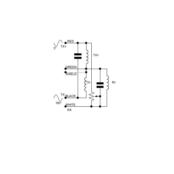

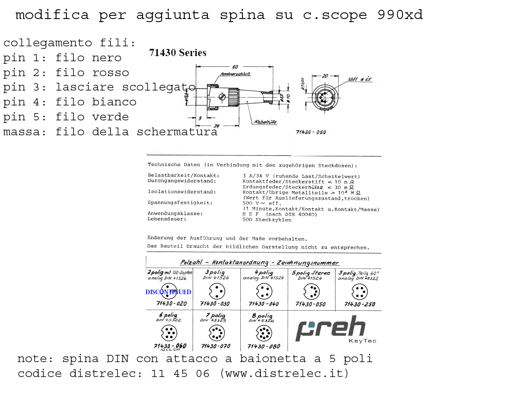

    Hello everyone, could someone help me? have the plate of my c brooms NEW FORCE R 1 and that route, but now I do not know lho open more connections, someone has the pattern of this plate? TO SHOW me the can? best regards

ID:	341494 cabling coil c.scope no motion family 990-1220-660-770 ecc
