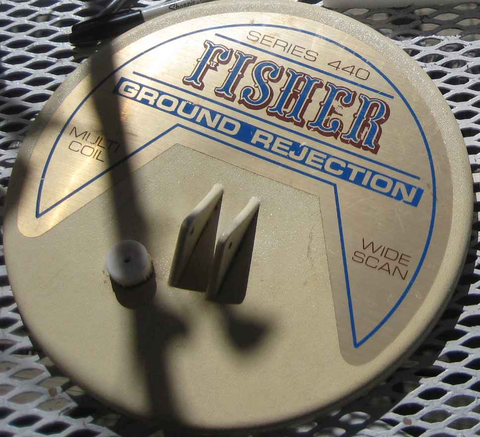

    I bought a Fisher 440 11" coil of Ebay for cheap and got it working with Aziz's
    floating TX but didn't want to dedicate a MD to one coil so I decided to convert
    it to Tesoro specs;

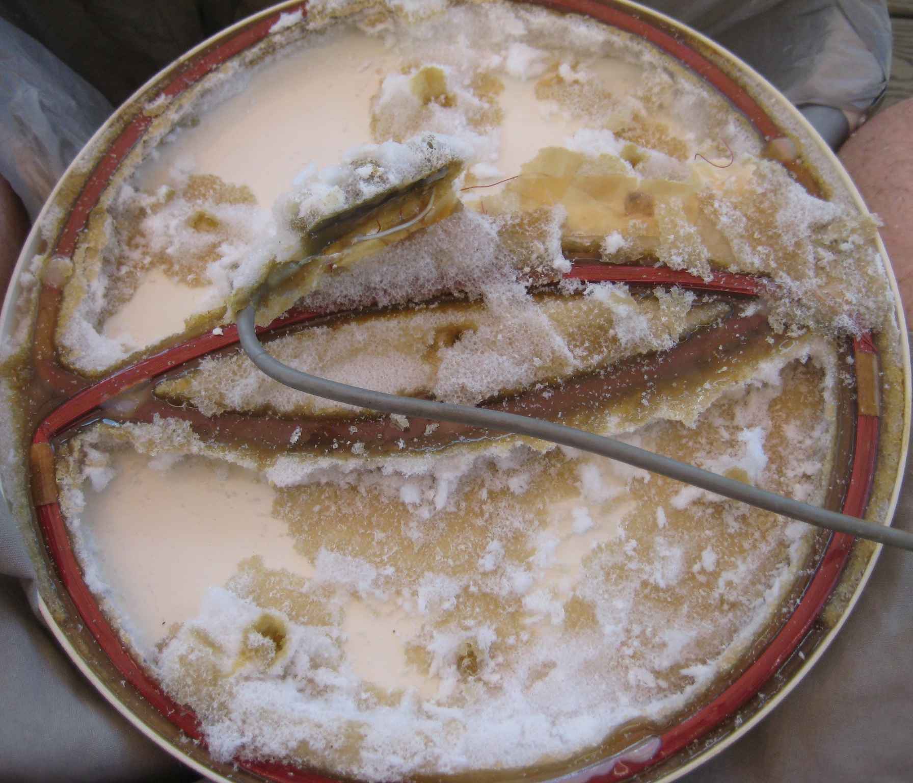

    I popped it open revealing this;

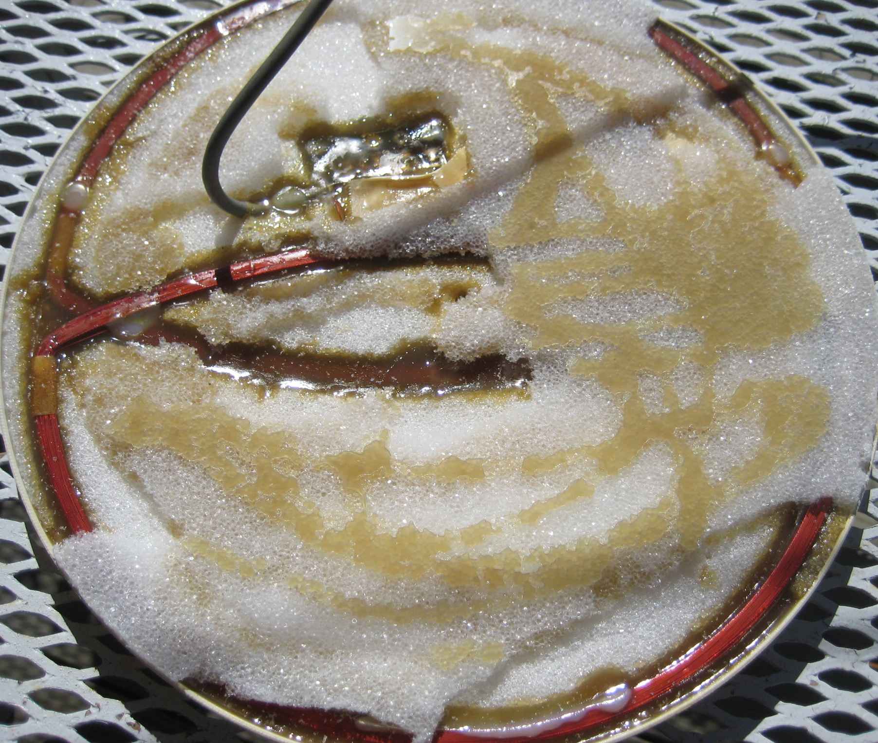

    I picked out some of the foam;

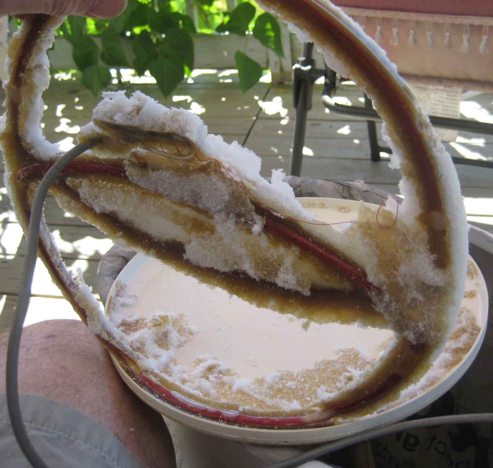

    Then popped the coil out. Lucky the 30 year old epoxy didn't hold to good;

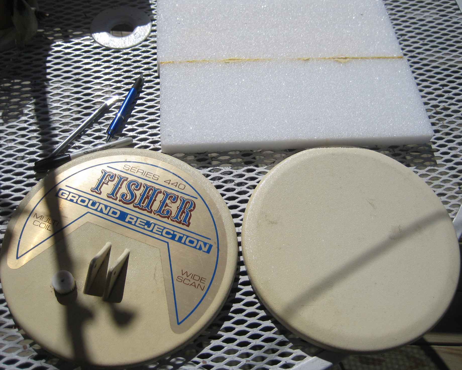

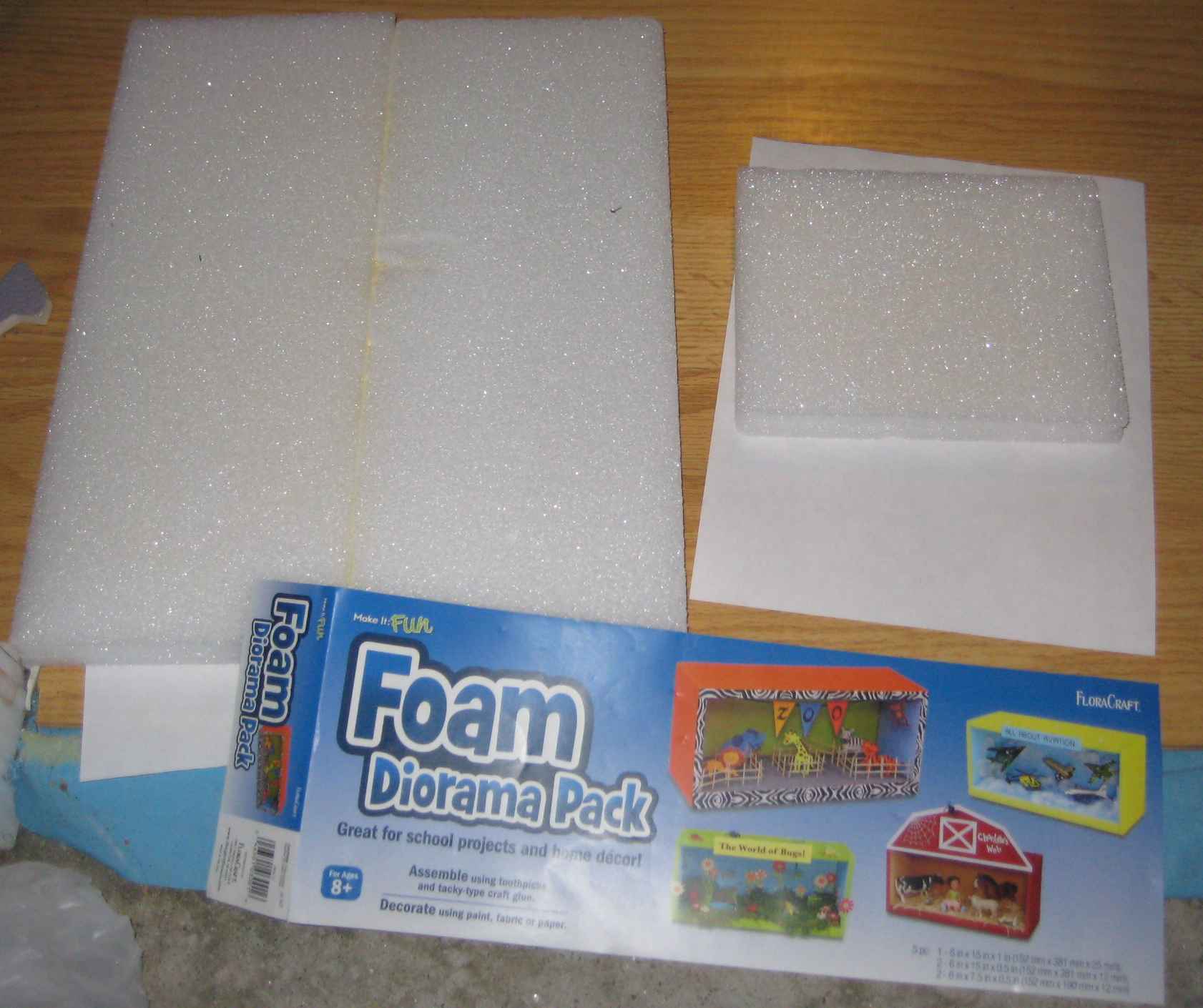

    I got some panorama foam to form the insides;

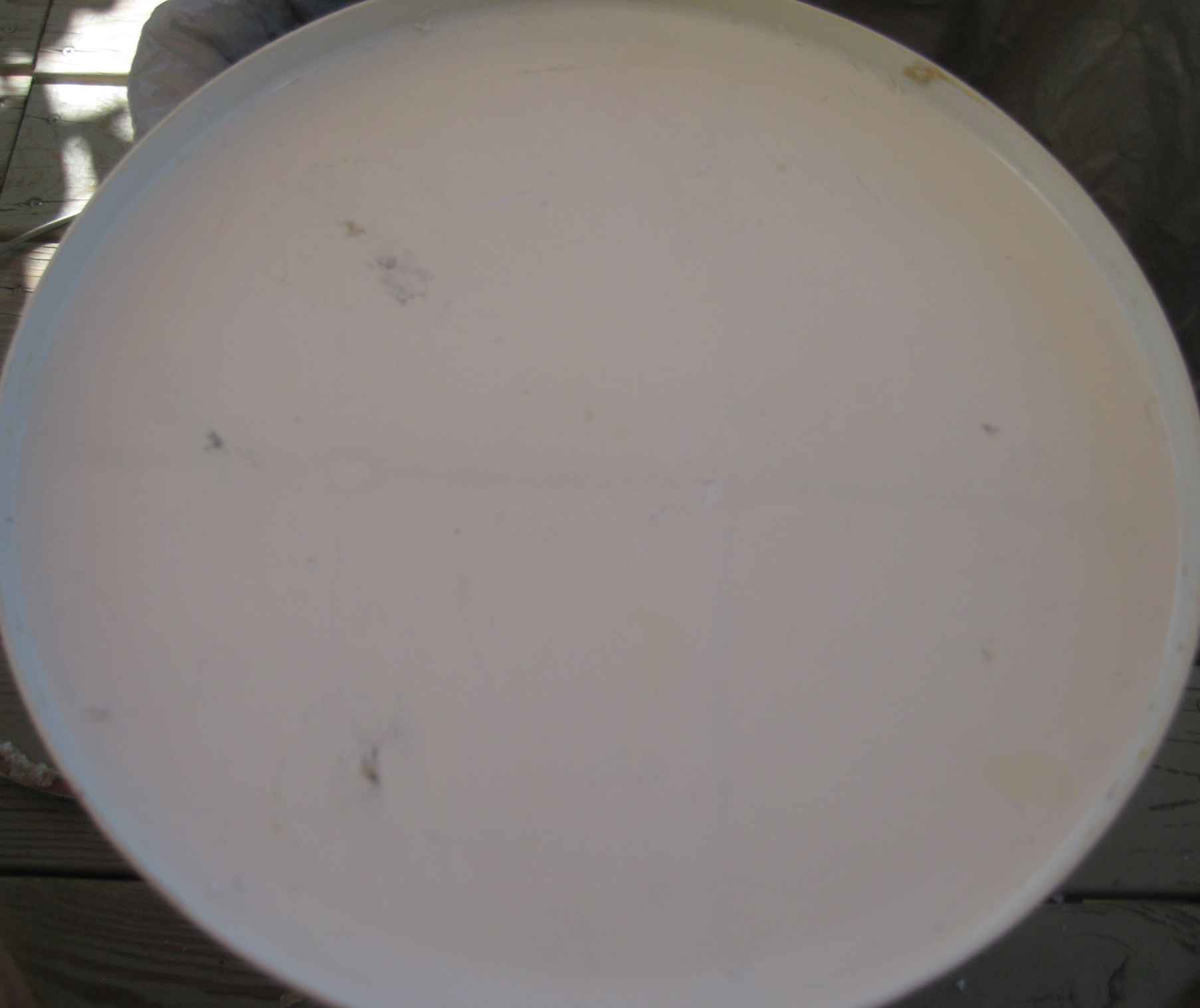

    Cleaned up the housing;

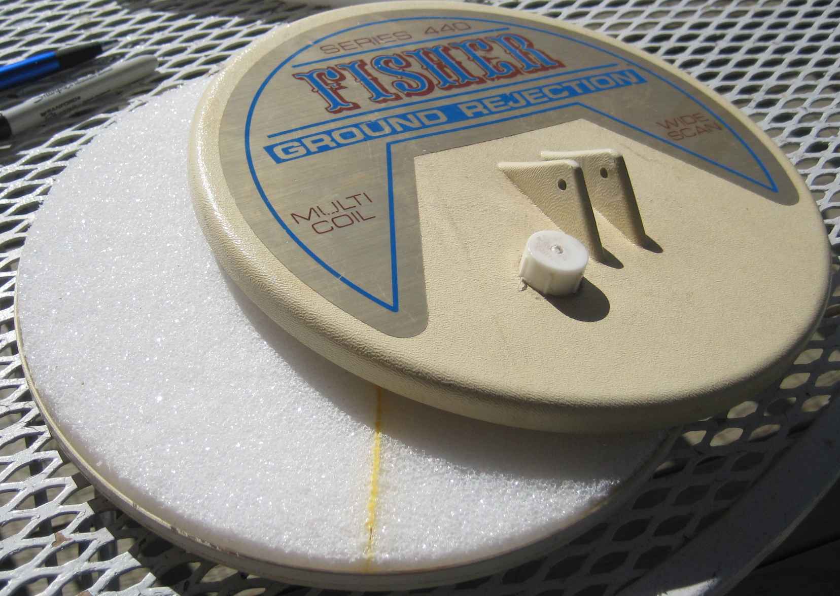

    And got ready to reassemble it;

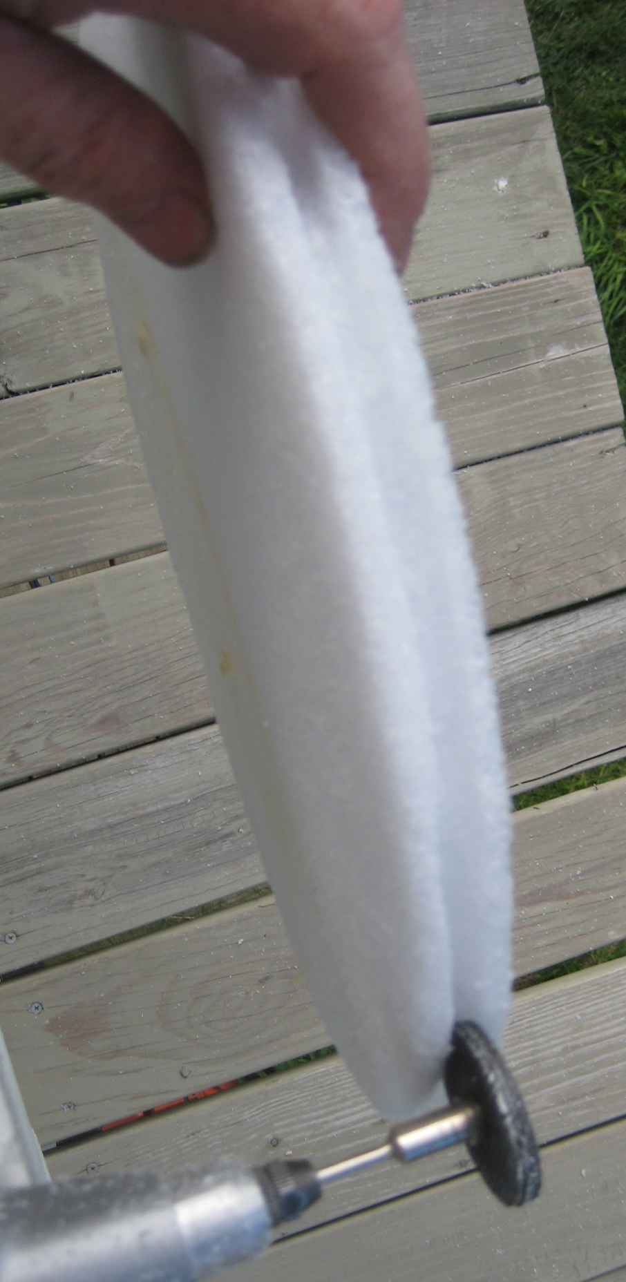

    Cut the foam;
    And slotted it for the TX coil;
