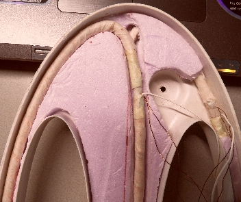

      Beatiful picture!
      Thank you.
      Is it a White original coil? The windings are perfect!
        yeah,,, the XLT original 'rainbow' 9'5 coil. the polyurethane foam that they use is perfect. hard and very adhesive to cover.
          Originally posted by nakky View Post
          Polystyrene foam and a mix from epoxy and glass bubbles.
          Grt Nakky
          Today I have found micro glass bubbles in Italy, I am going to buy tomorrow. I see also a photo of how is done. Be sure I never seen it before.
          I did not found "light" epoxy resin instead, I must order it from UK, it is not an economic solution in this case.
          About "polyurethane foam" I have already bought it, it is the lower cost solution but I must do some check with it.
            Do you know who sell a winding machine that produce coil as that in photo?
