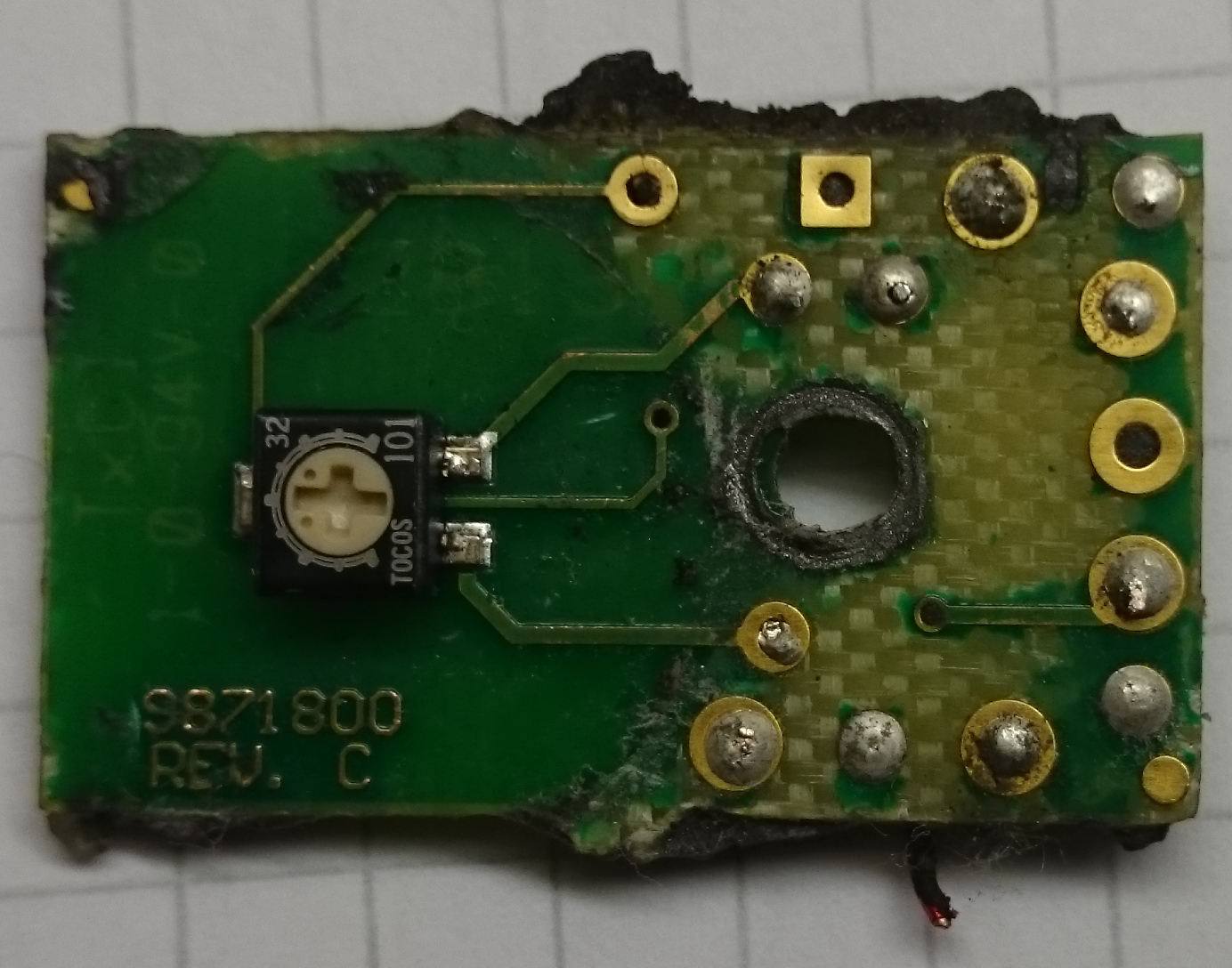

      Now I have broken AT DD coil. RX side had shortcut in coil side. Cable and plug were ok.
      I took pcb out and it looks same like ACE-series. Only 3 componets. Zero ohm resistor(jumper), 100 ohm trimmer resistor and 12nF capasitor.3 coils. 2.5mH 4.2ohm, 1.7mH 8.3ohm and one coil with very low inductance and resistance (tuning coil pallel with trimmer resistor . series with RX coil).
      Next thing is put all back without pcb and test it with ACE
        Fixed and working on test bench. Capacitor is left out.
          AT's PCB. Trimmer is placed under small sticker top side of coil.
            Today i made adaptor to connect my second AT coil to ACE250. It's working good on kitchen table. I see no difference.

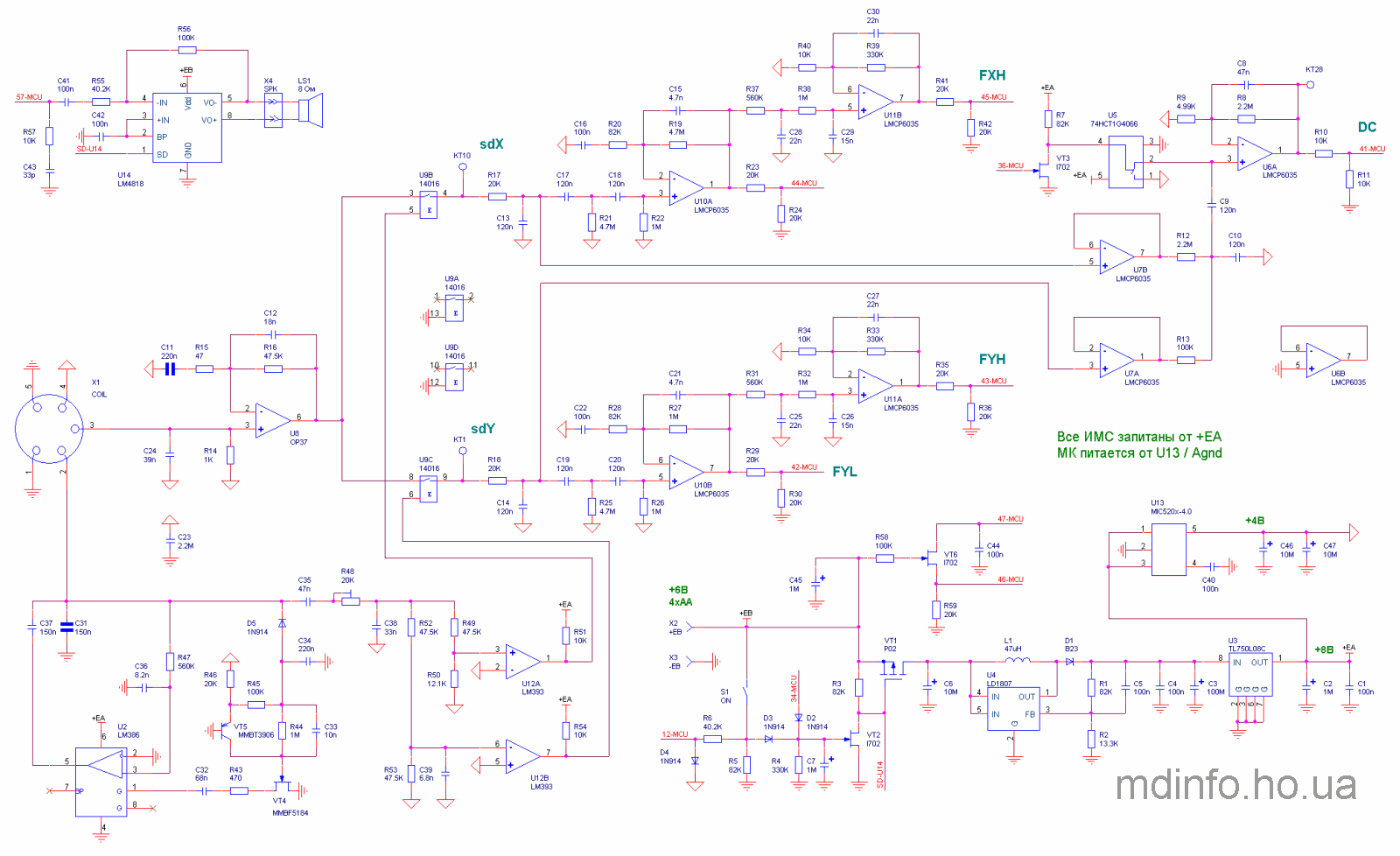

                      Can someone tell which principle the the Ace 250 operates under please. I just purchased a used one and am new at this. I notice that it has no adjustment for ground effects and assume that this is most likely due to it's design principles.

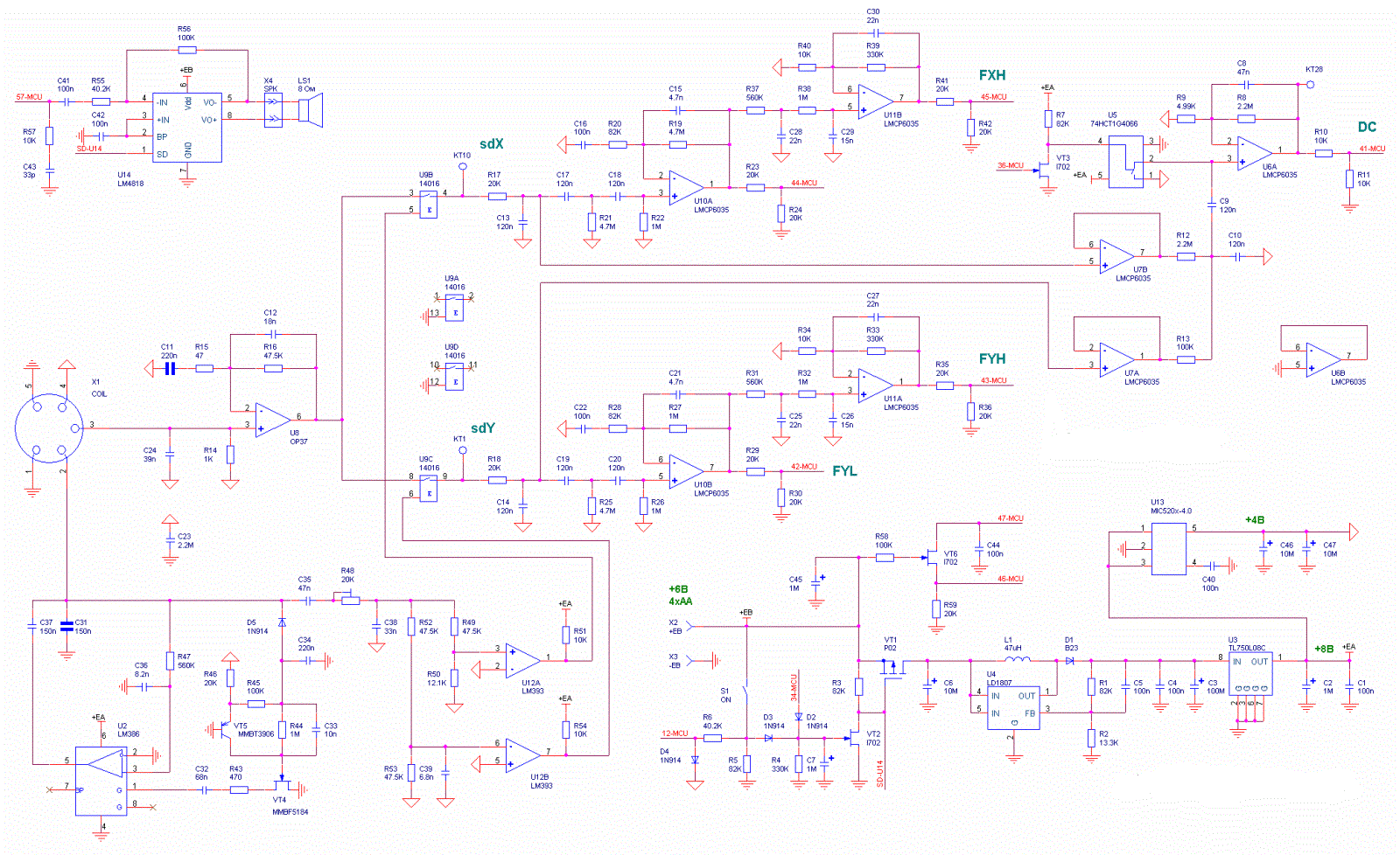

                        Well here's a schematic that is supposed to be ACE. Click image for larger version
                        Maybe R48 is the ground balance?
                        Many detectors have a preset ground balance that should work most anywhere...
                          In a micro you may combine s portion of disc signal to achieve a better GB, provided the disc channel does not saturate. If you allow saturation, a perfect trigonometry becomes impossible.
                            Say what?
                            Barry
                              Seek a schematic of Fisher 1265 and see how it handles discrimination. It happens in a baseband (1-10Hz) and that's what ACE see on its ACD inputs.
