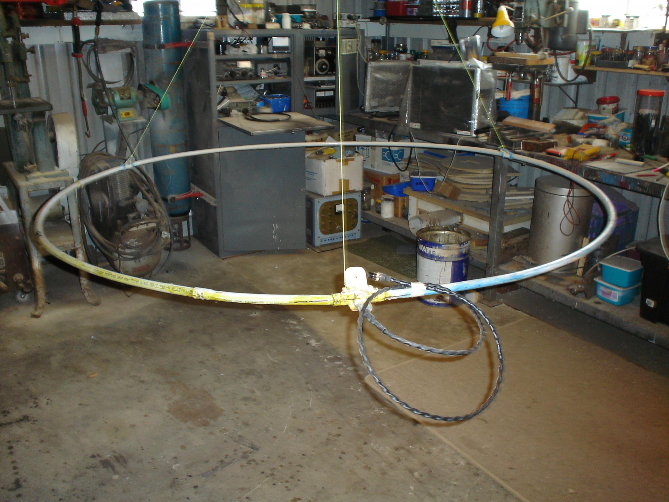

Name:	Ground loop 007.jpg
ID:	344451Click image for larger version

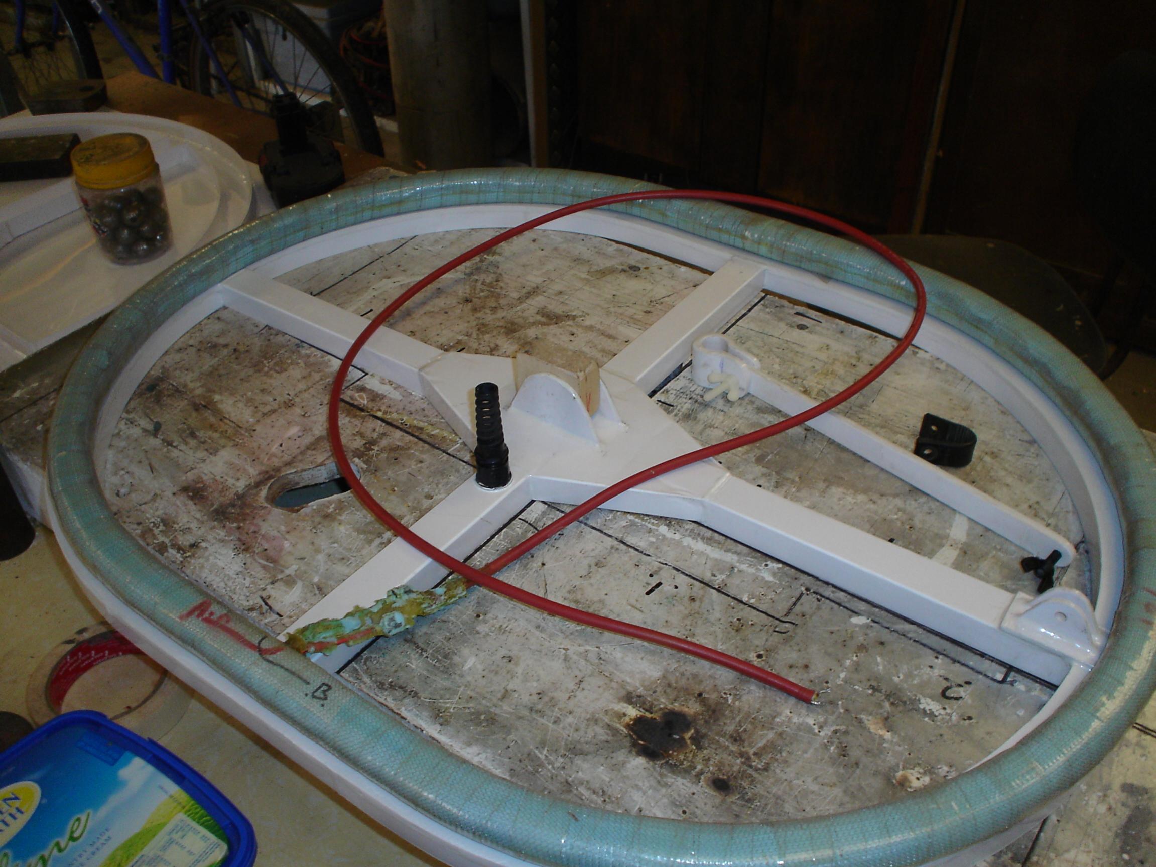

Name:	800 x 600 housing fabrication pictures 8.2.2015 010.jpg
                The 800 x 600 has a finished inductance of 312uh and the 1800mm ground loop has an inductance of 406uh it was designed this way as it has its own TX unit and battery driven in unison from the main detector is all I can say Pictures of both attached.
                Regards, Ian.
                  "is all I can say" is that because its a secret?
                  Do you need to have a separate TX unit? I don't want to do it that way.
                  I reckon if I up the wire count I can lower the Inductance to somewhere closer to 280mH. But will be costly ordering lots of Linz wire for experimentation (sure I can off load it on ebay for other coil makers).
                    Hi GP only the ground loop has the extra TX unit because it has advantages that way and that is the way we are doing it, upping the strand count will allow you to lower the inductance while keeping the resistance where you want it.
                    Regards, Ian.
