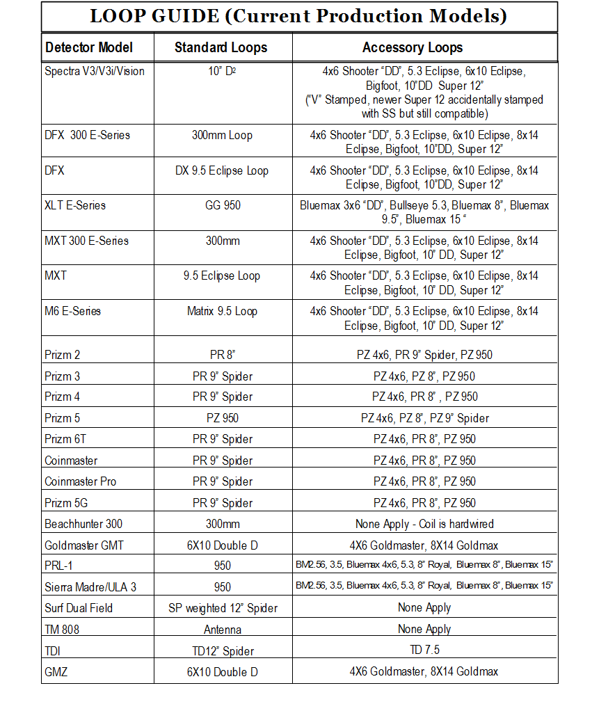

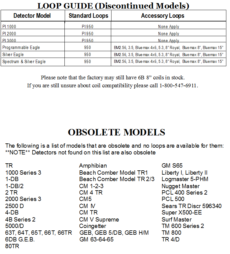

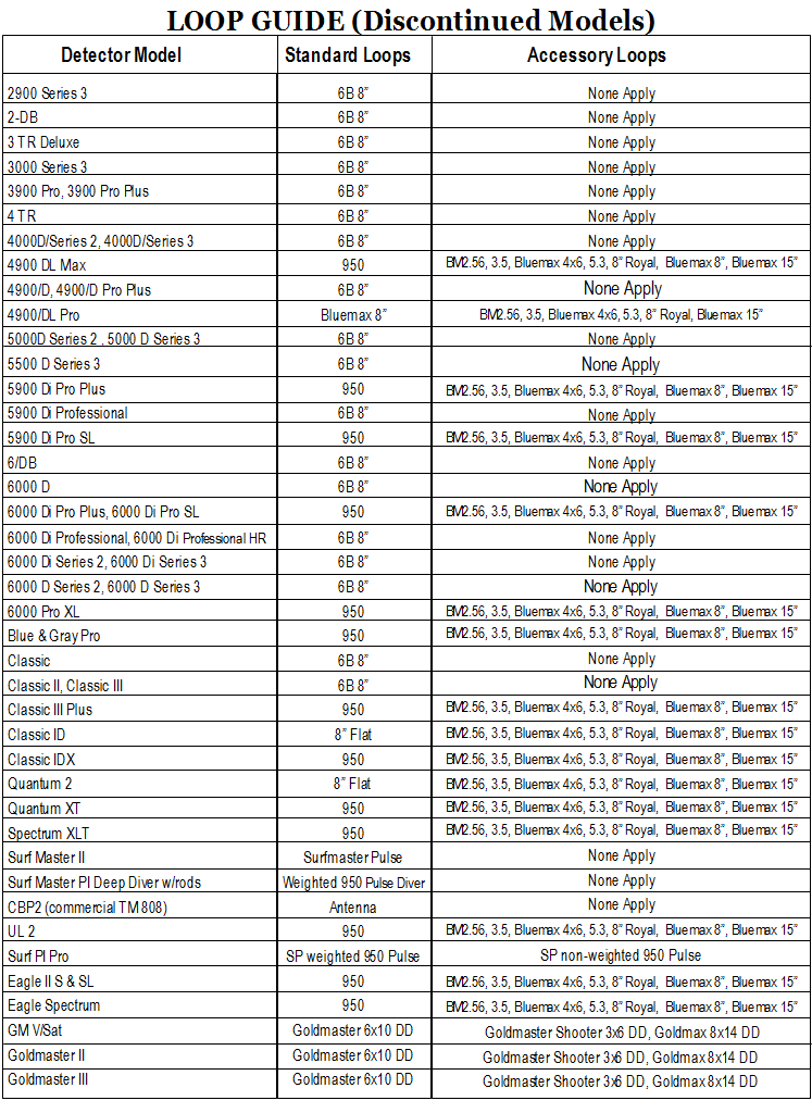

    I just came across 2 brand new 15" whites coils.
    The 6B will fit my Coinmaster 6000Di2, but the D5 will not.
    A quick search seems to show the D5 is to suit a 6000/D and 6/DB only.
    As I am planning to make quite a few kits, does anyone know if this coil may be of use? Is it worth keeping?
    If it is not compatible with anything I may construct, then I will move it on.
    Thanks.

      Thanks for that.
      The D5 coil doesn't get a mention.
      ITMD shows how a 4B is wound, but I have a search fail on the D5.

            Here is a copy from the Whites forum that I have quoted many time as not all Classic coil are the same.
            older Whites coils
            From Coinist Whites Tips page 2
            Go to any forum, chat group, etc., and you're bound
            to see discussions about using this coil or that coil on this
            or that detector.
            Well, just because a coil is round like your coil,
            or has the same connector like your coil, IT DOESN'T MEAN
            THEY'RE COMPATIBLE!
            Whites has used many different coil designs and
            windings over the years. While the housings and connector
            may be the same, the inside is totally different. This
            discussion will focus on designs used in the last 20 years
            because there are still tens of thousands of 20+ year old
            Whites detectors in use. The Internet has created many
            problems for detectorists. Most of the time common sense
            has taken a back seat to impulse buying, the thought
            of getting a "good deal".
            Look at the outside left ear of your search coil
            (where the bolt goes through it). You'll see a winding
            designation stamped into it, i.e. 6B, D5, G, 8B, etc.
            D4 and D5 coils were used on the 6000/D and 6/DB
            detectors ONLY! They cannot be used on any other units.
            The D4/D5 coils were available in 8" and 15" only.
            B4 and B5 coils were used on the 4/DB and 5000/D
            detectors only! They cannot be used on any other units.
            The B4/B5 coils were available in 8" and 15" only.
            6B coils were in use since the "series 2" thru
            "series 3", Pro units, the Classics, and at present on
            the Classic I SL and II SL. 6B coils were available in 4",
            8", 10", and 15".
            F coil was made only in a BM256 (Blue Max 10"). This loop
            is totally interchangeable with all 6B coils above. It was
            manufactured to give performance to units which use the 6B
            coil similar to the BM950 coil is use today.
            G, HI, 8B coils are known as the (Blue Max) BM350, BM600, BM5.3,
            BM800, BM7.8, Royal 800, BM950, BM1500. These coils are
            interchangeable. THESE COILS ARE NOT MADE TO BE USED ON UNITS
            WHICH NORMALLY TAKE THE 6B DESIGN! TRYING TO USE THESE COILS
            IN PLACE OF THE 6B COILS WILL HAVE VARYING RESULTS. Some units
            may or may not ground balance properly (even if re-adjusted),
            but disc settings will be off and target ID's will not be accurate!
              The D5 is the correct coil for his 6/DB
