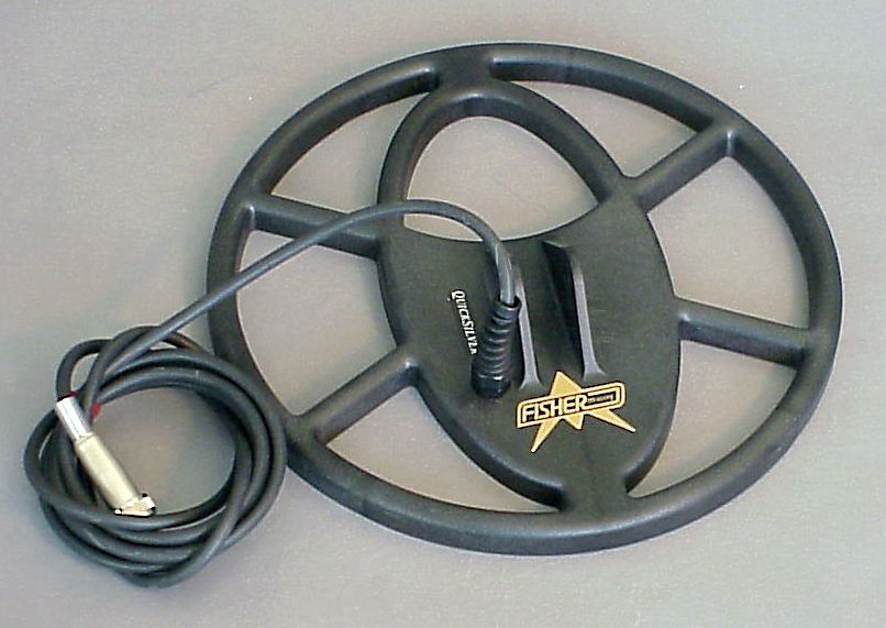

    Guessing the last coil made for this coil was the best 10.5" spider concentric.
    Anyone got the parameters capacitors and resistors used and how the shield is connected.
    Is the coil information here a genuine Fisher coil?

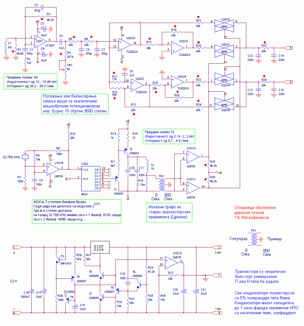

            Fisher 1266
            Rx 10-10,4mH / 38,2-39,3 Ohm
            Tx 2,14-2,2mH / 4,7-4,9 Ohm
            CZ6 10" 2.44mH 4.80 --- --- 10.97mH 39.1
            so TX has to be 2,2-2,4mH, RX has to be 10-11mH. TX side has nothing. grasp too there are capacitor and resistor 20-24Ohm on RX side...
              an 8-inch coil inductance Fisher 1266 TX - 2,46 mH (. Reactive resistance = 75 ohm, active 4 th), 81 turn 0.47 -0.51 wire diameter.
              capacitor in contour means 440nF.

                      My faulty eBay 1265X control box has arrived. Board part number is the same as 1266X I have seen posted so should be able to convert to 1266 specification.
                      Board doesn't look bad no spillage or burnt components.
                      Front panel connector was not seated correctly. Re-seated
                      Tried some power. Signs of life. Battery test works. Chirps away but shuts up if I short across the RX pins
                      Onto building a coil next week.
                      See if I got this right for one of these
Name:	fisher 1266 coil.jpg
                      TX 2.2 millihenry 4.9 ohms
                      RX 10.4 millihenry 39.3 ohms
                      No capacitors or resistors in the coil ?
                      How is the shield connected ?
