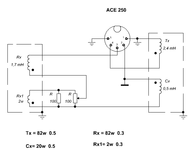

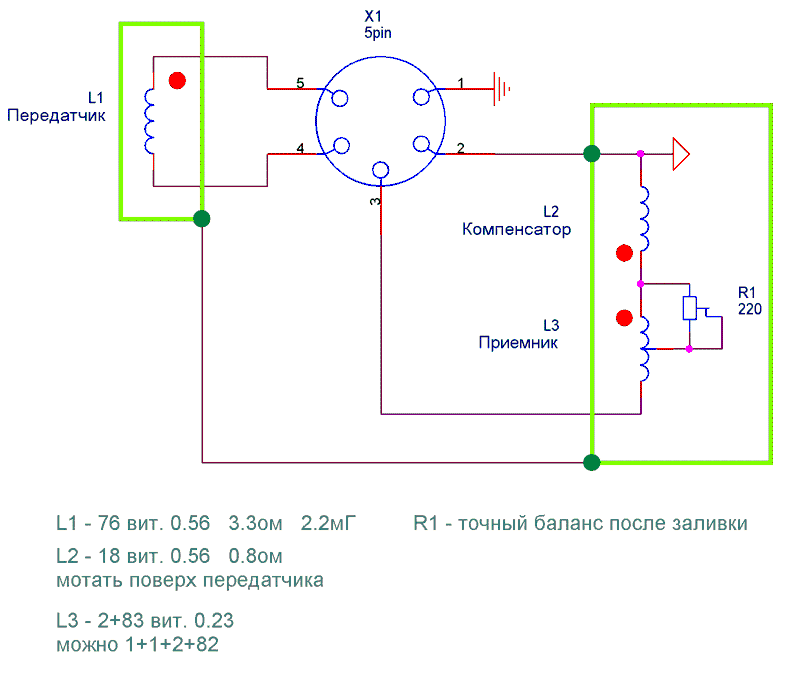

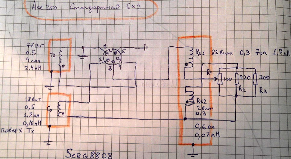

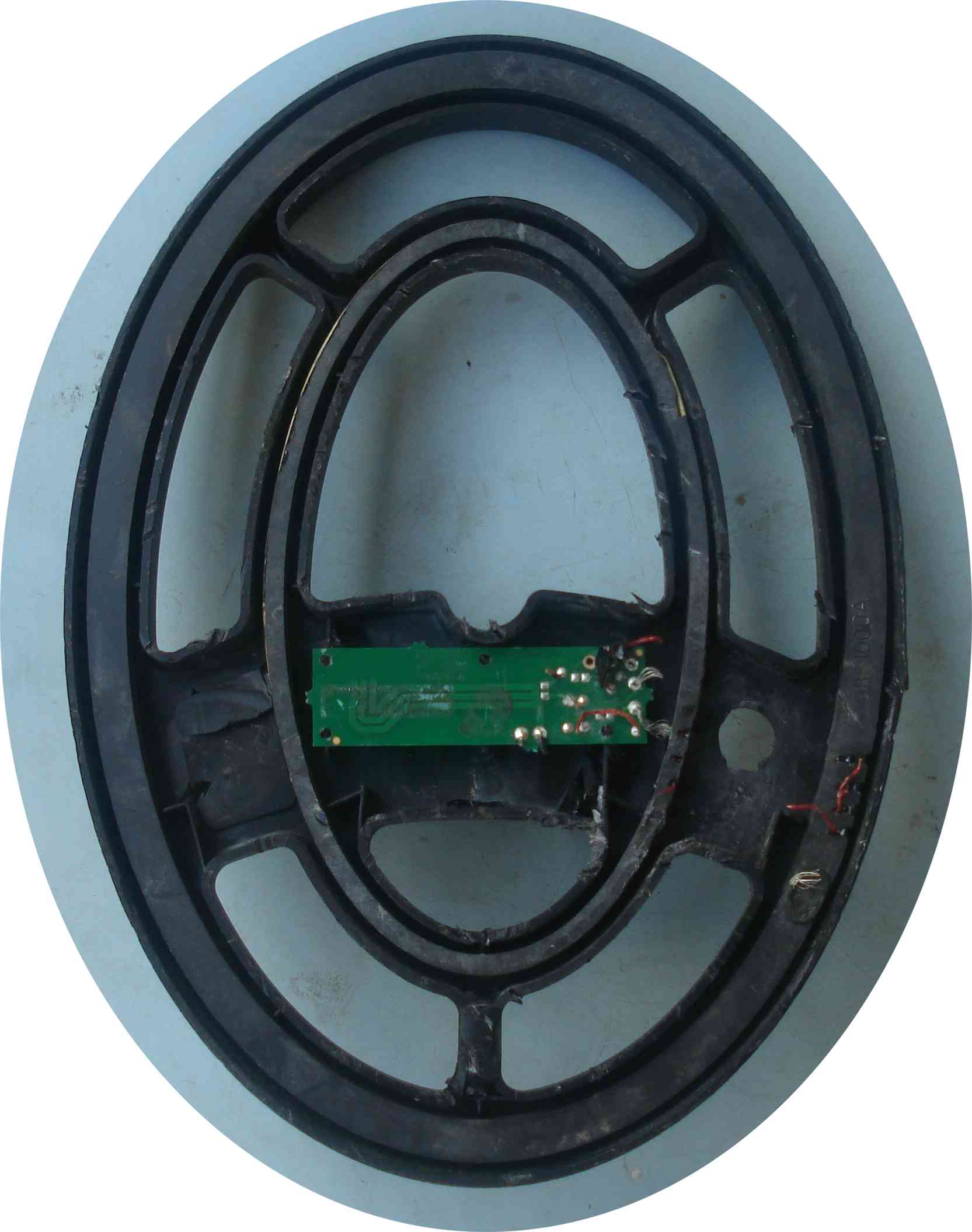

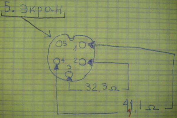

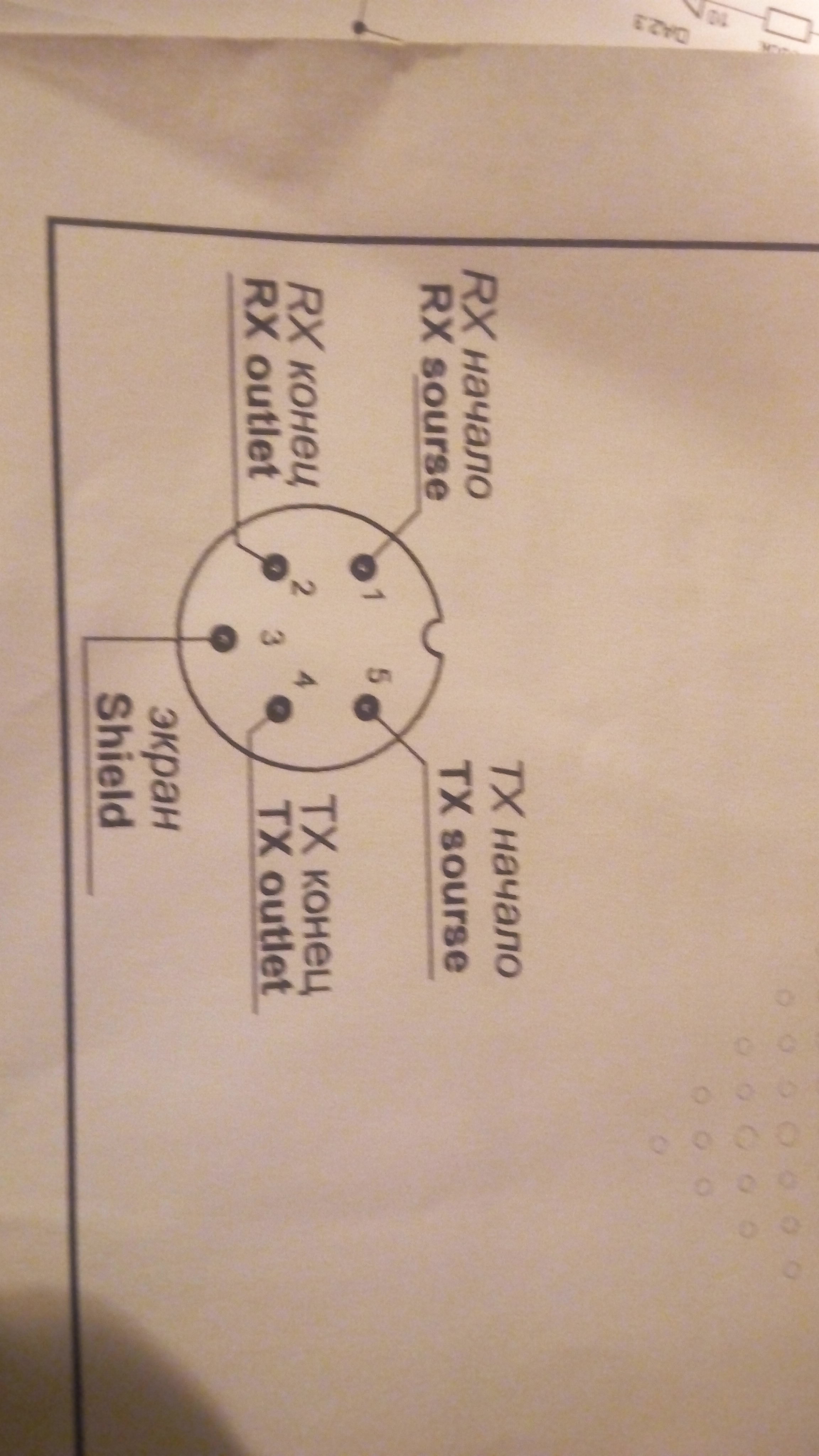

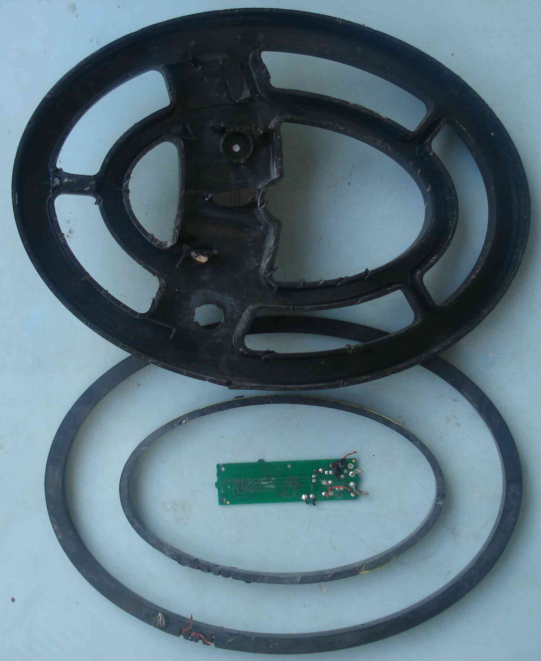

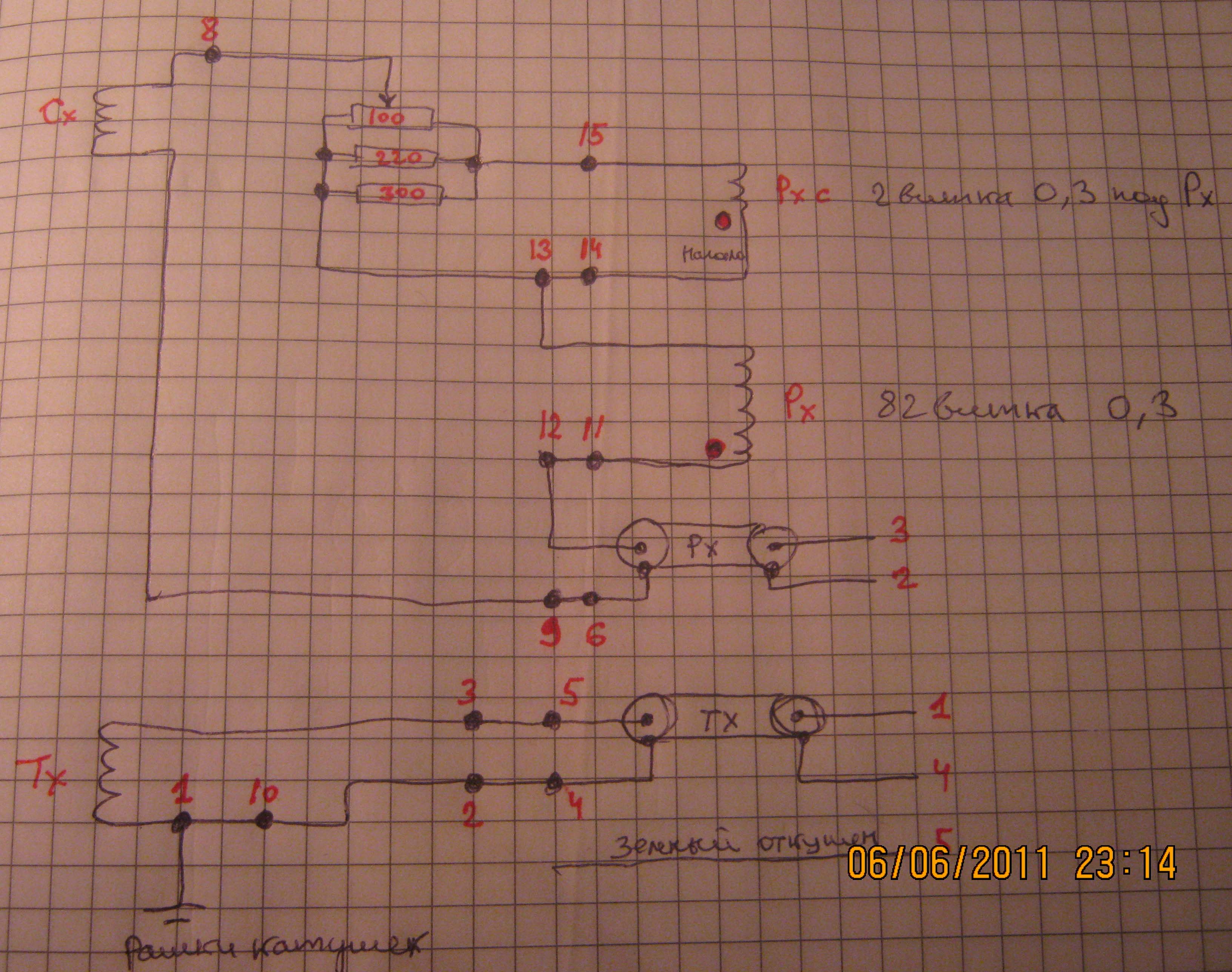

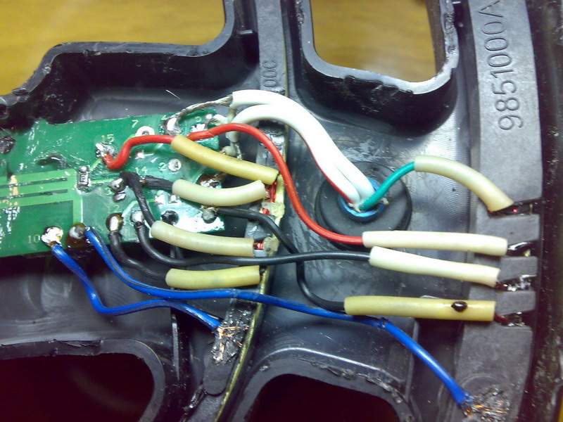

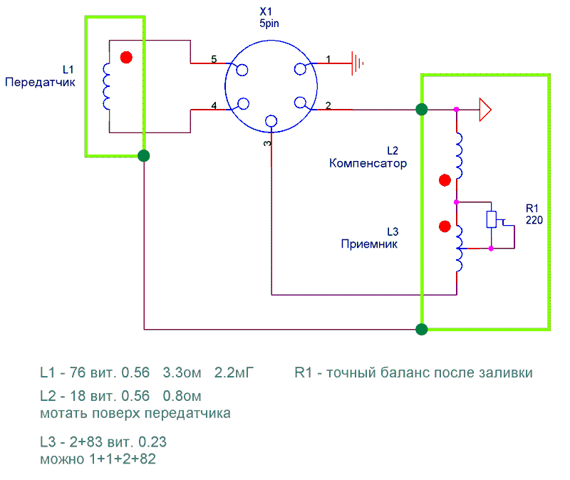

    Hi all. Can anyone tell me what the coil connector pin layout is on a garrett ace 250 . Which pins are tx and rx. I need an induction balanced coil with preferably pin layout as attached diagram

      Thank you for that. I have made plenty of pulse induction coils but induction balanced is another kettle of fish. I would like to make one some time but for trailing the Fortune M an off the shelf coil would be better.

        Lots of Time Yes, Hard NO. What detector do you need a coil for ?
          Its for a Fortune M. It has got good discrimination, fast recovery and very sensitive in gold mode.

                So this detector uses a coil of 6.5Khz ? Maybe you can find another coil runing 6.5 or 6.6Khz that could work for you. Just need connection details ?

                    Tell me please, the exact marking of the antenna connector in the ACE block, I can not find it.
