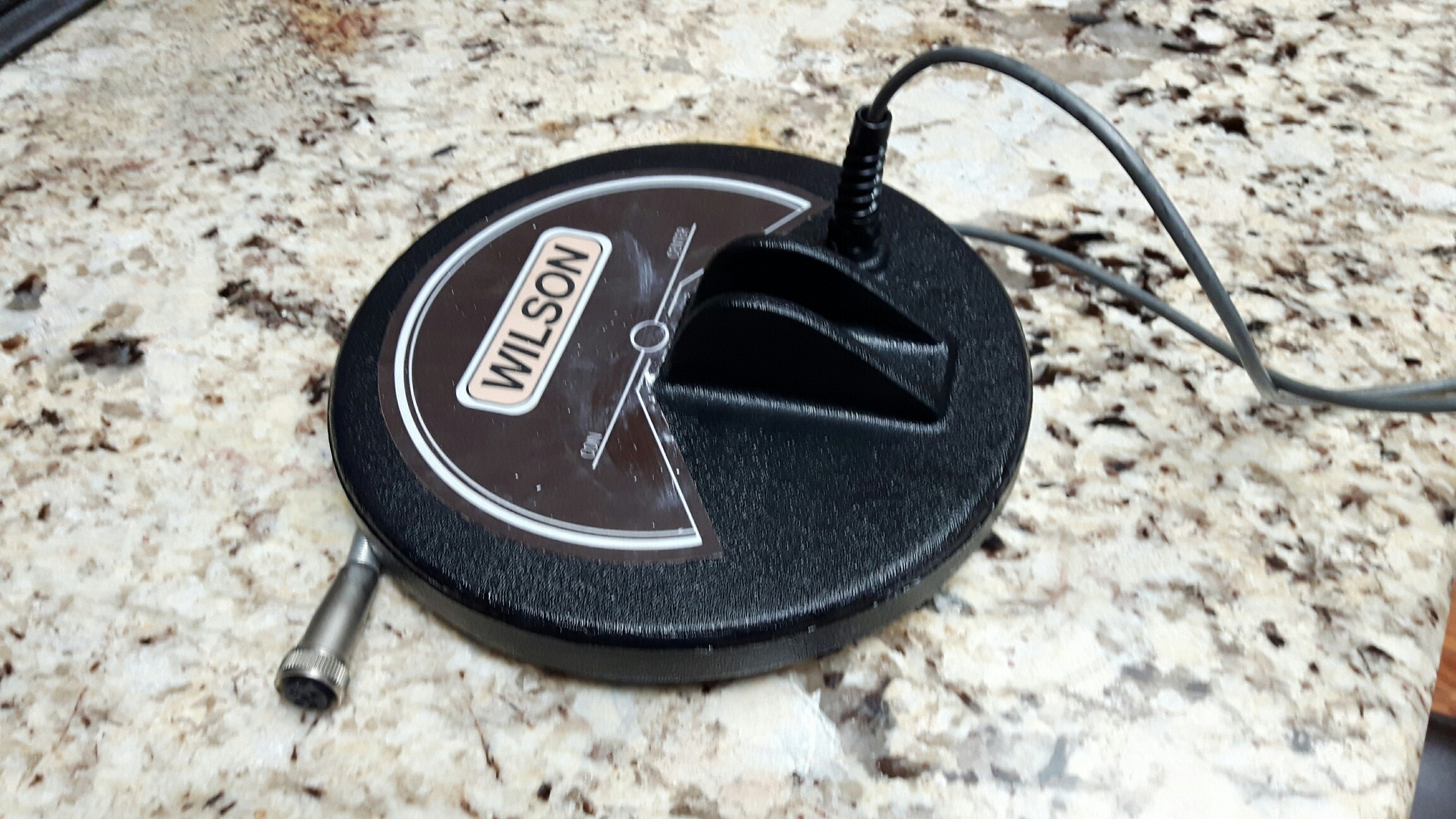

    Someone gave me a coil for my old Wilson to replace the defective one I had. Now it is giving problems. Every time the bottom of the coil is slightly depressed the machine sounds off. If I pinch the coil between my fingers it does the same thing.
    Any ideas how to fix it?

      But it false when touching bottom of coil not cable. I have had coil where you touch cable near coil and it false, but not this one.

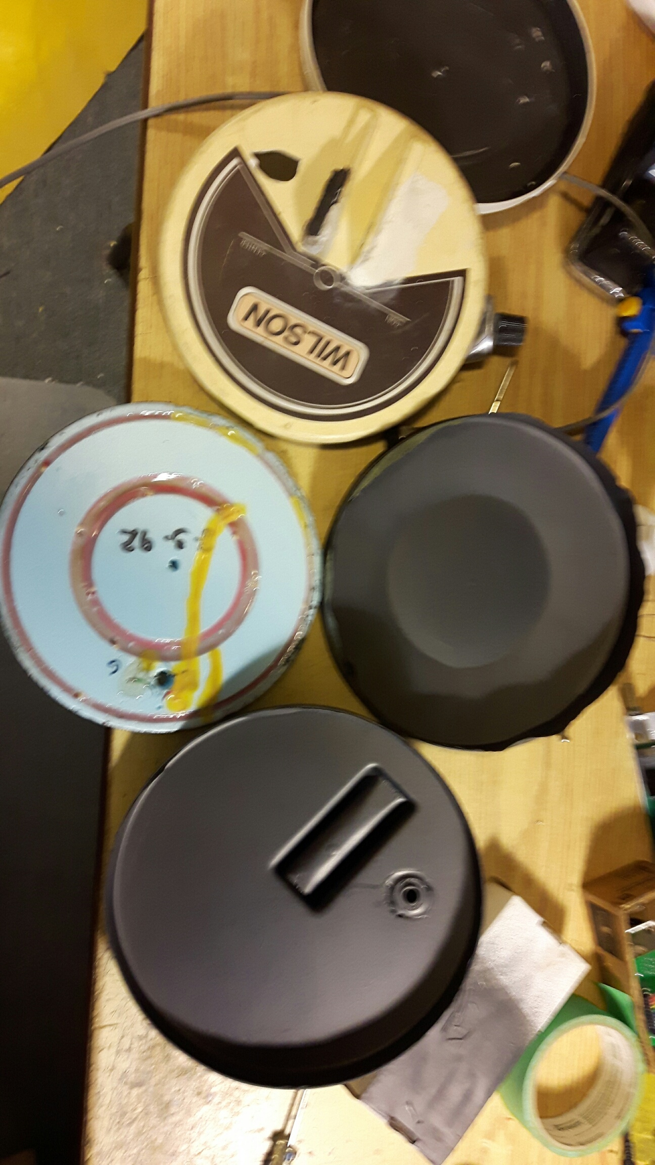

        first earlier coil was done without solid whole surface graphite layer at bottom. you touch and paper with graphite
        moving. that gives false.
        you have to open coil and run it to modern state - do graphite layer and do good contact to the shield
        via naked wire to the ground pin.
          Shielding issues within. Open it up and Correct the problem.
            Where does someone get the graphite paint to paint the inside of the coil again?
              http://www.instructables.com/id/Conductive-Paint/
                Followed the advice from many people on different forums and rebuilt the coil on my Wilson! The thing of beauty now!!!

                  Yep, that's how to do it. How many people would have gave up and chucked it out ?

                      I used this stuff called Blaster Graphite Dry Lubricant I bought from Home Depot. I sprayed on several coats until I got the same resistance reading an inch apart on the test probes as I got on the original coil.
