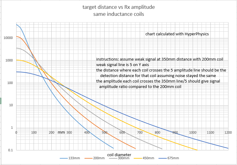

    Put both charts(fixed inductance) on same page. Both give the same results, detection distance vs coil size. Both assume everything remains the same but coil radius(diameter) and noise level doesn't change. Don't need math to chart the left chart. Been trying to understand the best way to use the left chart. With the Excel chart I can read change in signal strength or detection distance when changing coil size. Haven't figured how to read change in signal strength with the left chart.

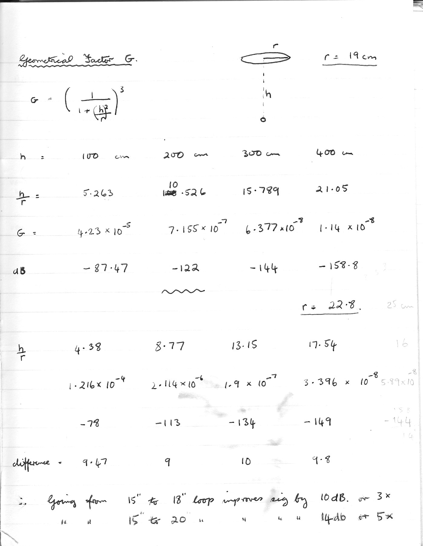

    Here is a page from my 1978 notebook. It's late here now, so I will do an explanation tomorrow, although I expect Skippy can figure it out.
    Eric.

    • I'm not entirely sure what info Green is wanting, it appears like he wants Target Signal strength plotted against coil radius, for a family of 'target sizes' , that match the 'target sizes' used on the semi-circle chart. So they would look vaguely like a series of inverted parabolas, peaking at the 'max depth' point. Such a chart could be plotted with the same 'coil radius' scale, so the two would line up. Would that be useful?

        A chart like I think I want. Charted with a coil diameter increase of 1.5 times starting with 133mm coil. 133, 200, 300, 450 and 675mm coils all same inductance. I like the Excel chart because I can read signal change or distance change with coil diameter change. Can estimate needed increase in Tx peak current to double detection distance or needed increase in Tx peak current to increase detection distance by(maybe 50mm). The other chart is easy to make but I have a harder time reading it, maybe with more practice. Still don't know how to make it so I could read change in signal strength and change in detection distance.
        Maybe just me but the first thing I have to do is convert radius to diameter when I think about it. Maybe radius is better for others.
          Geometrically, the target is on the centre line to give maximum signal, so that is why radius is used. Detectorists normally talk in terms of coil diameter though, so then you have to remember to halve it. In my old graph that Skippy posted a while back, I used 'coil diameter' on the x axis and find it more difficult to read and remembering to halve it.
          I have only ever used that chart, or the associated calculations, a few times when designing for specific targets. There was a case when a detectorist found a scattered hoard of 13th century silver coins on the beach. Because coins go deep in beach sand and a few had been found, we could test one coin on a certain size coil and then work out whether a larger coil would be more effective. For general searching for a wide spectrum of object sizes and conductivities, my view is that the graph has limited use.
          The final detection range is also modified by several variables i.e. number of turns (inductance), coil current, sample delay, sample width, and filter characteristics, all of which can be optimised for any particular single object.
          Eric.

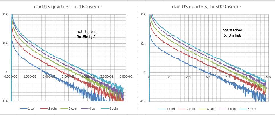

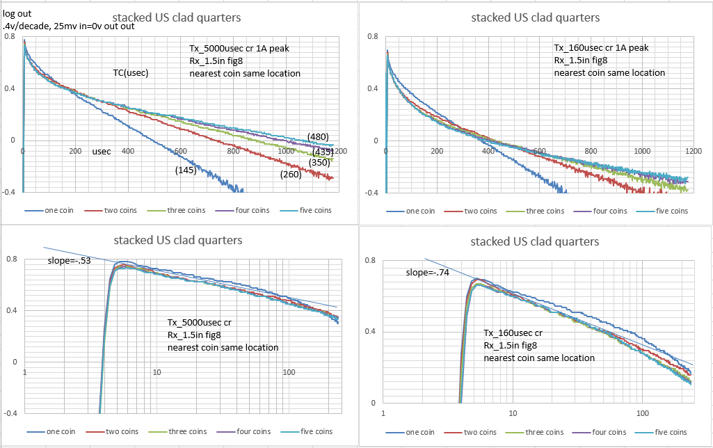

                    • Did a chart with stacked quarters awhile back. Another with quarters side be side, not stacked. Three small divisions doubles signal. 2coins twice signal 1coin. 4coins twice signal 2coins. Number of coins doesn't effect decay TC.

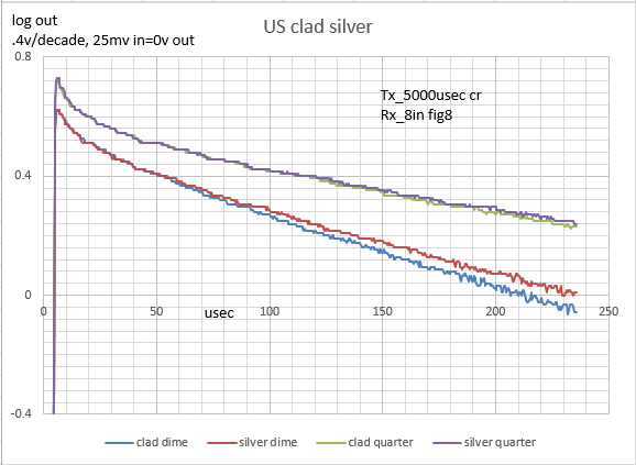

                      • Charted clad and silver dimes and quarters. Quarters chart closer than dimes. Wondering if a VLF detector shows a greater difference with clad and silver dimes. Quarters almost the same.
                        • I guess this question is aimed at me. And the answer is yes, clad dimes read different to 90% silver ones. Disclaimer: I only have ONE silver dime, a lightly circulated 'Mercury' one. My guess is the 10c cladding thickness is the same as on the 25c coin, hence it is proportionally more significant compared to what it is on the 25c. Ie. less good-conductor copper core, more poor conductor CuNi skin.
                          I have measurements as:
                          Mercury 10c : fc = 2.5 kHz; tc = 64 usec
                          Clad 10c : fc = 2.75 kHz; tc = 58 usec
                          As this is a thin coin, my 13kHz VLF figures may match your PI ones better, due to skin depth issues
                          • Originally posted by Skippy View Post
                            Thanks, I checked the slope on the chart and got 76usec and 85usec for the dimes. Have you checked a clad and silver quarter to see I they test closer?
                            • At least we agree they are different, by about 10%, even if, as usual, the actual figures don't match.
                              And you should be able to find previous discussion about the 25c coin somewhere - they are pretty much identical to a VLF, though again, my tc figures didn't match your PI ones..
                                I did find your reply, thanks
