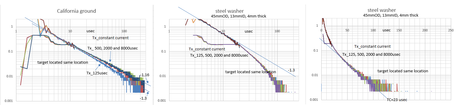

                • Thanks. You captured them as linear in log-log scale, which requires fitting to achieve.
                    I recorded them linear and can chart X or Y linear or log. If you have a chart you would like to change I could chart it with different scales.
                    • I have an analogue scope, so no fingers - no chocolate.
                      But fitting a simulation is just a few clicks.

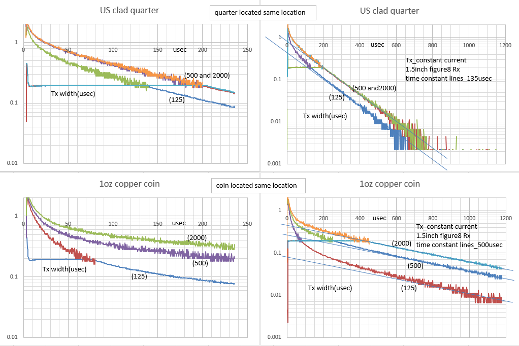

                      • Charted some California ground and a steel washer at different Tx widths to compare with the US quarter and 1oz copper coin. The 125usec Tx curve is steeper than the longer Tx widths with the California ground. Tx width didn't effect the curves for the washer, 125usec is 5 times longer than the 23usec TC line on the chart. Looks like increasing Tx width over 4 times the target TC doesn't effect the Rx signal, stated more than a few times in other threads. The copper coin chart line wasn't straight on the linear log chart until after 300usec with Tx width 2000usec(4 times the TC). Looks like about 600usec for Tx width 500usec(coin TC) and 800usec for Tx width 125usec(1/4 coin TC). Looks like Tx width should be at least 4 times the target TC to get a good TC number. Maybe nothing new, but something I haven't always done for long TC targets. Charted the washer log-log because that is what I had done for the ferrous targets I referenced for Davor reply#127. The ferrous charts I referenced were straighter on the log-log chart than the washer I did today.

                          • Perhaps. But there is a snag. In log-log scale you get a linear response only if you fit the beginning of a signal (x axis) properly.
