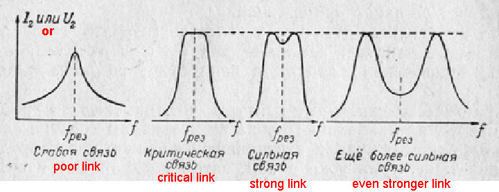

                      first pic in the article
                        So the goal to reach the best sensitivity is to find a frequency other than Tx were the link is strong, at it can have a pretty high phase shift ralitive to Tx signal right?
