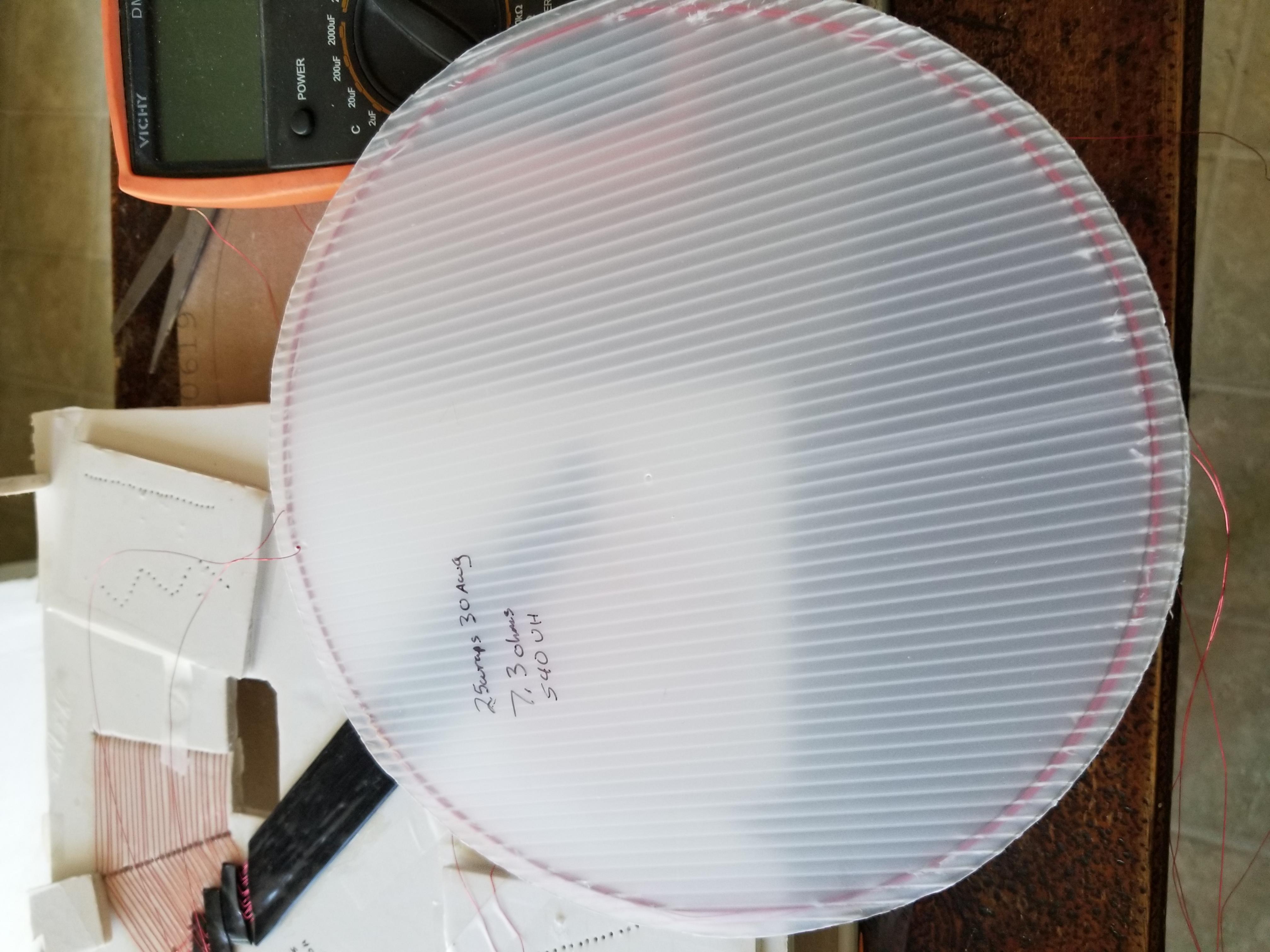

          I wound a bundle with the same diameter loop as the figure 8 spiral, works out to a 9 inch coil.
          Calculated inductance was 480uh.
          The bundle coil came out 540 uh at 7.3 ohms resistance.
          The figure 8 came out 199uh at 7.2 ohms.
          I was expecting some differance but thats a huge amount.
          Im thinking way too much spacing for the 8 coil not enough for the bundle.
          I still have to hook them up get srf to figure out capacitance.
          Now to figure out proper spacing before building such a busy coil again.

                I just did the srf and capacitance of the spaced eight and bundle and for the same amount of wire the capacitance differance is huge.
                Coil 1
                9 Id round "
                25 wraps 30 awg
                7.3 ohm
                540 uh
                588.2 khz Srf
                135.67pf with 3 foot leads
                #2
                figure eight plane with a wrap that keeps the loop size the same diameter as a 9" loop
                25 wraps 30 awg
                7.2 ohms
                199uh
                1.786Mhz
                35 .67pf with 3 foot leads
                You can see the huge differance in the same wire though i think my eight has too much spacing for this guage wire by the low inductance.
                teflon mega tape makes a nice wrap if you twist it, its 40 times thicker than regular plumbers tape Ive even used it to wrap ESC' and parts to quad copters for testing as well as coil wrap.
                Best of luck with the next wind Ive had a few redoos my self lately .

                    I think you will have better luck with the magnet wire especially if you added a spacing between wraps.
                    Why do you think adding space between the wraps would make it better? I think spacing reduces inductance and probably increases capacitance especially if enough turns are added for the same inductance?
                    Are your 3 foot leads twisted? I get about 1pf/inch when I use AWG24 twisted pair for lead. I wound a bundle coil awhile back with AWG 28magnet wire, inductance very close to calculated using the coil calculator. Calculated inductance winding the same coil with Teflon coated wire calulates about the same inductance I get winding the spiral coil using magnet wire with no spacing.
                    • #70
                      "Why do you think adding space between the wraps would make it better? I think spacing reduces inductance and probably increases capacitance especially if enough turns are added for the same inductance?"
                      I may be totally wrong, what you say holds true in what I read in transformer windings.
                      But here is kinda where im coming from.
                      Many coil builders here say to use the thickest teflon 600v insulation on coils like the 3dss types. The 3d coil has very large spacing between layers and where the wires come together cross at close to 90 degrees all of this in a effort to reduce capacitance speed up the coil.
                      But thats not it it depends on coatind dialectric as well.
                      Magnet wire has a very thin coating, yes it has a good dialectric value but that actually helps its capacitive capability.
                      you have two coating thickness between the wires. that is a stable capacitance between wires.
                      Now you start increasing spacing capacitance starts rising to a point where you loose proximity effect or field strength I think.
                      Your right also as the spacing increases you loose field strength or inductance.
                      So here it is I think there is a point where the spacing reduces capacitance while reducing inductance as well but you can use a wire mass that say would carry 500uh inductance take it to 300uh while reducing capacitance. would this be of real benefit I guess I have to find out. Maybe its just better to use less wire.
                      My two recent coils I think are a good example I think of both extremes.
                      Your bundle came out close to calculated value. You probably built a real bundle coil, the one I built was I guess not really a bundle its wound on a spool and i wound it pretty tight. That may have increased capacitance and inductance
                      There is almost the exact same amount of wire between the two coils and there is over a 100pf more capacitance just using the magnet wire coating as spacing.
                      Ok so I have to go the other way now and take the spool down to 300 uh and see what the trade off is between inductance and capacitance. or add spacing every five wraps.
                      Ive said Im trying to learn and everytime I think I got something something contradicts this I think that comes down to the old saying there is always a trade off.
                      I understand the 500 uh coil is going to have a stronger field strength but the capacitance slows it down?
                      Plus I have yet to hook either of these coils up I dont really expect good performance out of 200uh I may add another coil to that coil. try and save it.
                      The leads were not twisted on these coils when I tested them should I retest that way?
                      Thanks for asking me why beacuse Im still trying to figure it all out.
                      Please feel free to continue to correct me its appreciated.
                      More people in this world need to ask "why?" and offer constructive critism and it needs to be taken constructively.

                              something i thought about was when using calculators for this type of coil, the uh always seemed low compared to what was expected for a given number of windings.
                              and i think there is actually more than 30, if you count them on one side its 30 but does the surface area of the 30 windings on the other side of the coil matter?.
                              is it 30 windings or more due to the windings on the other side of the coil form?.
                              Decimal point wrong place, frequency or capacitance?
                              • #75
                                sorry green, 30 turns, 590uh, 3.5nf and srf of 110693.162 hz.
                                sorry about that, its not quite what a calculator says it should be(110754.17429501114), but in the ballpark.
